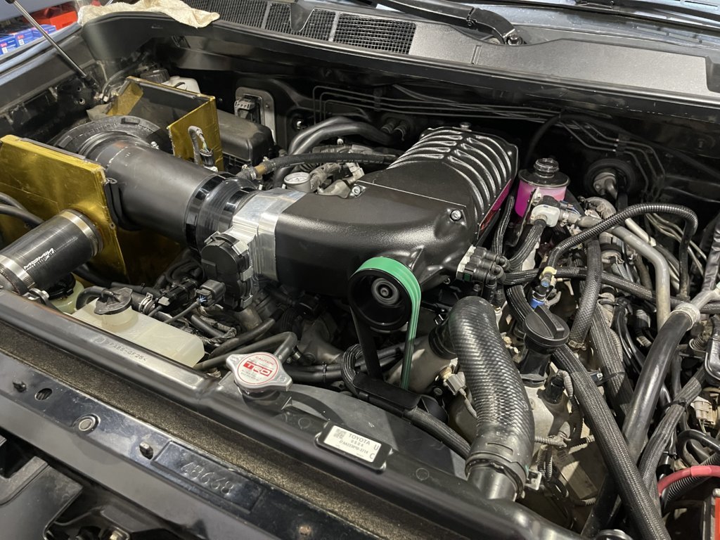

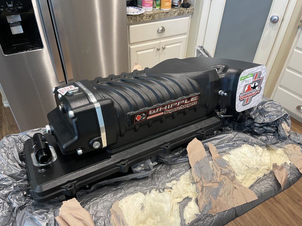

    Guess she arrived early

    So what’s the deal with the old one then? Was it a bad batch of superchargers that went out? And did it cost you anything? Pretty sweet if that’s a whole new blower at minimal cost.

    Not sure if it was an off run of them. But said there was an alignment issue of the inlet and housing may have caused premature failure of the couplers. Full replacement zero cost to me other than me shipping back to them.

    And we’re back.

    Looking nice under there!:headbang:

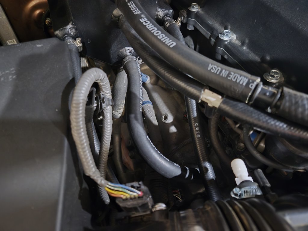

    Been slammed and on travel but finally got the truck sorted....
    MuddaEffing Catch Can!! Who ever called out PCV was right. Tightened the fitting good2go now. Still get a slight AFR and Boost oscillation at idle but I suspect that is due to the rearward position of the O2 changing the timing of the feedback loop.
    Thanks to all shouting out troubleshooting suggestions. I don't care what the Ford guys say about y'all, you are the finest Tundra loving wrench turners one could ask for.
    Edit: Tip always do the throttle relearn after disconnecting the batt to reset the ECU. Even though I had fixed the issue it persisted until I did the relearn.

    So what is the verdict on this thing or is the jury still out? Not that I am looking to buy just curious.
    What is the theory of operation? I see the two extra intputs are using engine coolant to keep the temps up. Are the other two inputs for Crank and PCV with a return line? Thanks.

    Yes sir, theory is the coolent running through the can heats the oil mix and vaporizes the fuel in the milkshake, I believe. The kit had no instructions and was missing parts imo. Probably wrong but I T'ed the 2 valve cover hoses to the top of the can. Middle hose went to the pcv value on the motor. Then I took the lowest hose to the intake for vacuum. Sides are the coolent lines to the throttle body. Like I said I winged it and even ran out of loose nipples and used a plumbers brass 90 at the intake lol. All had until I get some actual nipple there:notsure:
    PS. Used their website pics to guess the best I could until I can get confirmation from them.

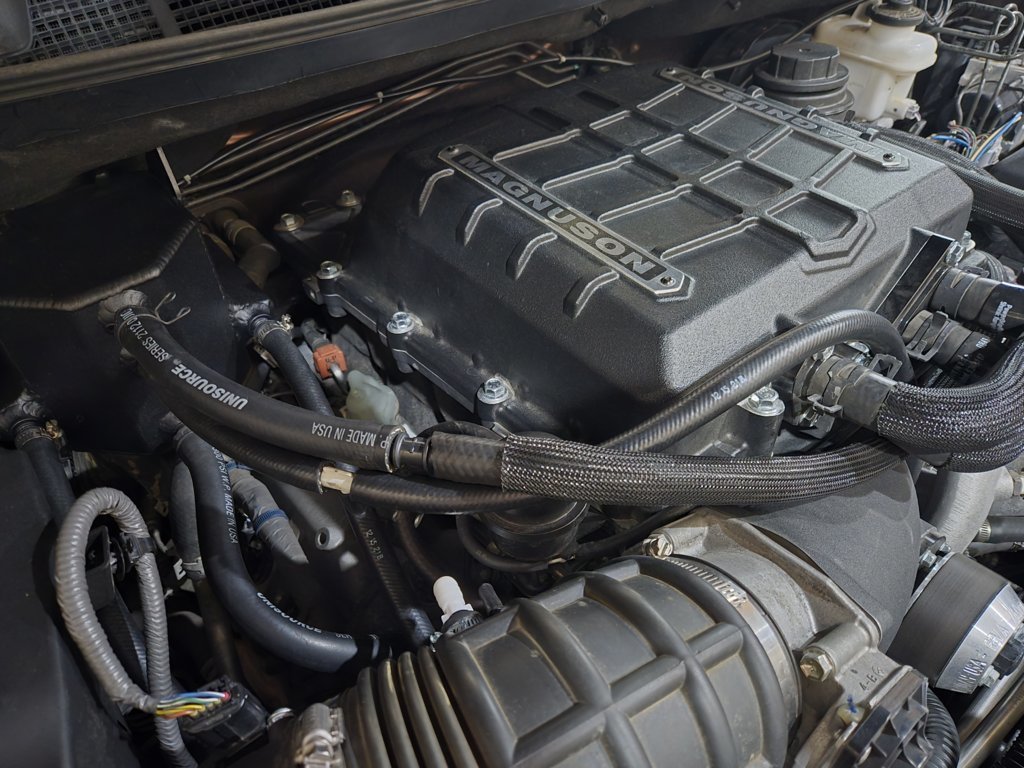

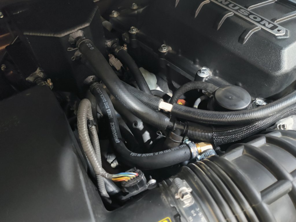

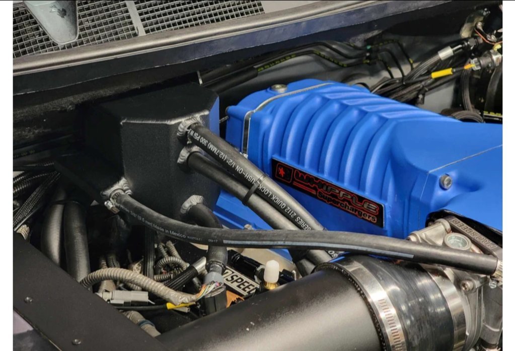

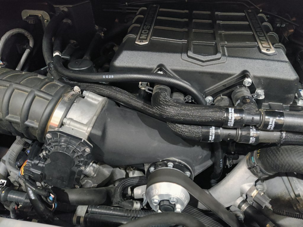

    Okay update on the CORRECT hose routing on this V2 for anyone curious. So I had the intake tied through to the can, that's wrong. I was losing substantial boost psi that way. Its Passenger side valve cover to bottom front, driver side to top front. Then middle front to PCV. Coolant lines are right, one from thermostat to can, can to TB. Cap supercharger nipple. This completely vta's under the truck, nothing going through the intake.

    makes me just want to get another cheapie CC and run the valve cover vents to it then to the intake. i already jave the coolant bypassed
