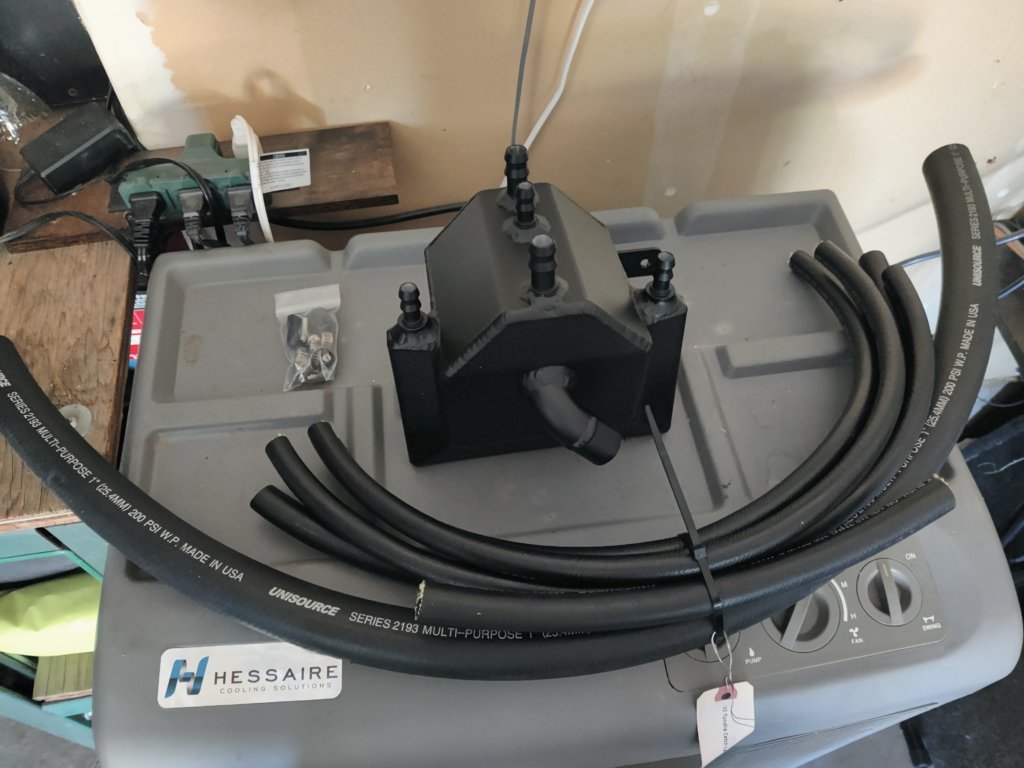

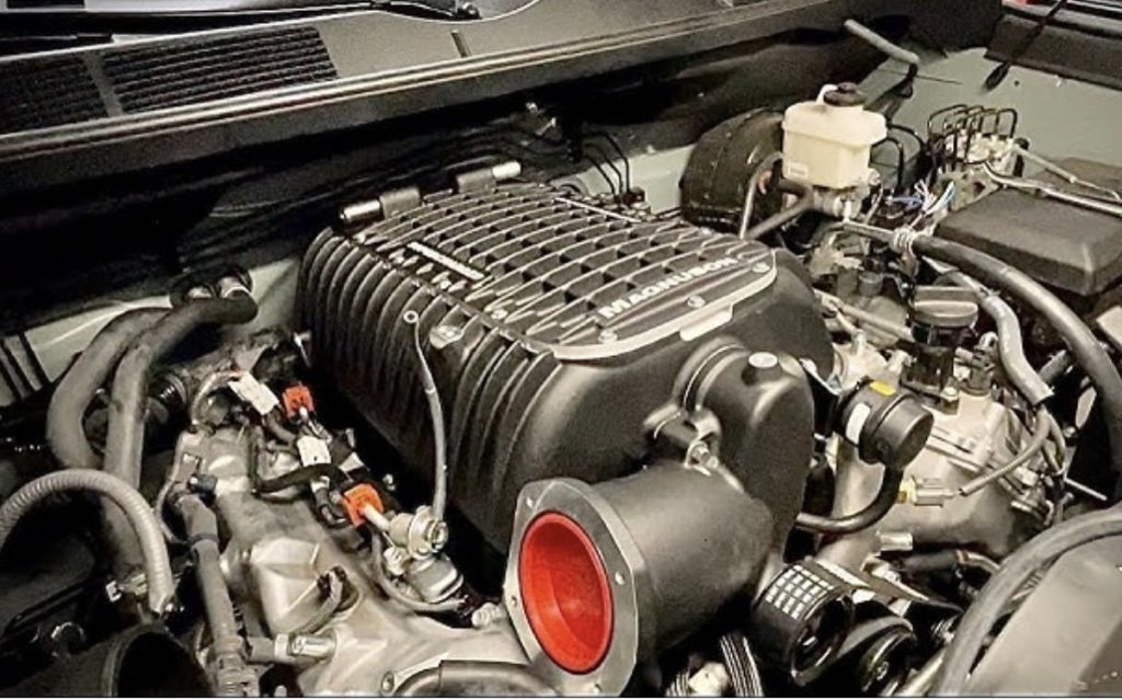

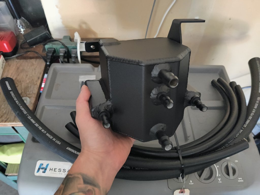

    Well after a few months finally received the V2 prospeed CC. Heres what's shipped. No instructions, guess I'll have to wing it off their website pictures

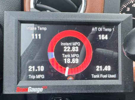

    >>>for all those folks that think S/C's wreck your mileage
    this ~400 miles 21.49 gallons (i filled up & it was 21.45)
    18.69 avg. mostly hwy
    the 21.1 trip avg is 90 mile trip Conroe to South Houston - all hwy
    not bad. I usually do 17mpg. we had a frigid 80degree cold front come thru.
    trans temp (pan) is avg for 80deg ambient.
    intake temp is always 31degree delta.
    max on the AEM boost gauge(this tank) was 4.6lbs.

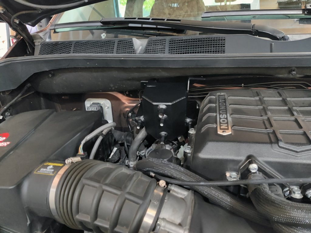

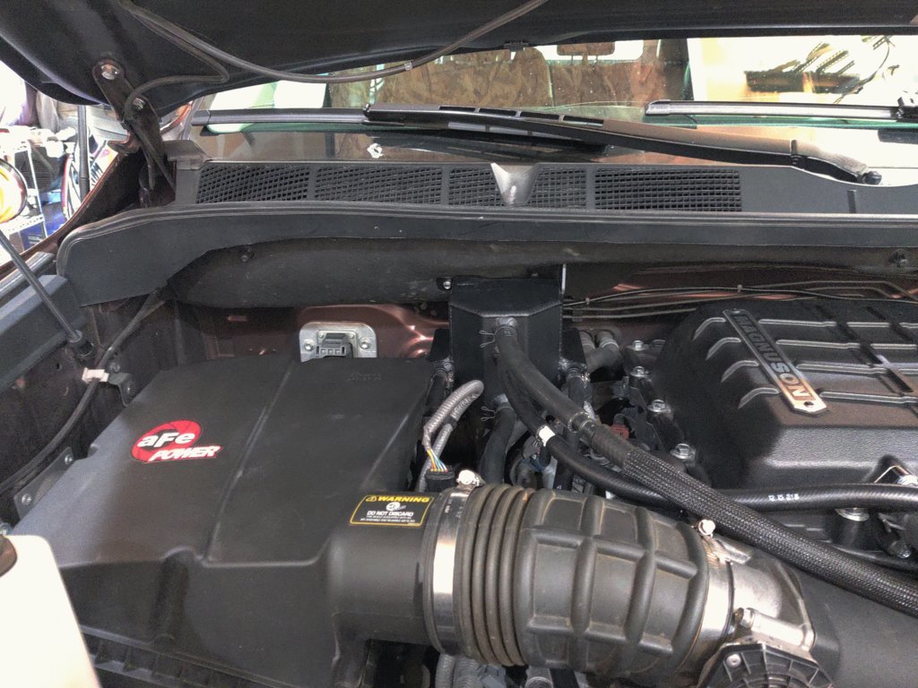

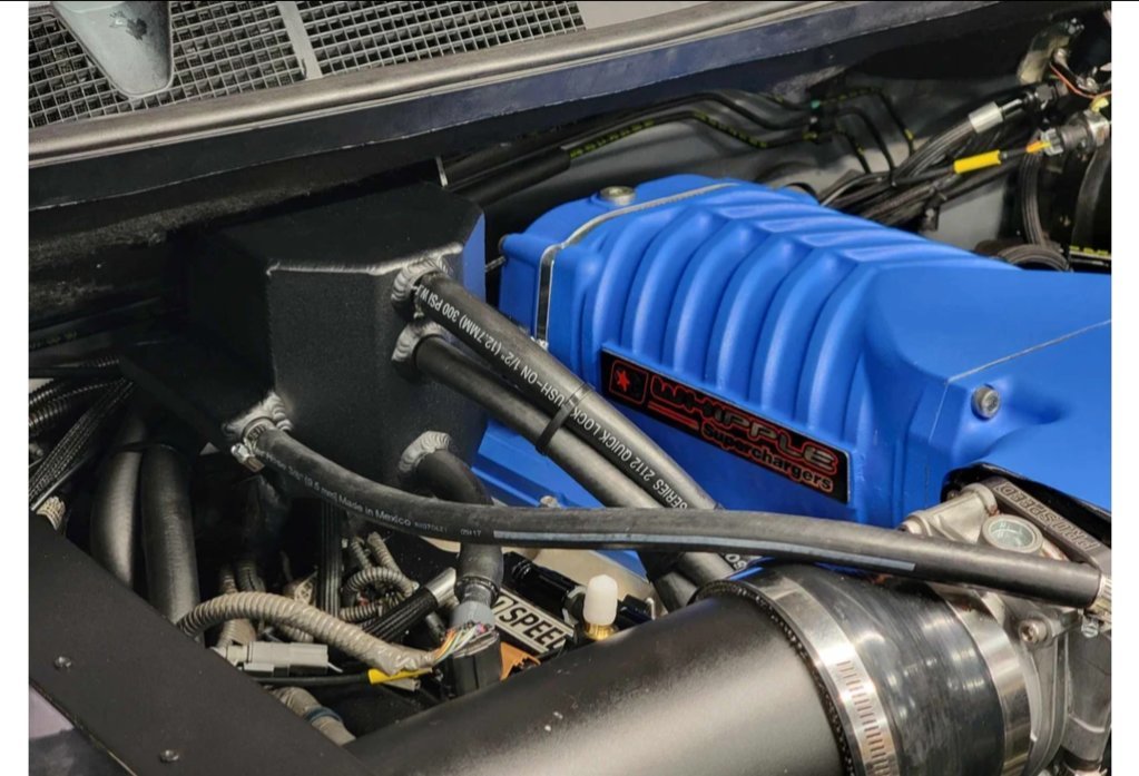

    Well looks like this V2 no worky with mounting points if you have a 2650. It needs to be a few inches right to line up with the left mount point. The right mount point has nothing to attach to anyway so that makes no sense. If you're running a Whipple no issue I guess. Here's mine vs their picture.

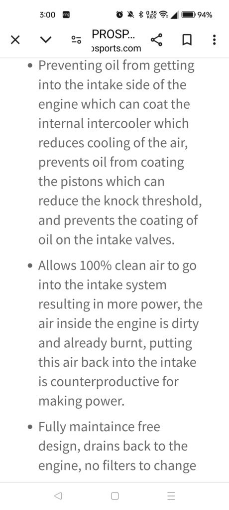

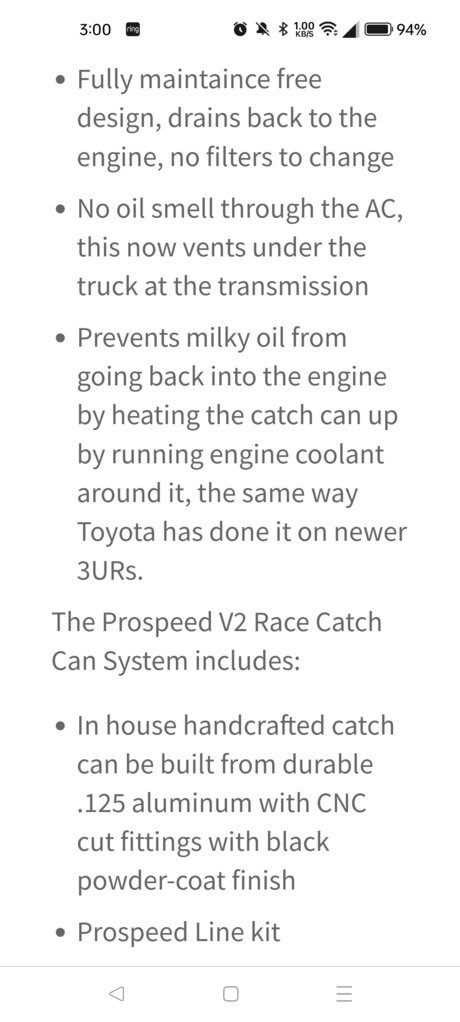

    Does that catch can dump what it catches back into the engine? So more like a catch and release can. And not to totally rain on your parade, but isn't the point of a PCV system to dispose unwanted gasses out of the engine? Not condense them and send it back... :notsure:

    Looks like you could just mount to the cowl if your gonna keep it. More stuff to that's in the way to get at the injectors.

    According to PS it does. But the coolent running through supposedly does not allow the milkshake oil back. Idk. I am no Prospeed ball hugger. Originally looking for their V1 CC but they gave me this one at the same price. So here were are, albeit it doesn't mount with a 2650 anyway

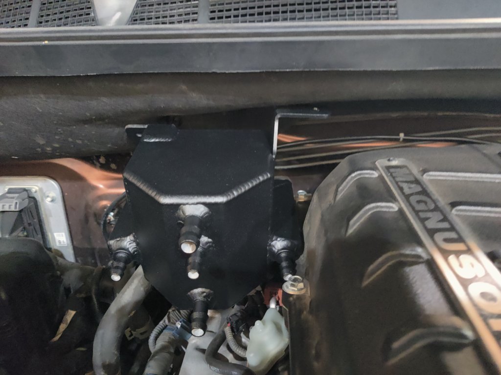

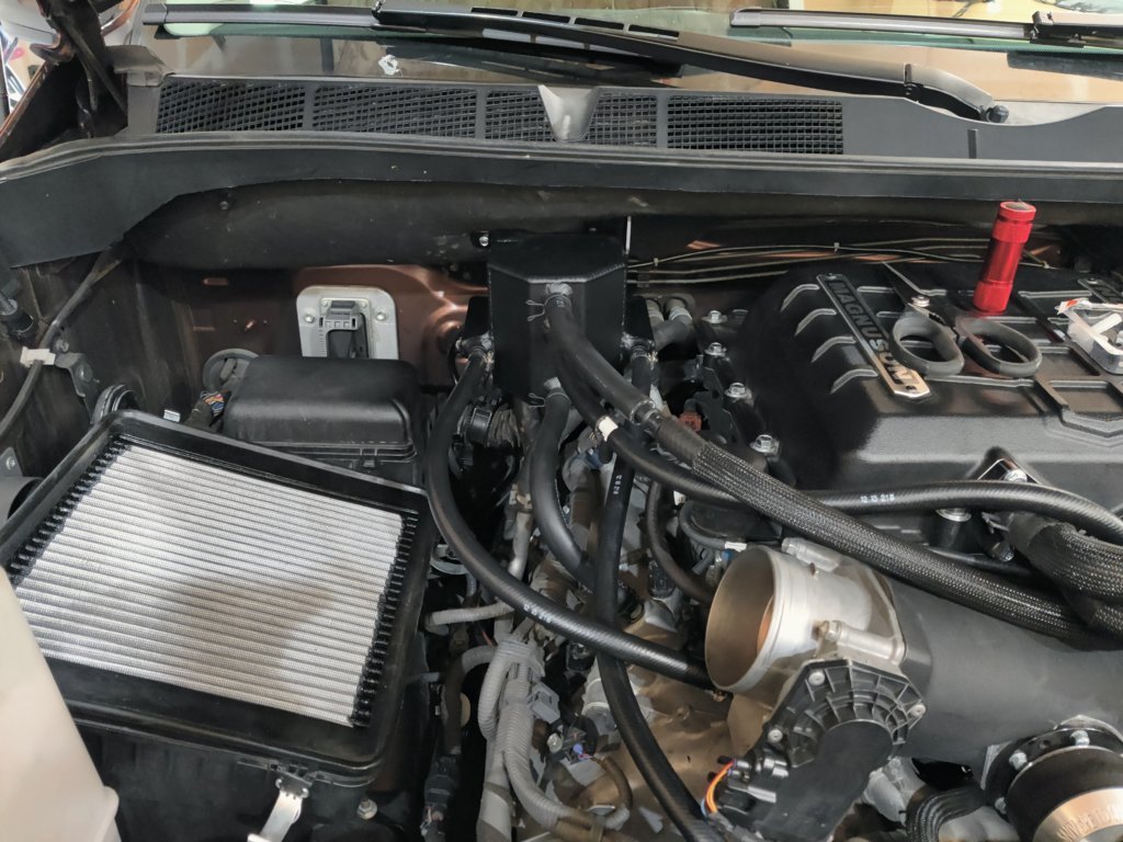

    Alright got it mounted and lined out. Guess I'll run it for a while and see how it does. It might just be snake oil. If I were to do it again I'd just get a regular CC, at least that way you can see and empty the milkshake.

    I see the magnuson lid makes for a nice work bench. Looks like a good spot to set your 10mm and never see it again.

    Ive actually knocked my socket set off the lid and had to fish them from the motor :rofl:

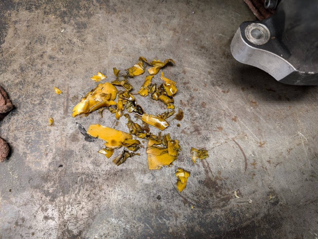

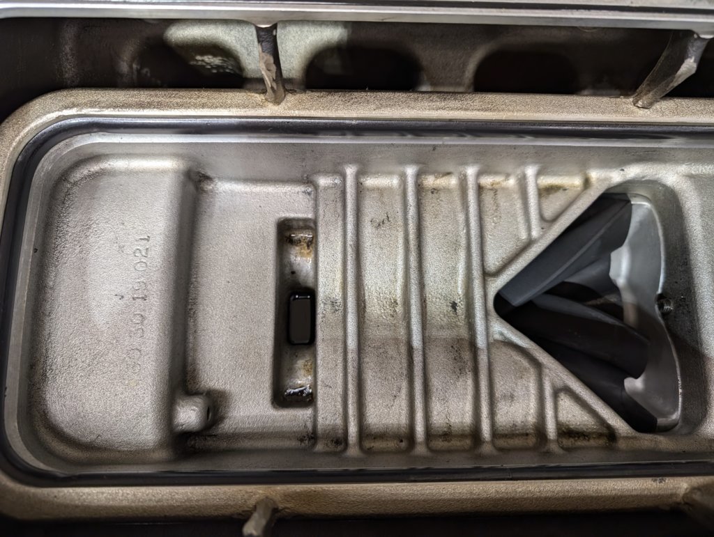

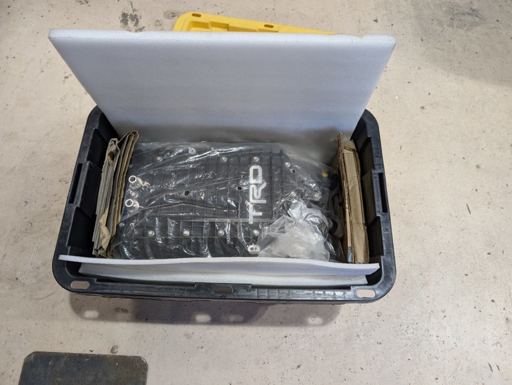

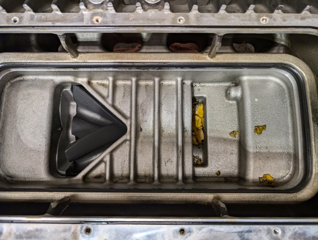

    I was packing up my TVS1900 to be shipped off and decided to pop the lid off to see if there was any oil accumulation, after seeing the one that @snivilous posted. I was satisfied that there wasn't much.

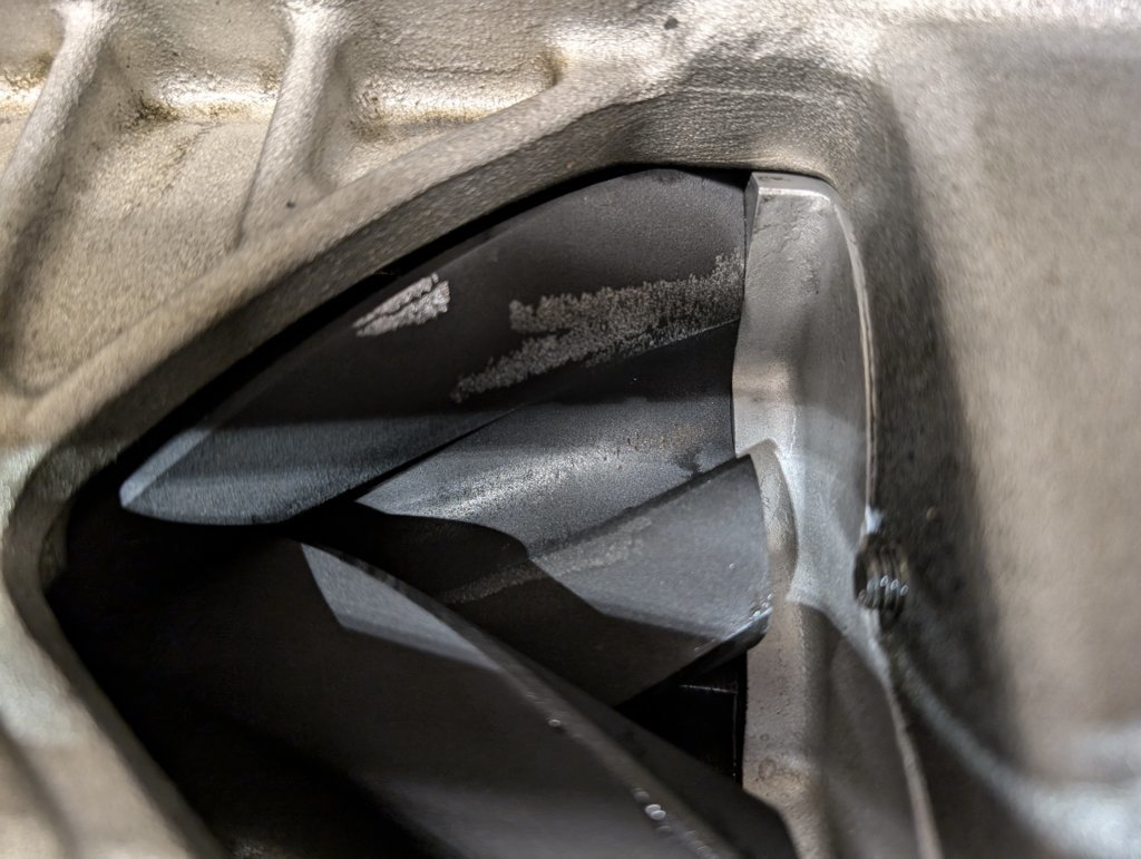

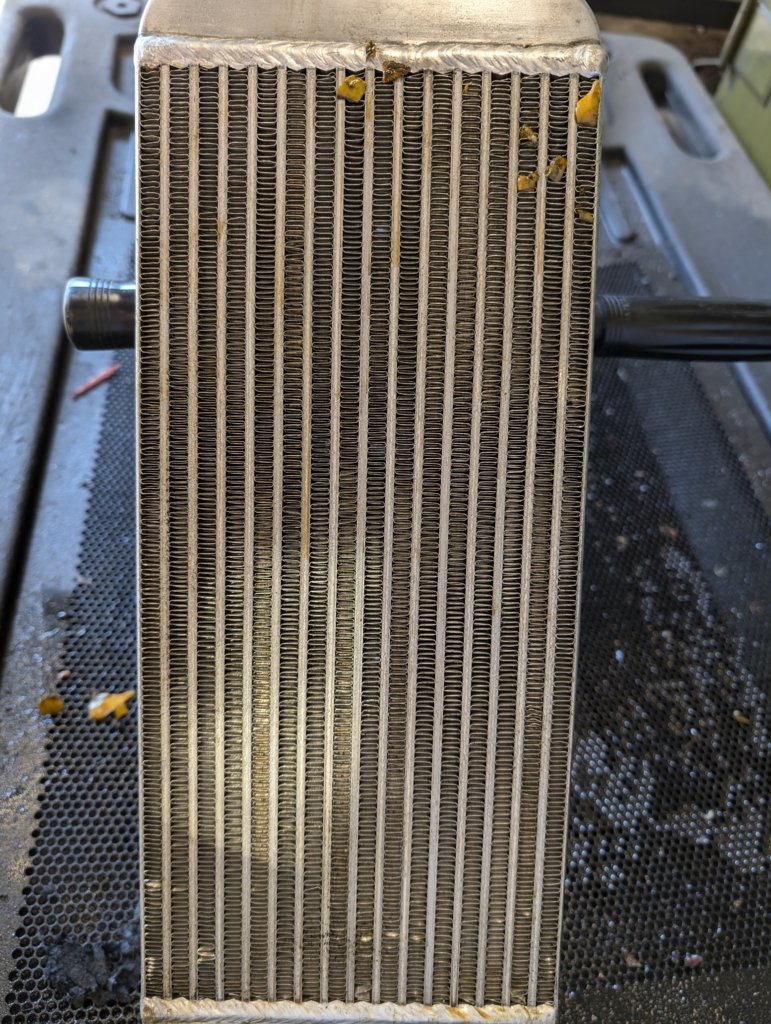

    Buuuut . . . that was after I cleaned out these yellow bits of plastic that somehow got inside. I did pick this up second hand with a claimed 5k miles on it. I have no idea what it used to be.
    The intercooler filtered it out preventing it from getting into the engine.

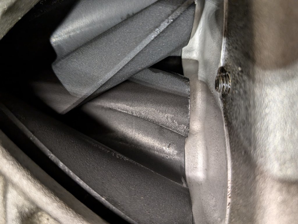

    There was also some wear on the rotors.
    I hope that this does the trick. I'm going to strap it to a pallet in the hope that it will reduce the chances of it getting flipped ass over tea kettle.

    Wtf where the hell did that plastic come from?

    I know, right? Must have happened with the previous owner. It's the density of a plastic food container, or a port cap. :notsure:

    Maybe the original installer didn’t remove the plastic plug from the intake port, and they were yellow at the time? Lol

    That's something I've wondered. The only problem would be that the intake narrows at the bypass valve and it would've needed to get past that somehow. The plastic bits were about what I would imagine that red plugs thickness would be.

    Looks like that yellow foam around the engine in areas that you have to remove. But wtf lol

    The foam that was in my engine was very foam-like and crumbly, not like the lid from a butter container. It remains a mystery.:notsure:
