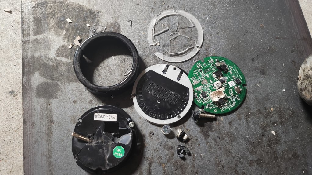

    Dealing with AEM on a warranty replacement of my boost gauge and they had me smash the defective unit...so satisfying

    hmm, I could have used the clear lens from that pile. Mine came with a small scratch and my OCD always sees it. Not sure if they sell that separately or not, I never inquired about it.
    edit: nevermind, I have the psb-1. It’s been a long morning.

    What was the issue with it

    Wouldn't log correctly, gauge read correctly but couldn't get any accurate logs. I had a couple of support cases with HPTuners before finally opening one with AEM, they are sending me a replacement gauge since I purchased in January of this year and still under warranty.
