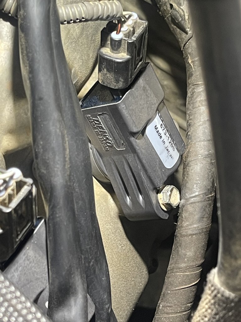

    Correct, not very high, but my threads were dirty after removing the stock intake and blowing out the holes...the bolts were torqued before they were fully seated, so there was a leak. I had to remove the blower and chase the threads to get the bolts to fully seat, and then when torqued the leak was gone.
    I didn't have any issues with idling or driving under vacuum, boost was missing though (I think the weight of the SC kept it sealed until under boost). The boost pressure is after the MAF and fueling is based on wideband readings or throttle input, so it didn't make a difference like if it was efficiency-based with a MAP sensor.
  13. Aug 26, 2024 at 8:17 AM
    armyoffoo
    armyoffoo Member
    Jun 4, 2018
    #15876
    1,474
    Cypress, TX
    2018 Black TRD Sport CrewMax
    Supercharged with all the trimmings
    Here you can see what I'm talking about. The passenger side long bolts weren't engaging like the driver's side. This was the sole cause of my boost leak and chasing the threads fixed my issue...probably not the same issue unless the bolts came loose for some reason.

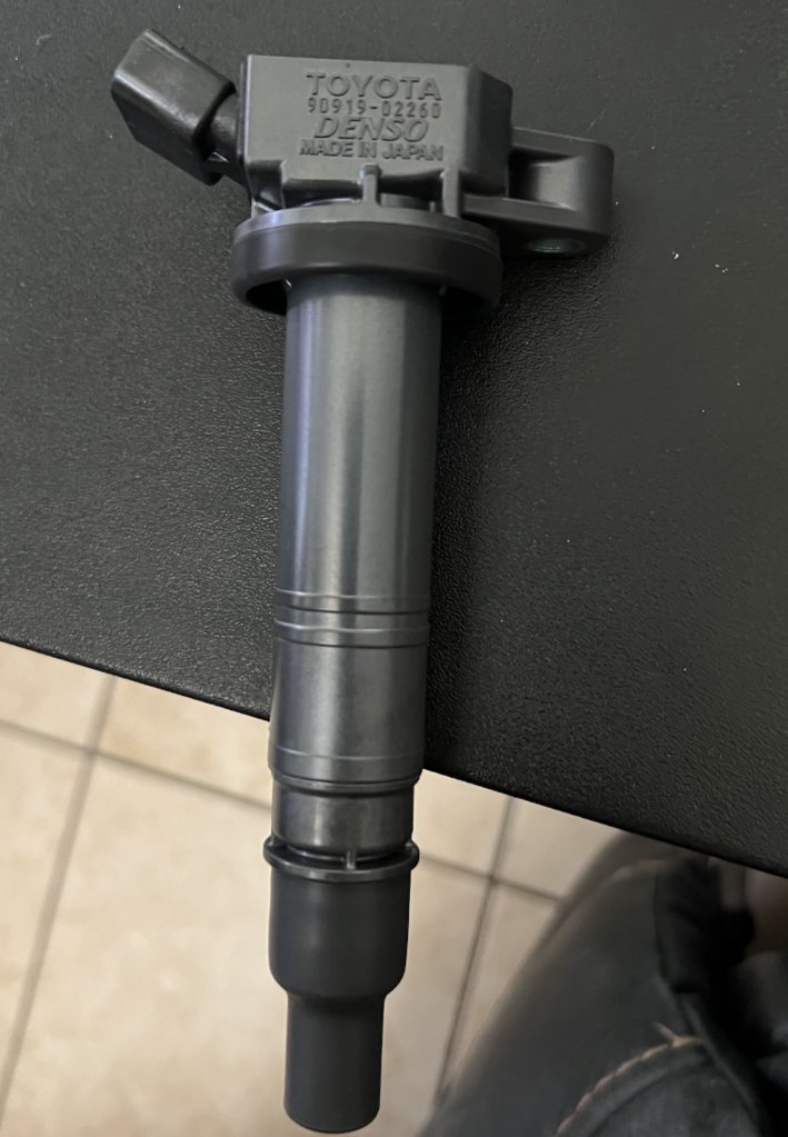

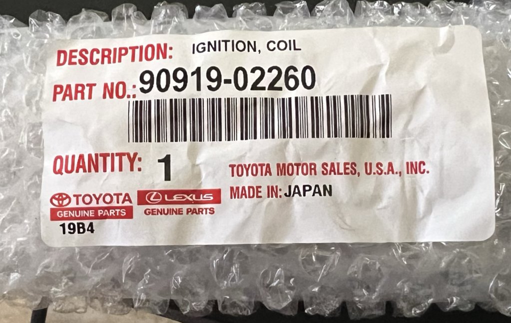

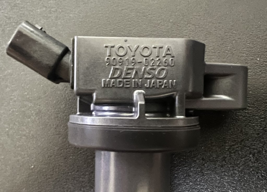

    Since they were 25% off I got the Toyota coils, they appear to be identical to the Lexus version.

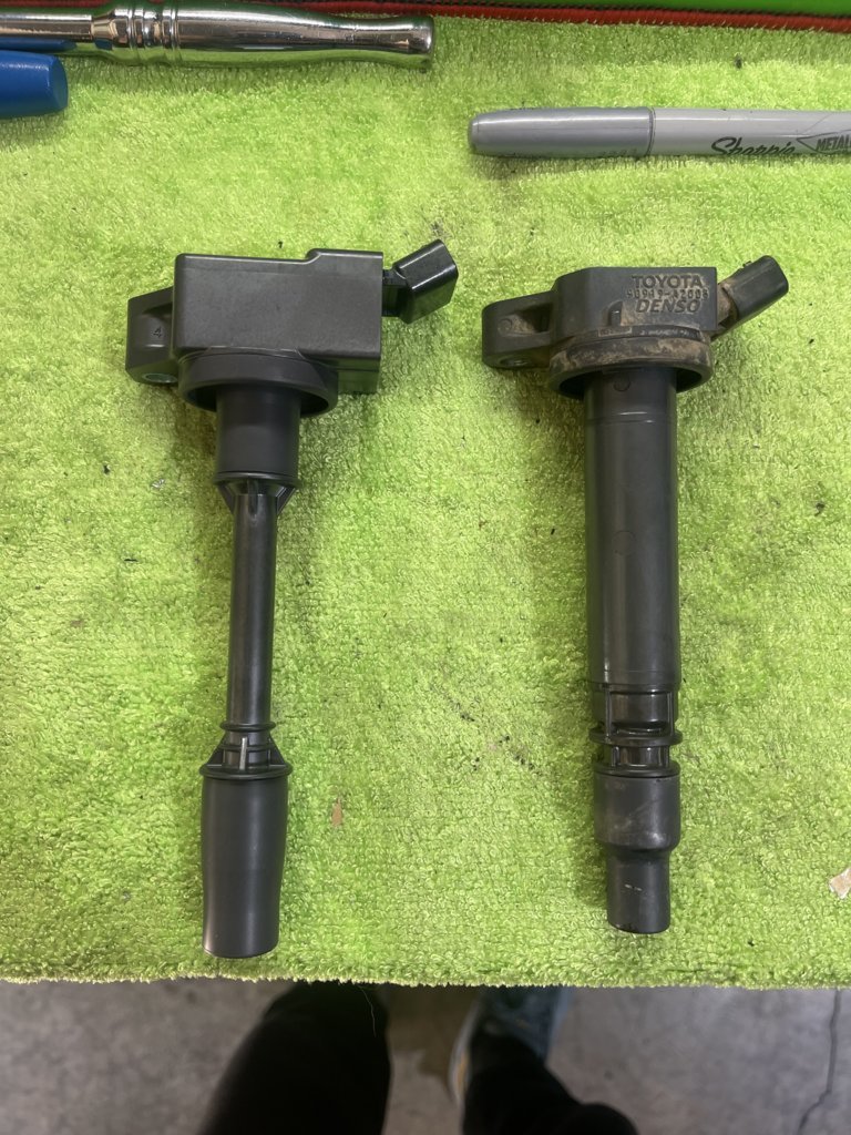

    Are you going back to the original stock ones? The 8arfts coils are a different design. 90919-02269 doesn't cross reference to the part number you posted.
    From @Jowett
    The coil arrived and is obviously different, so a little research leads to the following… For the newer generations of engines, Toyota has moved the goods up and out of the spark plug tube, it’s no longer a stick or pencil type unit, but a top mount coil. This move is for an increase in durability due the coil being able to run cooler. The engine literature also mentions these are a high energy type, but do they produce more of what we need? I suspect they might. While not listed as a Dynamic Force Series Engine, the 8ARFTS was a transitional engine that uses much of the newer DFS technologies. Just as with the run to higher performing spark plugs to prevent misfires, perhaps too with the coils?
    They physically bolt in place of the stock coil, and the wire harness plug snaps right on. The harness connector is a much more durable type, and supports the wires leading into coil with a loom. Now to find out if they are truly compatible.
    New type.
    Old type.
    [​IMG] [​IMG]

    That was not my plan, looking at my original, it looks like I threw 400 bucks away :(
    They are for the new turbo V6, maybe they will work.

    @Mdl Opening up the gap will be the real world test. The DILFR7K9G plugs that come in the 8AR-FTS are spec’d to have a gap of .035”/.89mm. Start with .030? It produces mid teens for boost with a max of 17 psi.
    @e30cabrio Those coils are for the 3UR, 1GR, and a whole variety of the previous generation of engines. The new twin turbo V6 coils have a different number, and will not work our generation of engines. We got lucky (still to be proven as better) with the 8arfts being a crossover of technologies/compatibilities.
