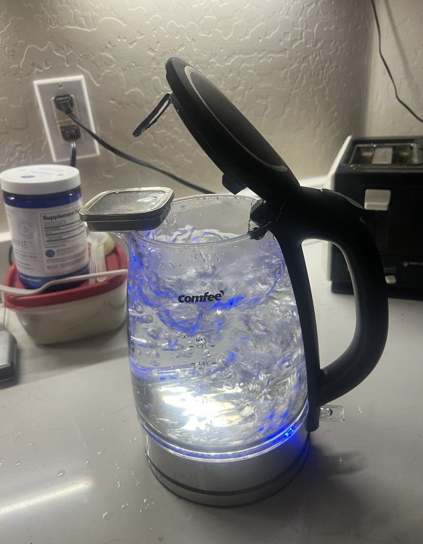

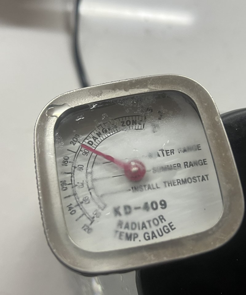

    The thermometer is 13 degrees low.
    I'd think the gauge in the dash is getting its data from the sensor telling the Autel it is at 221. I also think over 220 I'd have a warped head.
    I'll order a sensor & not drive it.
