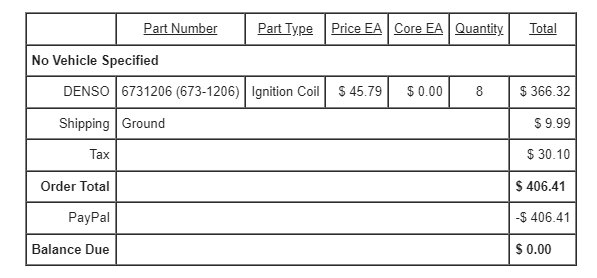

    Ok ordered the Lexus coils from rockauto denso units. Going to also throw in some fresh o2’s while it’s apart.

    what is rockauto charging ?

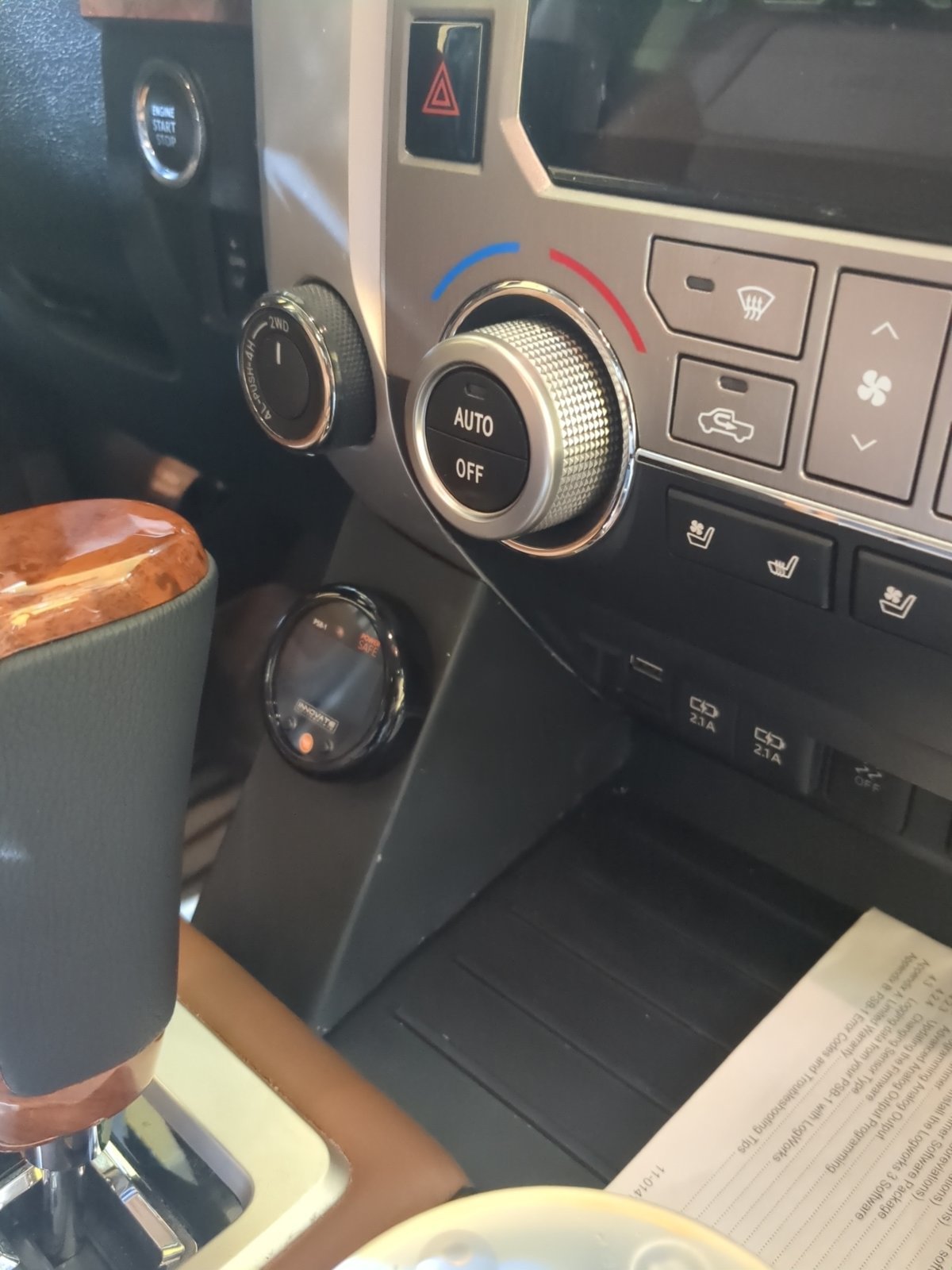

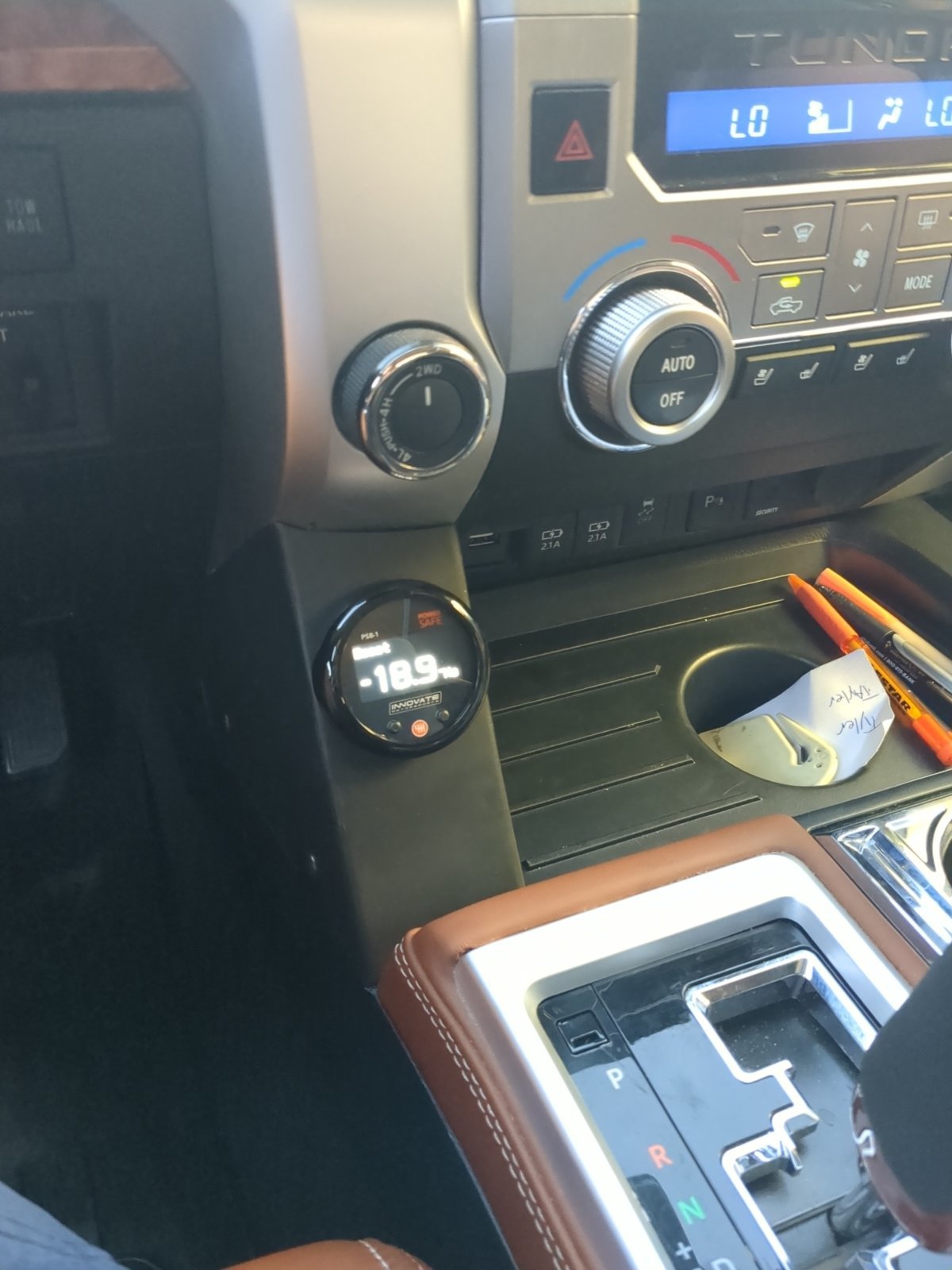

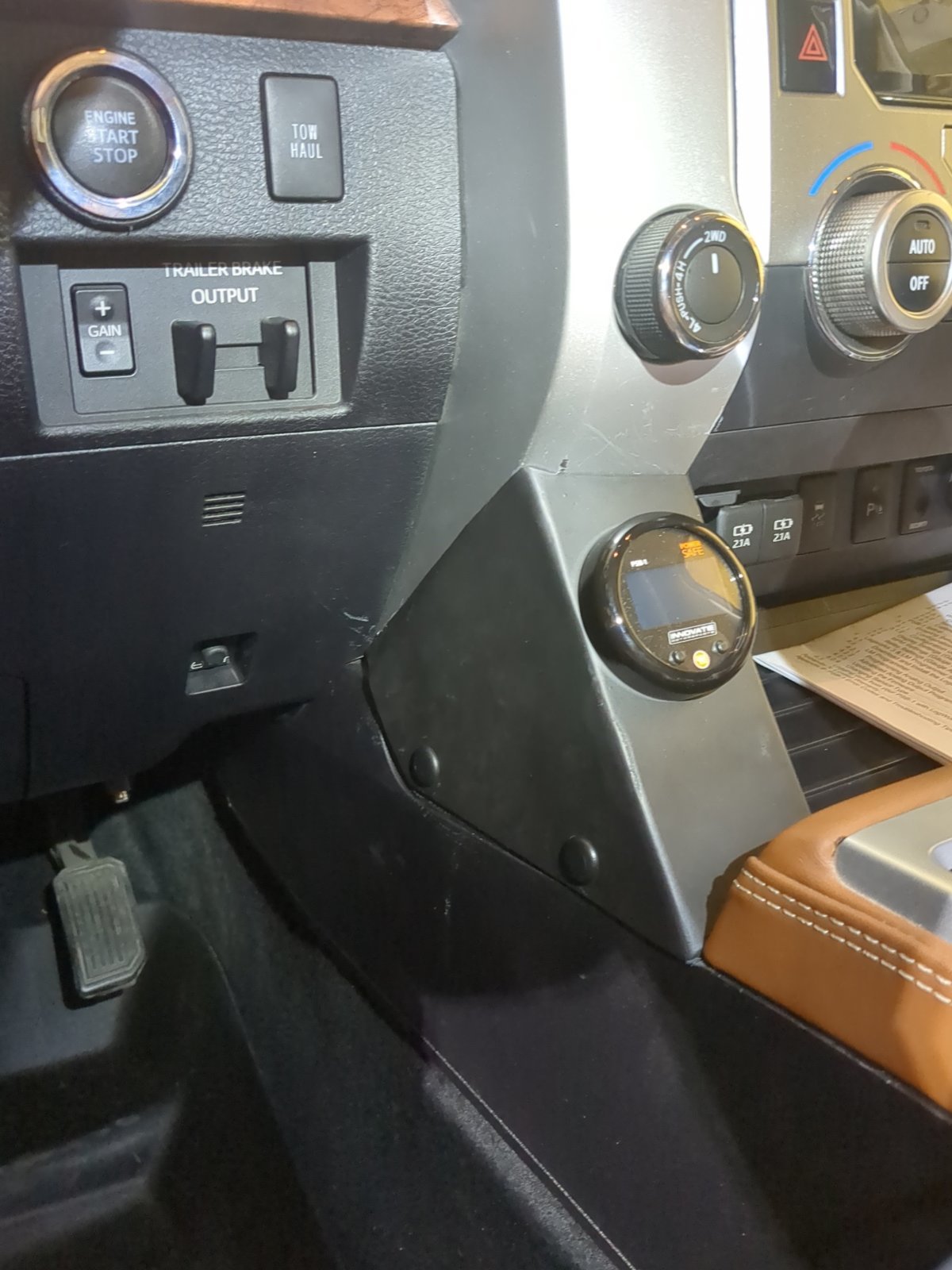

    My first time installing an AFR gauge on a 2.5 Gen (2021). I'm not a fan of the options out there, so came up with this:
    Little more dialing in, but so far has turned out absolutely awesome! Only took six revisions to make it fit how I wanted. And it's a single piece of flat patterned sheet metal.

    Sign me up! Caveat: no squeaks or rattles and the dial can be turned to split the difference between the HVAC and shifter.

    Nice workmanship!

    So far it seems squeak and rattle free, there's rarely a noise that might be coming from the back right corner of the mount so going to do some trimming tomorrow to see if that stops it. Can move the gauge where ever you want, I biased it higher since it's at a 45 degree angle so thought the wires would package better not coming out right next to the floor of it.

    Thanks Mike! I have a whole stack of prototypes where I would move stuff 1/8" trying to dial it in. I wanted it as close to factory looking as I could. I need to go back in tomorrow and clean up the plastics and some of the mount since stuff got scratched a bit trying to get this in. Getting the fitment so tight is a blessing and a curse when it comes to assembly!

    Looks awesome brother

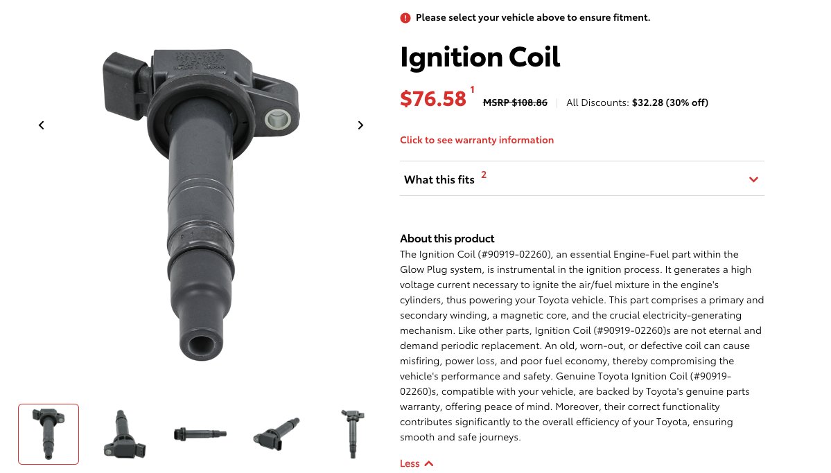

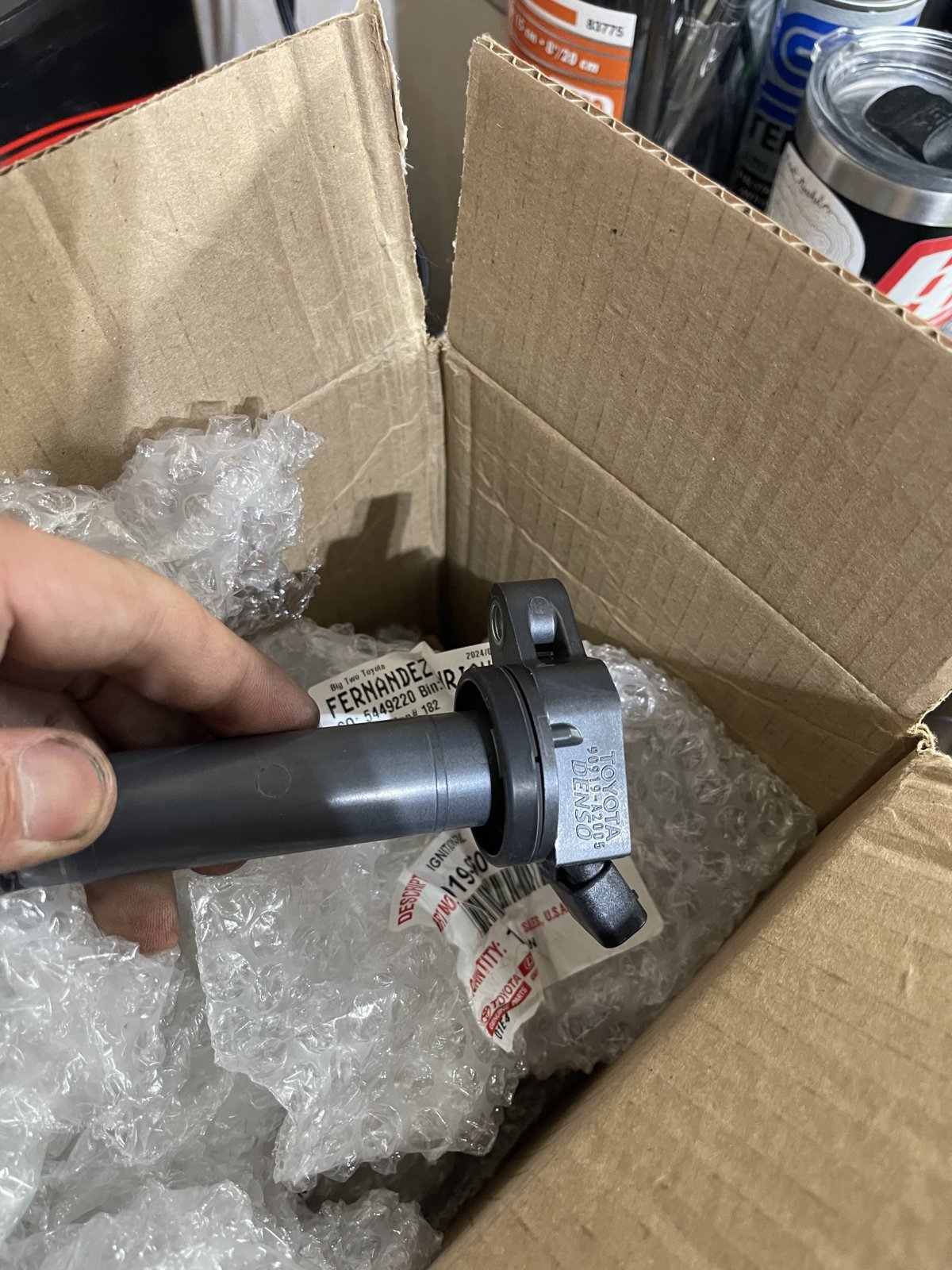

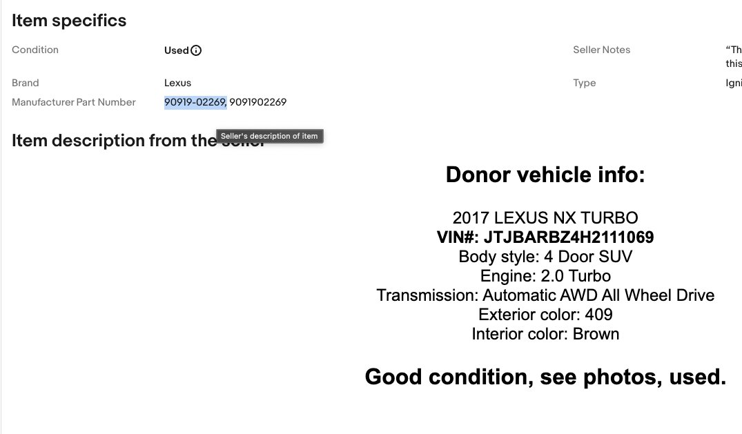

    The part number I searched came from my eBay purchase
    90919-02269

    Seeing as the oem is a denso also I think the rock autos should be good. If yall didn’t lie to me about rock auto that is lol

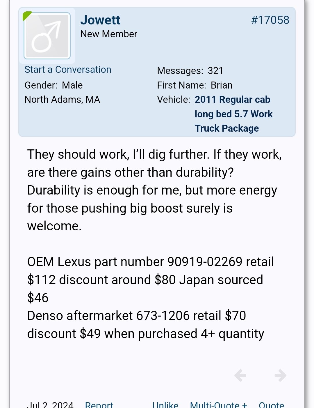

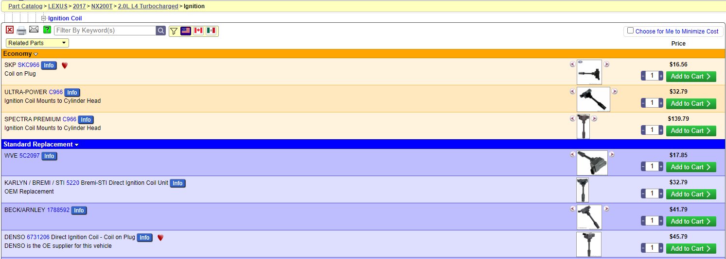

    According to Jowett it's Lexus 90919-02269 or denso 673-1206. The Denso cross-references to the 02269.

    I was just referring to the part number you posted for the link to that AZ dealership. You showed the 90919-02260 instead of the 90919-02269

    Rockauto.com had this part number

    That's a decent price.

    Some more research shows this is the coil for the Turbo T24A-FTS in the Grand Highlander. FWIW

    Yea that’s what I ordered should be here Thursday

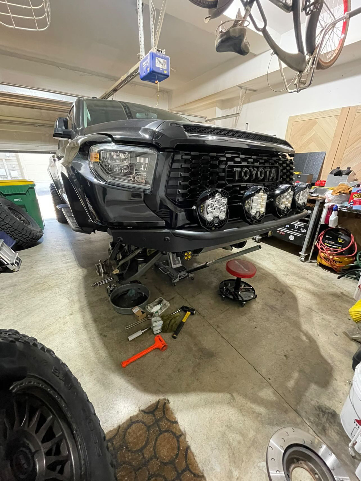

    Running through the hit list
