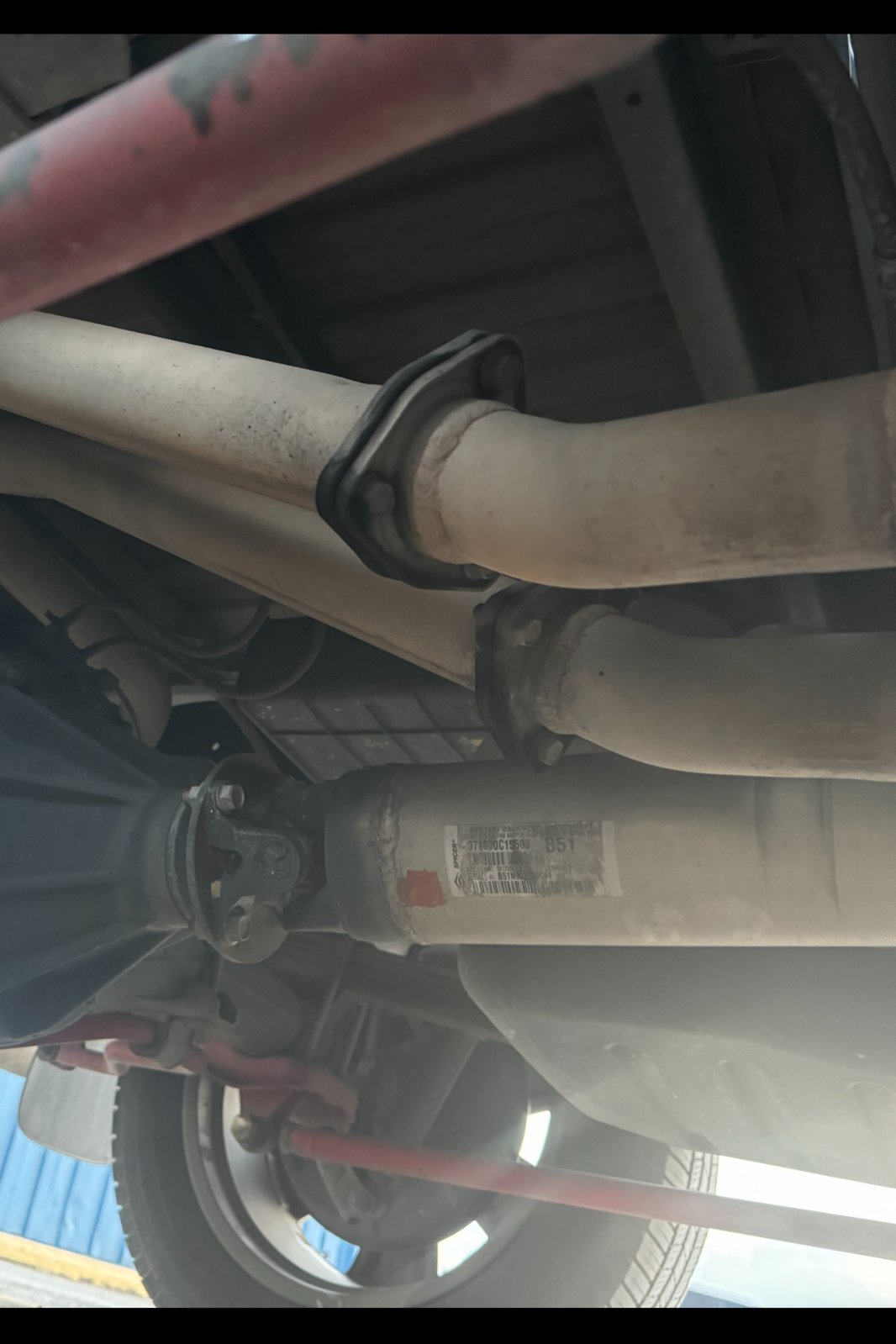

    Recently, my Trd exhaust started to sound different, in a good way
    well, the gasket things are about gone
    Before I attempt to replace the gaskets, I’m gonna see how good this gets

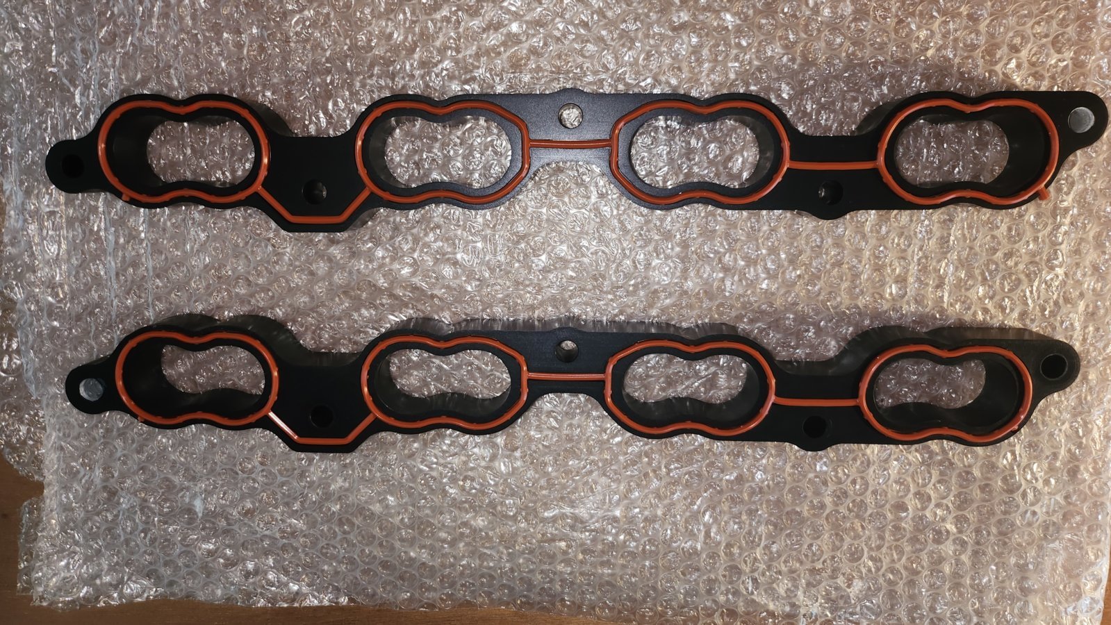

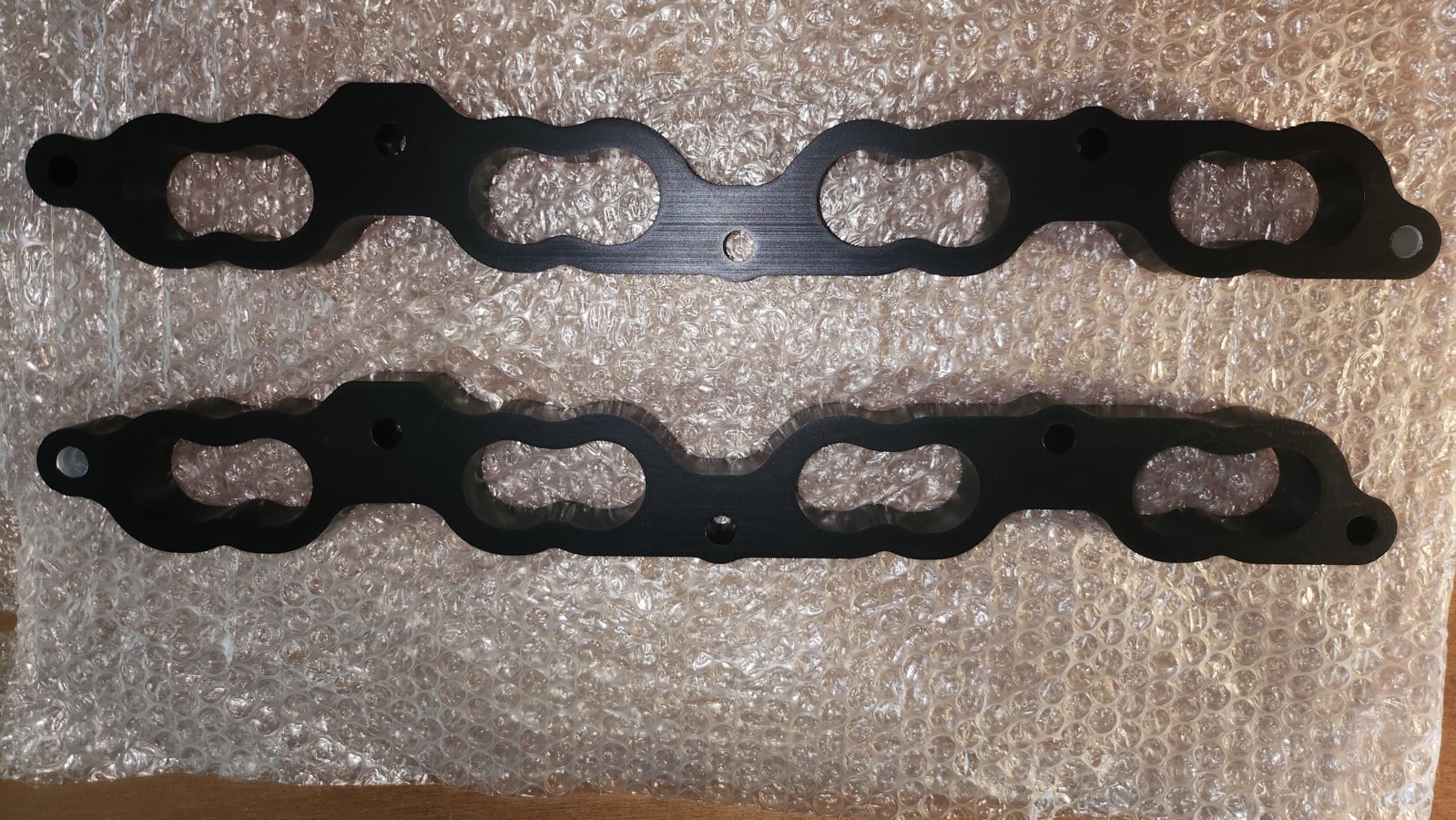

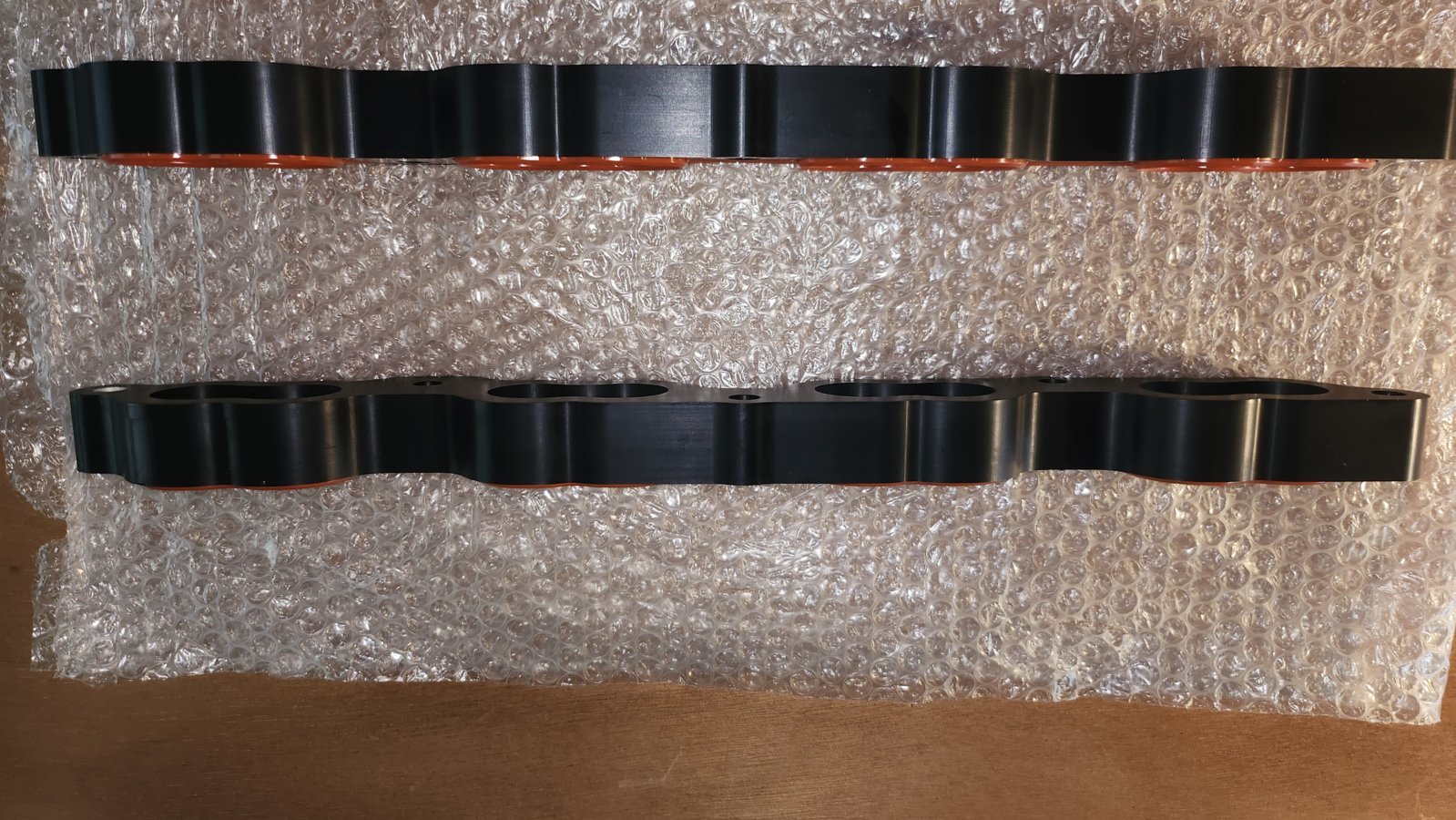

    I received the intake spacers from Anderson Engineering. I ordered the aluminum version, and they look pretty good...minor issues like two of the holes aren't anodized, and there are provisions for the gasket "nubs" to stick out that weren't machined all the way on 3 of the cuts, only one was done all the way through. I still need to get the measurements on the Harrop bolts so I can order longer bolts to install the spacers. I already bought the Gates K081196HD belt, so hopefully that works. Other than that, I just need a weekend without triple digit temps...

    Definitely watching this. Any plans for pre/post dyno for torque increase?

    So this site under the manifold then manifold on top. Interesting these not two gaskets? one on each side?

    Gasket on the spacer goes against the head, then the gasket on the blower sits against this. So it is two gaskets, similar to a "normal" TB spacer that only includes the gasket on one side, since the other side gasket is on the blower snout.

    Gotcha makes sense totally forgot about the one on the manifold lol
