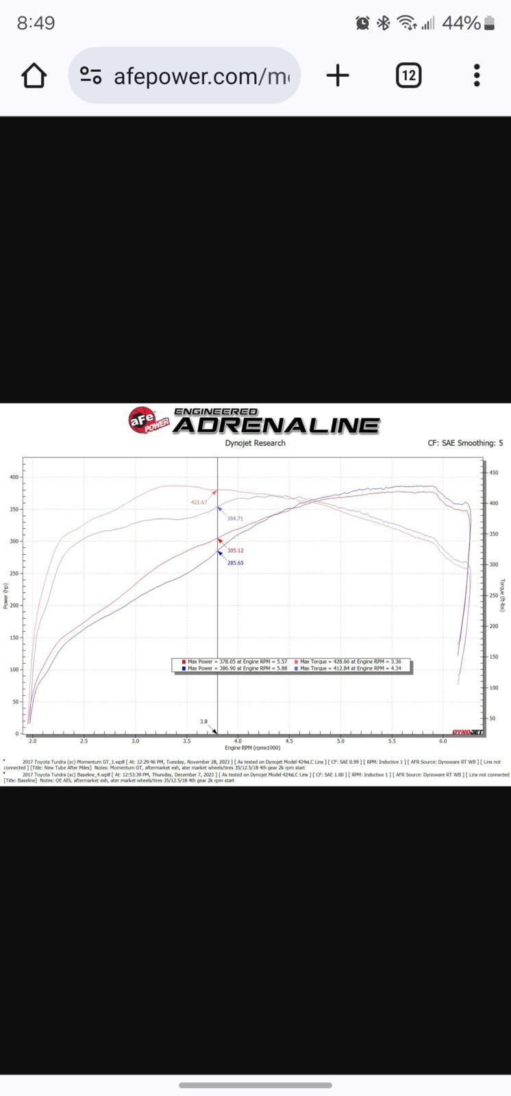

    I was looking at the new AFE CAI made for our trucks with SC installed. Why oh why must they test a new product on a truck with 35"x12.5"18 wheel/tire combo and an aftermarket market exhaust. Then post a Dyno that makes no sense, to me. Unless I am reading it wrong. Red is AFE. Blue is base line. To me AFE peaks at 3.8 then around 4.3 to redline base is higher.

    Mar-ket-ing . . . :rofl:

    Well they need to fire whoever heads up marketing because that graph show their intake is only good to 3.8k rpm. While they are at it, fire the engineering team that came up with this CAI.

    Not to defend what they're showing, but in the normal course of driving a majority of owners aren't going to be winding their trucks out. From that perspective it might make sense. Also, a lot of people are probably going to buy it because they think it looks and sounds cool to them.

    Could they not have posted a supercharged truck with the intake system. Does AFE not have money or what ? Shit I'll bring my truck to them if they wanna dyno mine with it and swap the new one just to keep it.
    Been looking at that intake for awhile now. Kinda attached to my stock box from maggie.

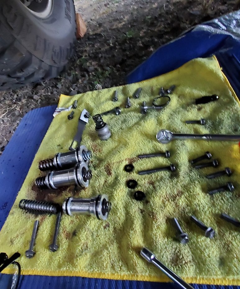

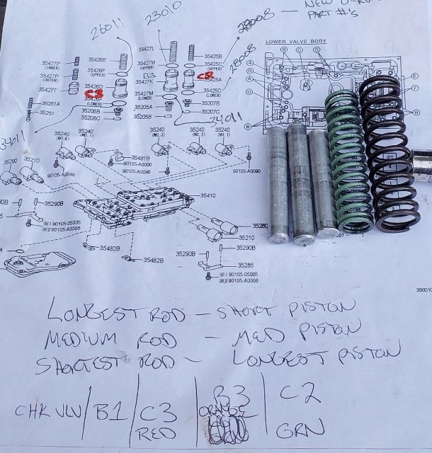

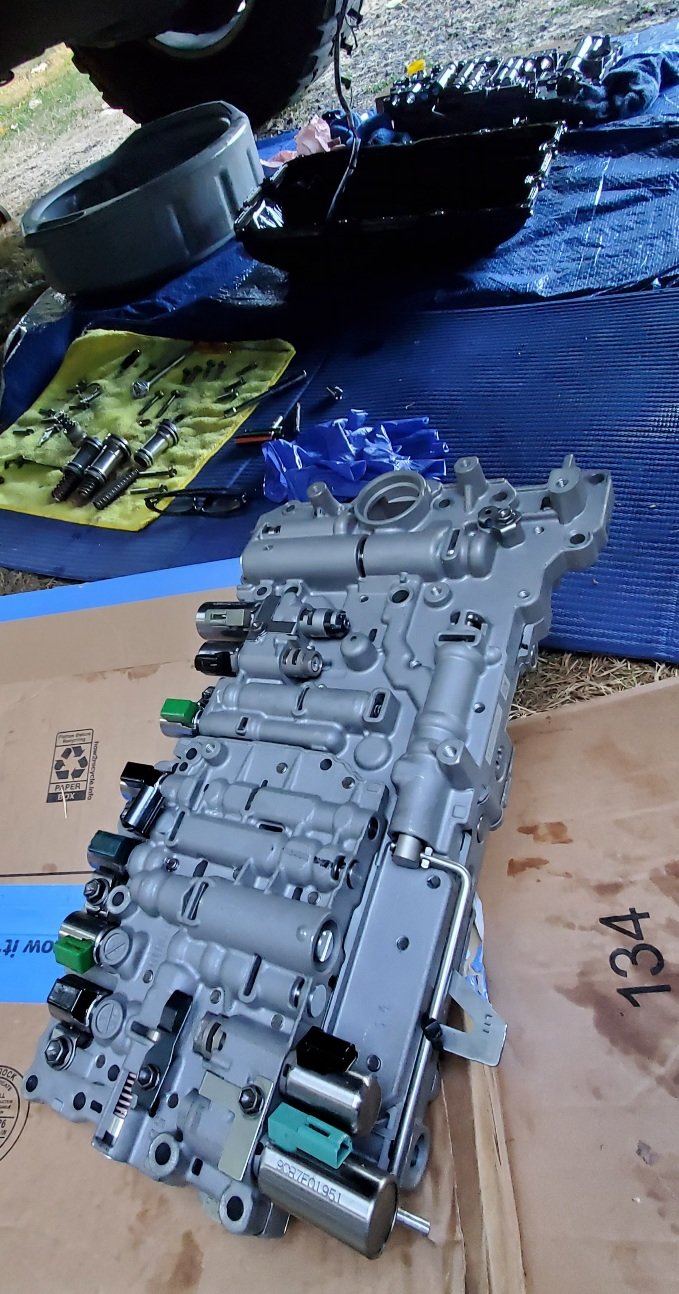

    Well I finally got a valve body from IPT. Ditched my 1970's cheap shift kit but kept the aluminum billet accumulators for c2, b3 and c3. Did a quick ohm check of the solenoids before installing. Everything went well except when i was filling the trans and my funnel fell over and about a quart of ws fluid spilled into my fender and windshield cowl! Ugh.
    Those rods limited the overlap when shifting so it was locking up the clutch packs quickly. Bye bye to those... Hopefully will extend the life of my trans until I can get it built.
    And yes, I get to work outside since my garage is my woodworking shop and got taken over for storage!
    20240726_191016.jpg 20240726_190951.jpg 20240726_190944.jpg 20240726_202505.jpg

    I use to have the same rod style shift kit in another tundra I had. Didn't have it long but you felt it shift.

    Nice work! Please keep us updated on how she's shifting!

    Yeah I wound up putting it into my 2nd transmission too. I think it's the only thing that saved my clutches from burning up by removing the overlap, luxury, shifting. It's not a bad concept just ancient and there are better things available now!
