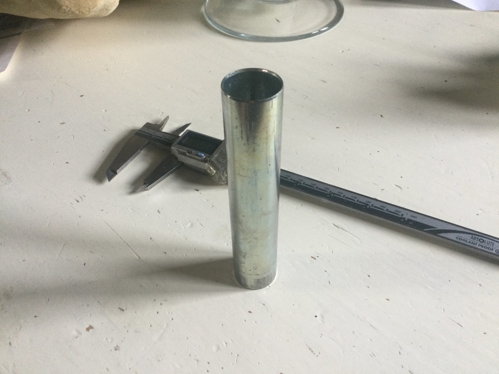

    Here’s a spark plug tube… any questions?

    Straight press fit w/ zero sealant. Given that it seats directly above the combustion chamber, I can see the clearance between the aluminum head and and steel tube growing large enough to weep through the gap. Maybe the steel looses some of the press fit tension over thousands of heating and cooling cycles?

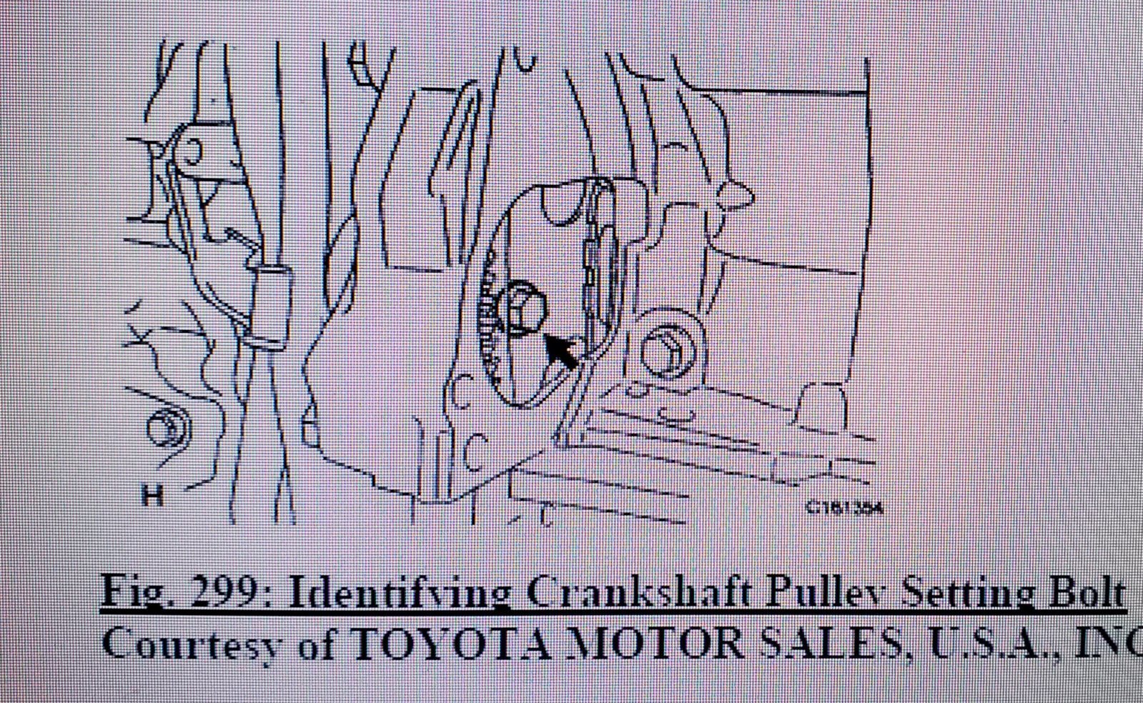

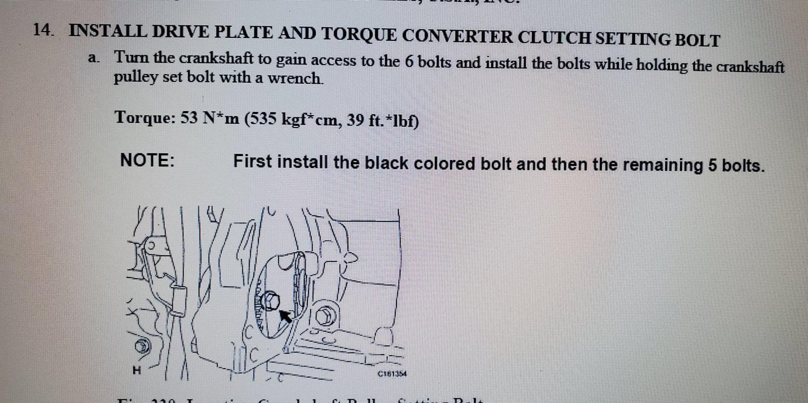

    For what it's worth, I've never heard, nor read of the one different (alignment) bolt that is to be installed first in the flex plate/torque converter during reassembly mentioned here by @ViktorG. Attention to detail counts for so much. I looked it up in DIY AllData where it is mentioned, but I never would've thought to do that and I'm 100% sure that I wouldn't have noticed it. I'm not going to be able to do the swap myself, we just don't have what I would need where I work, and it would take me 5 times as long (which is okay) but I wouldn't feel right tying up a bay that long even if we had the stuff (which I'd feel uncomfortable with). Just from a curiosity standpoint, of those of you that have changed out your transmission (@Mdl), who was aware of the alignment bolt?
    Well, FFS, it doesn't seem to want to let me start the video at the 42nd minute where Viktor talks about the bolt.
    (Also, I'm guessing that most of us here are subscribed to his channel, and are liking his videos . . . :thumbsup:)

    I only knew about it when I was talking to the Toyota head mechanic. When I fried my transmission I was asking questions no one at the service counter knew the answer. So I was able to go back and talk. I asked what it was and he said it'll have a shoulder. He said as long as each bolt is snugged down evenly it isn't detrimental as it'll usually line up.
    All they showed in the manual was a pic but no real explanation.
    Because I totally missed this part...haha
