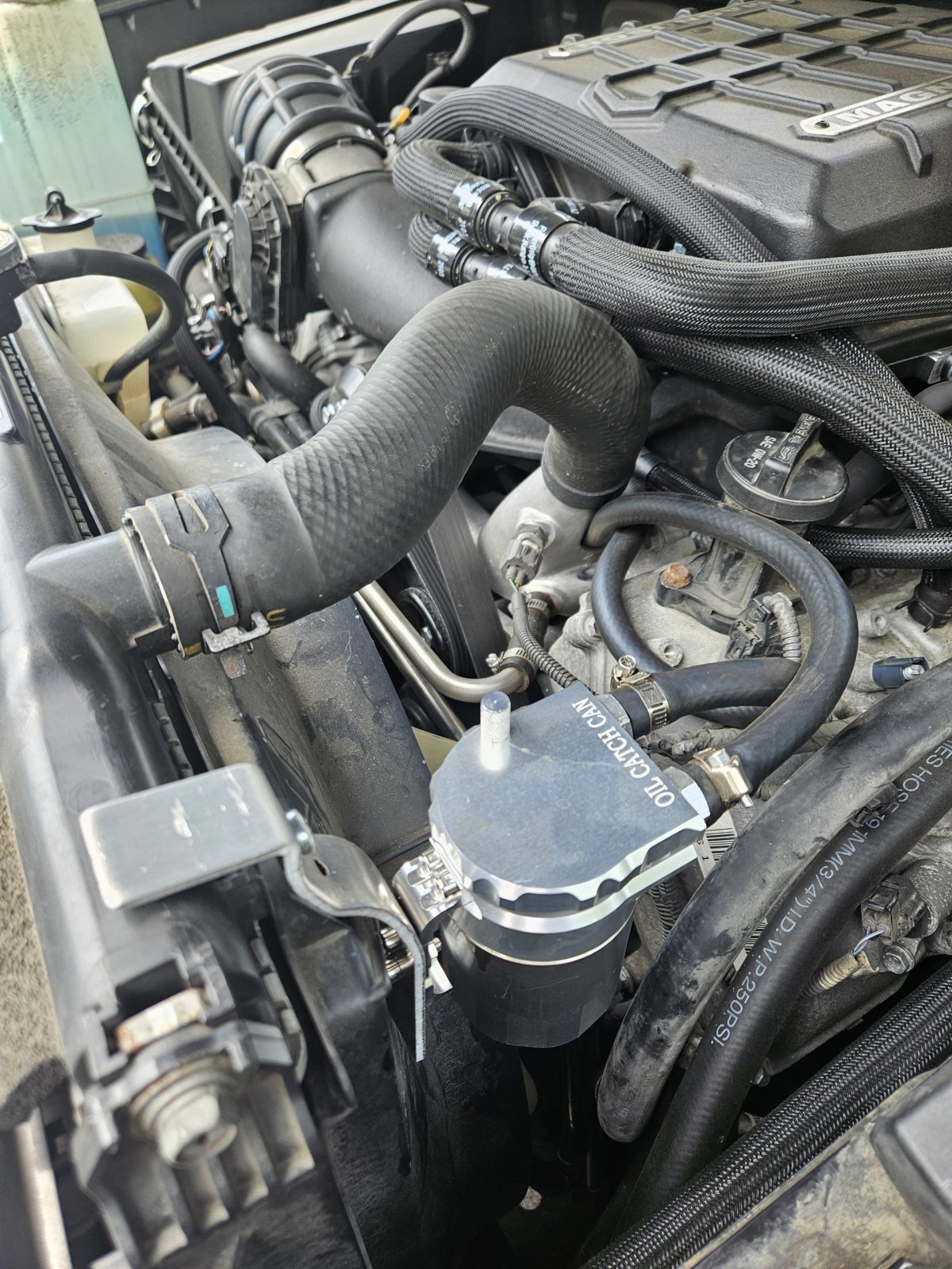

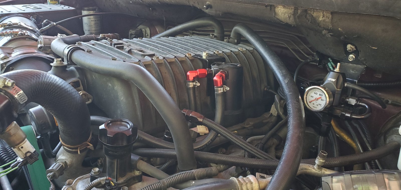

    If you got the 1900 you can hang it off the side of the blower just relocate the purge. But wherever is room for this stuff...

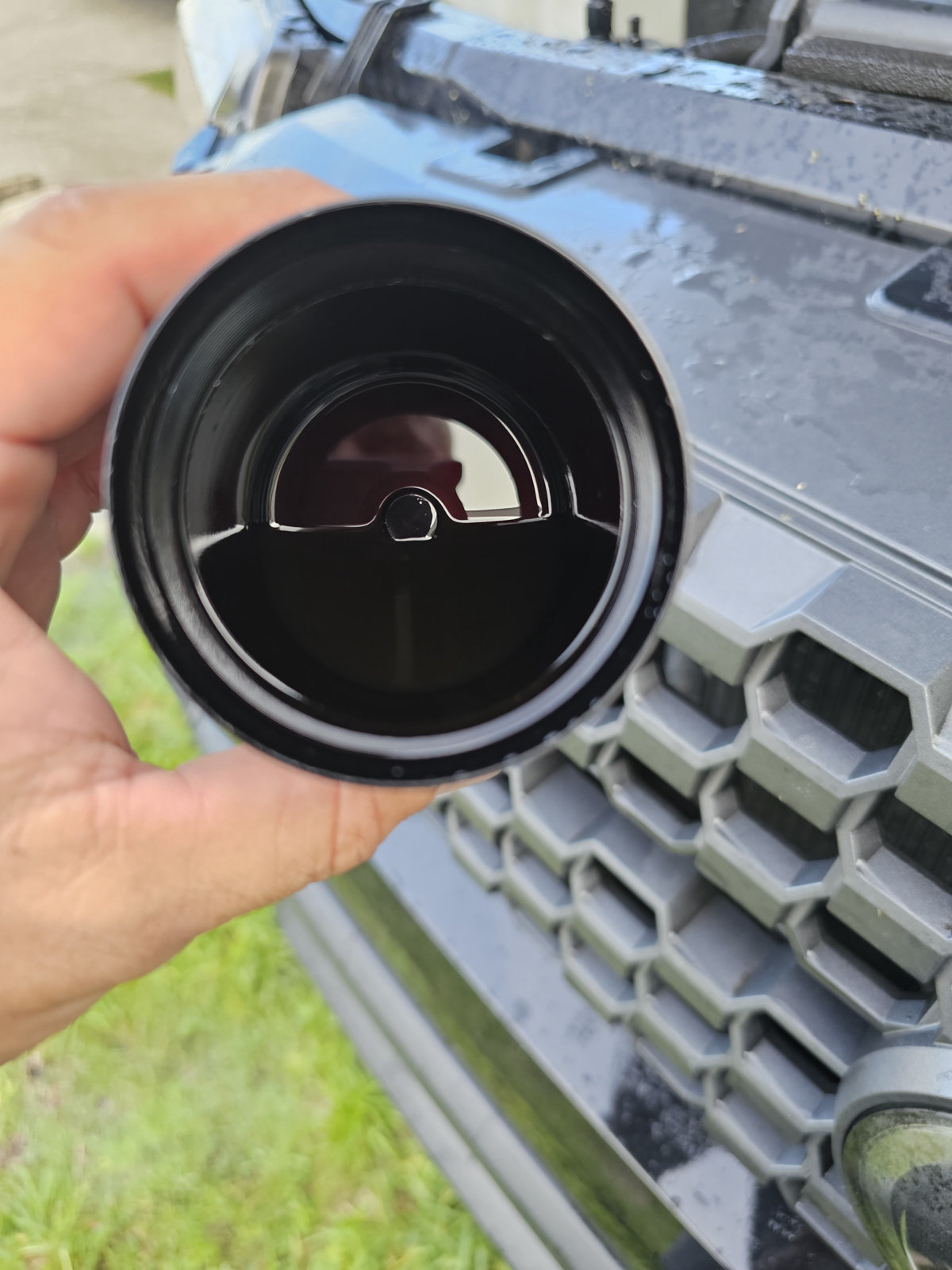

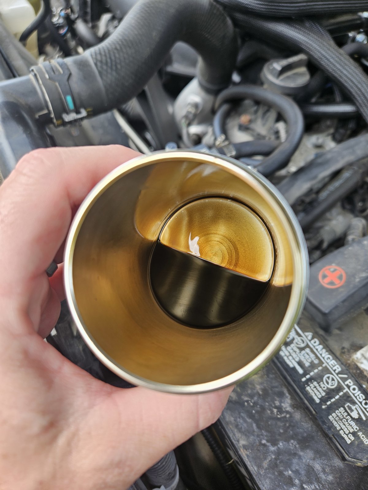

    Well, I said I would check my Radium CC after my trip. It's been 2300 miles and it has oil in it. Looks like it has a tad bit more oil than my JL CC caught after 5k. Needless to say, all that fancy crap they put in it was a waste of money, time, research, etc. and not needed.

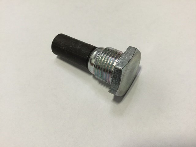

    With mods to the overflow drain hole, a Fumoto or EZ Drain can be added. This allows an easier filling procedure as the overflow can simply be turned on/off with the lever when temp is reached. The B&M over flow is positioned where installing a valve is not possible. The valve will also allow easy sampling of ATF fluid to check condition. Slowly slide the lever and grab a couple drops, a teaspoon, or fill a sample bottle to send off for UOA, then close it up… no fiddling with a drain plug.
    There are three bungs on the pan, only one is machined for the drain valve. The other two could be drilled tapped for some large magnet plugs. All magnets can be removed and easily be inspected for debris, or cleaned during fluid service. Three of these should do it.
