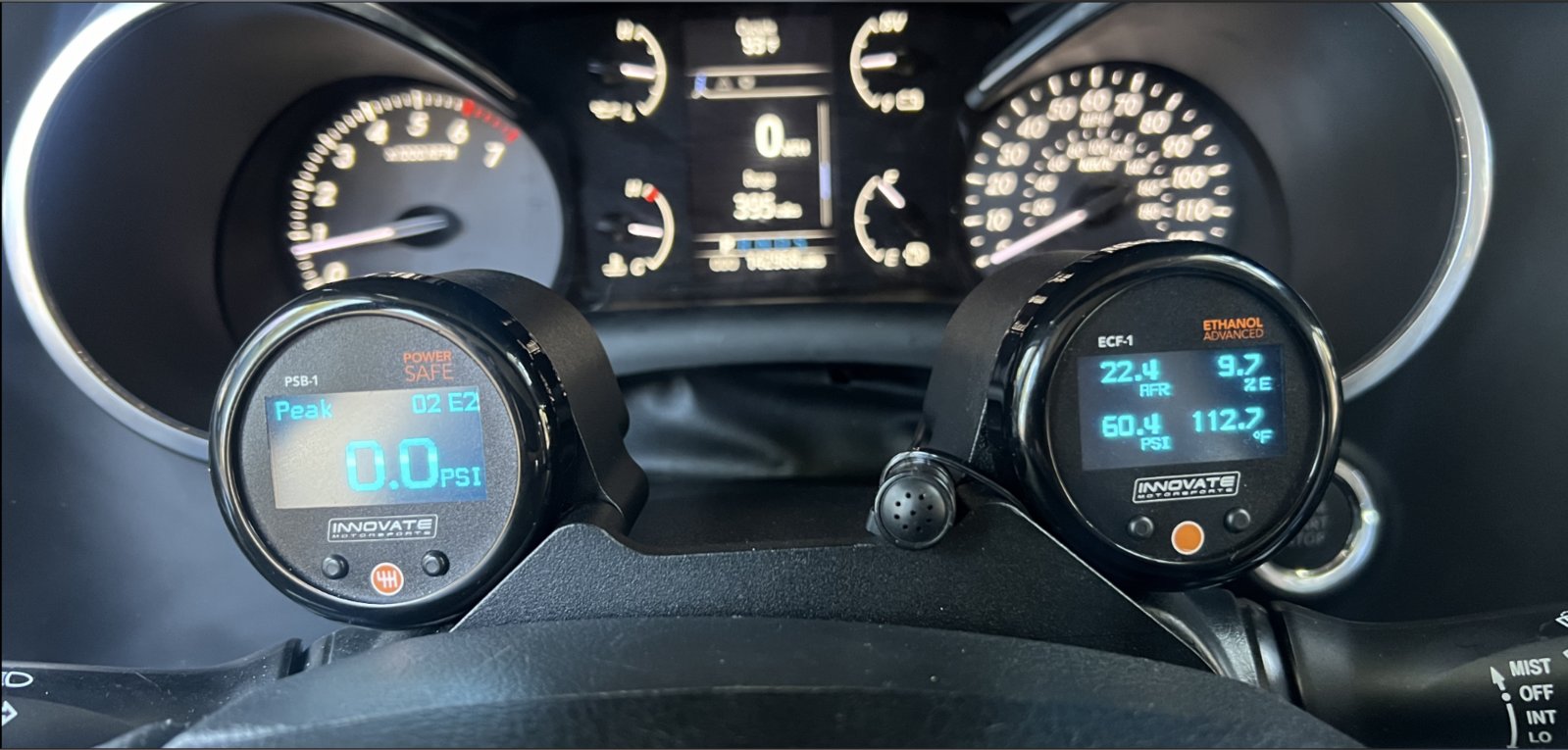

    Gauge is in, stole the passenger side O2 and am having the bung installed on the driver side, the AFR/Boost gauge will get that sensor (figured it made sense to have them on the right side) How do I get it to read the AFR A/F? It's on Lambda, I looked at the manual, don't see anything on switching it.

    Long press the left button until a menu appears. You can then scroll through the menu with the left and right buttons. Once you've selected the setting you wish to change, long press the left button again until the display flashes. Then use the left/right buttons to scroll up/down. Once you've selected a setting, long press both buttons to save that setting.
    FYI - Along with changing from lambda to AFR, you'll also want to set the fuel type to gasoline.

    Thank you!
