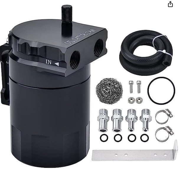

    Picking up another truck on Sunday to install a blower on. Dude is keeping it stock, but we decided to do a catch can. So I'll be installing the $32.91 Amazon one on this truck :D
    Also I checked Radium's website, and this catch can is actually quite a bit bigger at 300ml vs the 200ml Radium hahaha, so I'm not sure if there's any point to get a Radium. And there's even an "upgrade" for this that includes two inline check valves you can get, and that bumps the price to $40 :D Anyway, I'll get some photos next week of how I mount it in a Tundra after talking about it for other vehicles. I guess the Radium you get a bracket, but for $5 I'll mail anyone a flat pattern bracket to save you $200+

    Also was looking for a CC. Ordered the PS and they let me know they now have a redesigned CC. Was told they're being made right now and it'll ship out a week/week and a half. I haven't seen they redesigned version so not sure what was updated.

    Does it still vent to atmosphere? Sometimes in wet climates it can cause condensation to form inside valve covers.

    2650/750cc/76mm/SPD DP-DD exhaust/HP tuned
    Honestly I am not sure. Was just told old ones are done and new ones are being made.

    This thing is tiny.

    At least it's redesigned so you didn't end up buying the worst one made, unless they one up themselves with the redesign :rofl:

    You can leave the breather off. It has a plug
