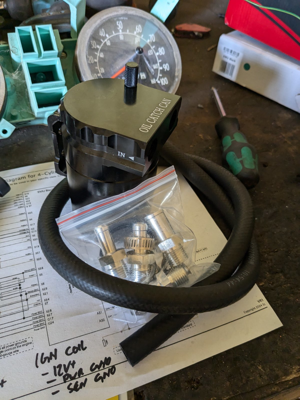

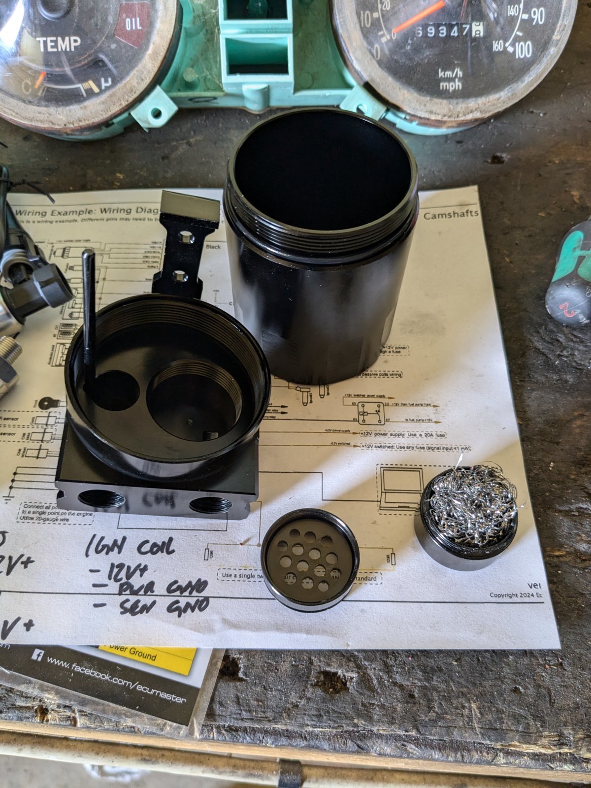

    Here is what $34 of catch can on Amazon gets you.
    This is what I have on my supercharged LS, and this one is going on my 2JZ as it gets boosted. On the LS it collects quite a bit of shit, though that's also on a fully built engine so not really apples to apples comparing to the Radium. For $34 there's a lot of stuff I like, all machined aluminum, has engravings for "in" and "out" which is really nice. Has a bunch of random fittings included. Has a dip stick. Includes some fuel line albeit not a lot. Includes a funky little bracket (not shown in photos). It's pretty basic, it includes 2-3x the amount of steel wool as needed, and you pack it into this little container thing and thread it in.
    So what does an additional $265 gain you for the radium? It gets a custom made sheet metal bracket for the Tundra (that personally I don't like). I think the Radium is quite a bit bigger. Oh and you get the weird check valve ball thing people show that seems useless :D
    Food for thought.

    I have a radium one - pretty useless... not a drop in it after the last oil change. However, the mesh filter looks a bit more dense and, puck-like.

    yeah I bought it because I didn’t want any oil getting back into the blower. So even if I don’t empty it past 10k miles I’ll still be happy.

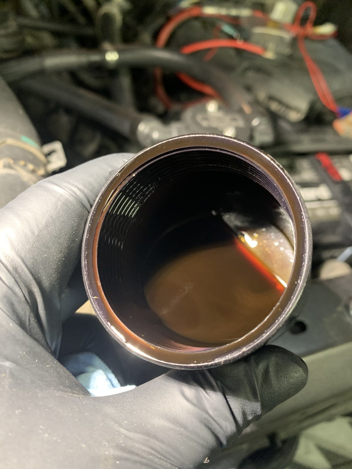

    About this much shmoeg every 1-2k miles. Usually see a 200 mile trip with a heavy trailer and hills at 70 mph in those miles.

    Thanks for the added details. I'm mixed driving (City/Hwy) on hilly terrain. A couple of hard pulls over the life of the oil.
