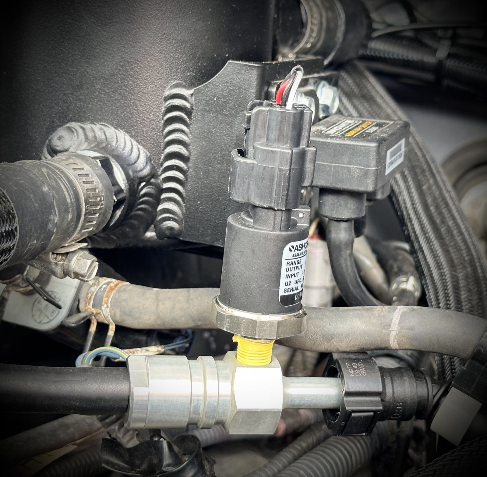

    PS - If you want to utilize the fuel temp portion, you'll want to get it with the EtOH sensor.
    https://www.innovatemotorsports.com/ecf-1-fuel-ethanol-advanced-gauge-complete-kit.html
    That was something I wanted and didn't realize would require the sensor until AFTER I bought the gauge. Although I got the gauge on sale for $359, I still spent another $100 to buy the sensor after the fact. If you're not looking for Temp/EtOH content functionality, get it without the sensor. It will change one of the fittings, if you decide to go the route I did with splicing into the small fuel line.

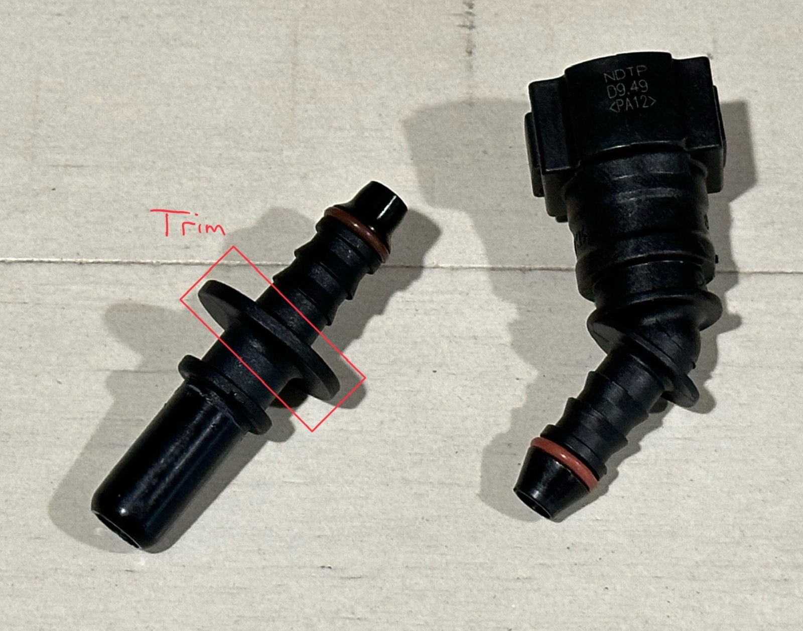

    Here's what I did originally:
    5/16" Male Bundy to 1/4" Barb (You will need to trim the gland/flange in order for the collar/gland nut - on the pressure sensor adapter - to clear)
    5/16" Female Bundy to 1/4" Barb 45º

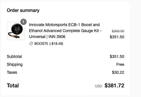

    I'd get it with the sensor, its 3x.xx difference. @Jowett don't suppose you have an Innovate account & can hook us up? :p

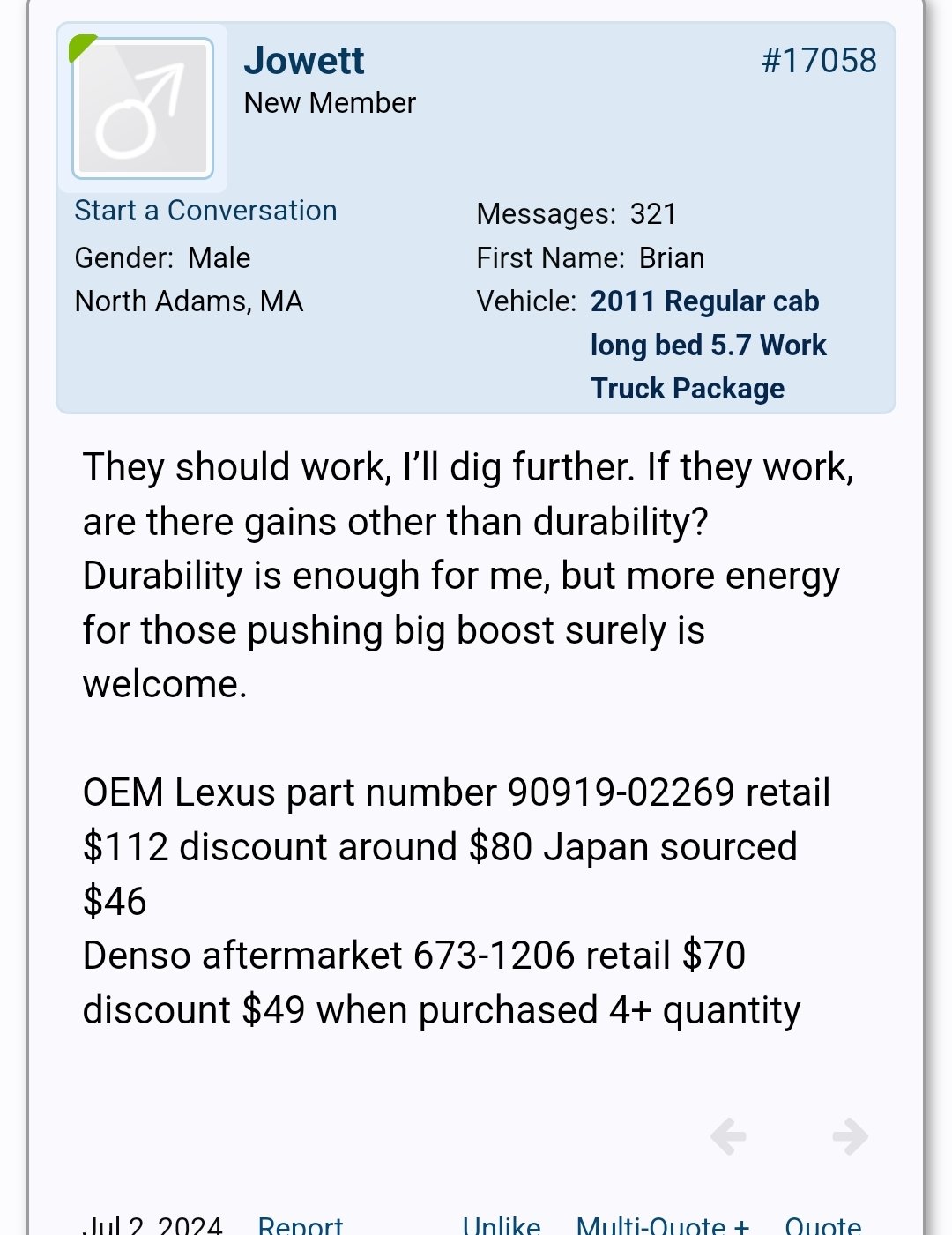

    90919-02269 is the Lexus part number.
    I found 4 at the local junk yard for $50, unknown mileage.. 2 on ebay for $40 and another 2 at a different yard for $60. @e30cabrio got the deal with that ebay seller.

    Thanks for the bump on those 8afrts coils you posted about last year
    Drove around a bit today. They do "feel" better on acceleration, idle, startup and my random misfires are gone.
    I did change plugs a week before but could of been the ngk plugs and old weak stock coils. So it's a bit suggestive and the new designed coil should be a positive benefit all around.
