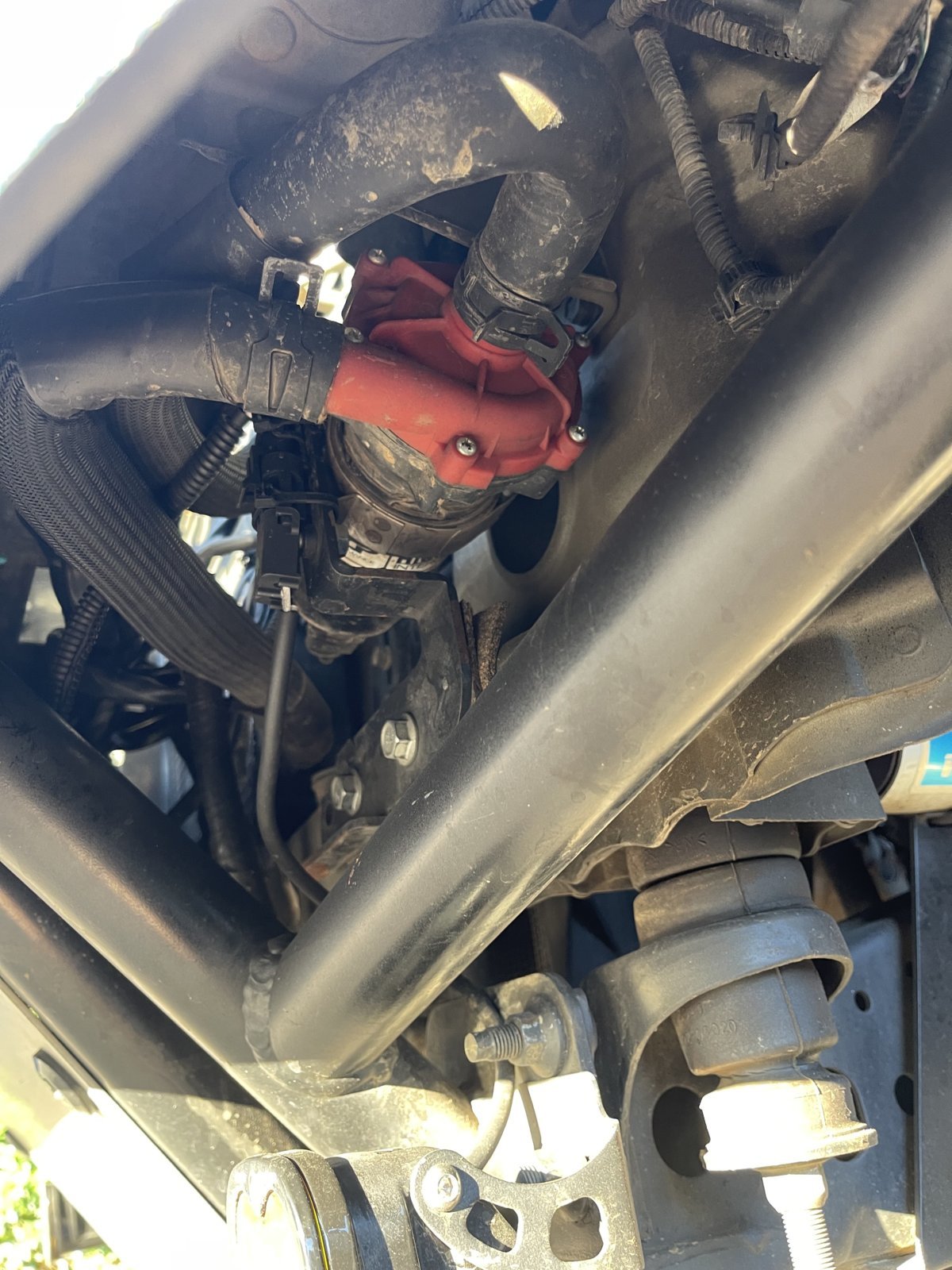

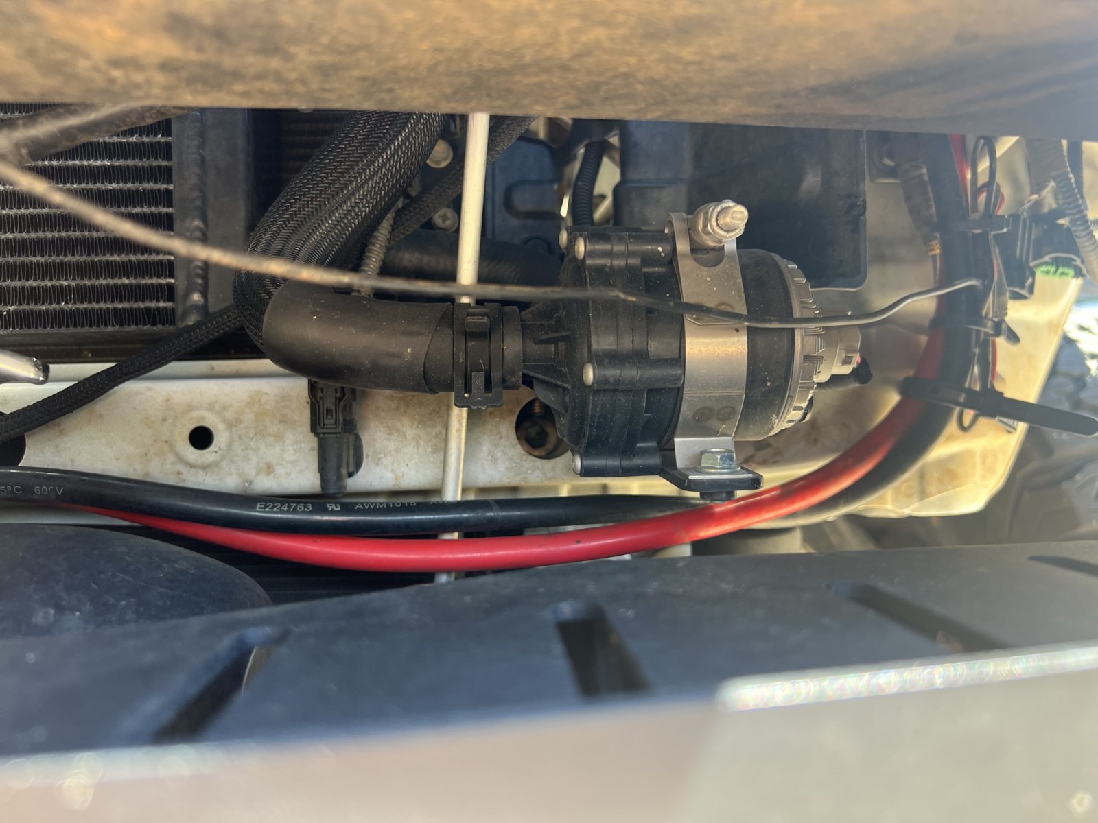

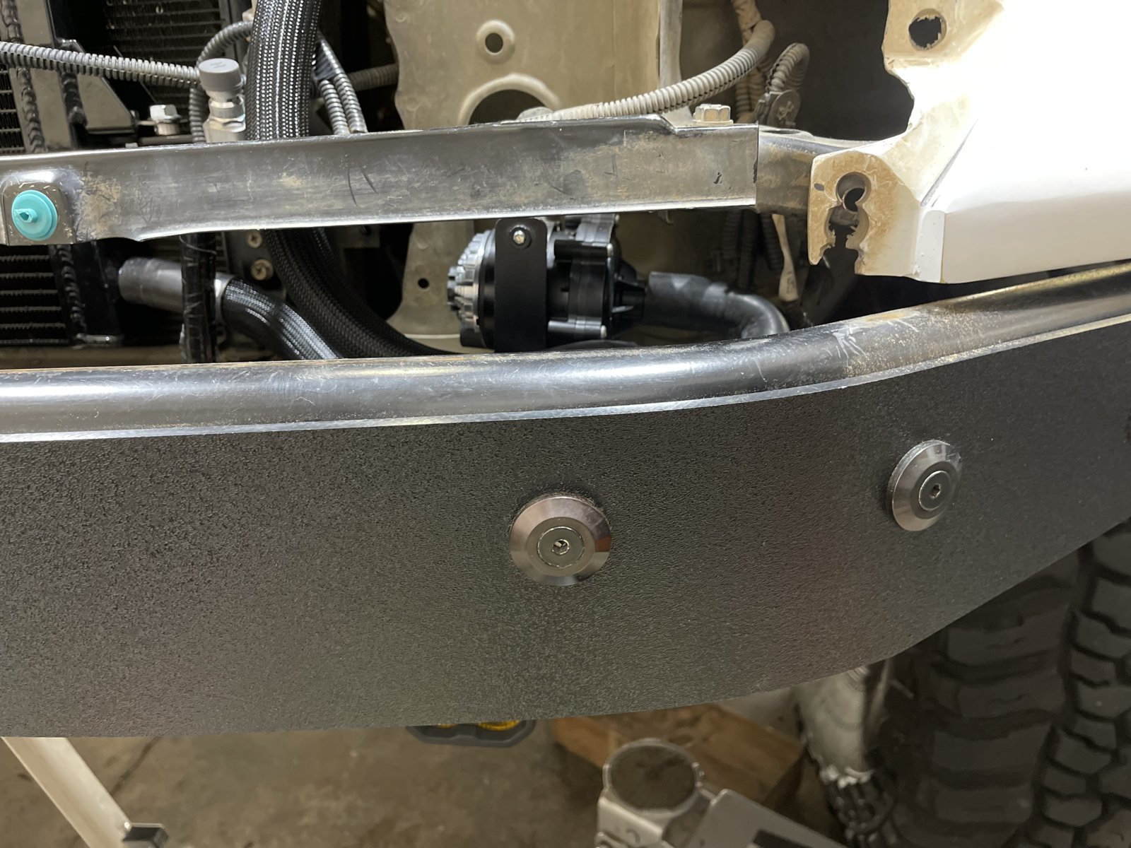

    Has anybody relocated the SC intercooler pump? I seem to recall @PolishedTRD maybe moving it? Any issues doing so? It looks like maybe a little bit of hose and a revised mount.
    I'm looking to make some room up front for a semi-hidden setup and didn't realize the pump is down low by the front frame rail. I'm assuming that's to place it at the lowest point in the system to avoid air bubbles, cavitation, etc?

    Indeed. No problems and was able to keep it at the same level, if not lower, than where it was originally. Unorthodox, but I mounted it to my winch...
    If I were to do it over again, I'd mount it similarly to @reywcms dad's rig.

    I’ve got mine off to the side no issues as well as the old man’s rig.

    That looks right in line with what I was hoping to do with it.

    There it is! I seemed to recall seeing a post somewhere about it. Thanks.

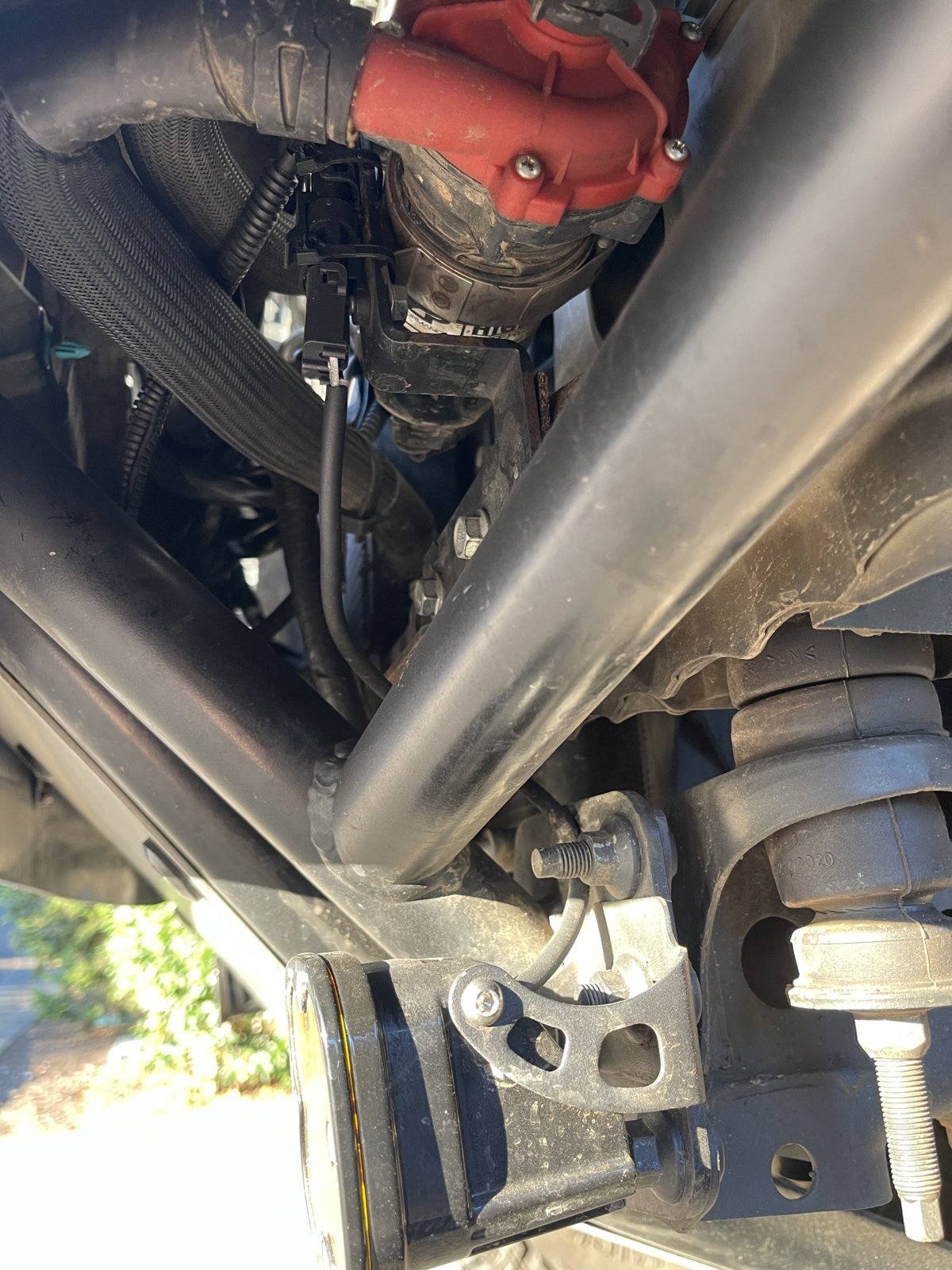

    Couple more pics, forgot I moved to the zzpump.

    Nice. You just reminded me I still have to wire in my new power plug.

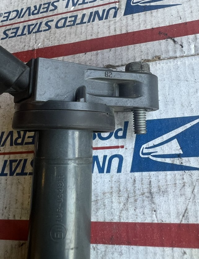

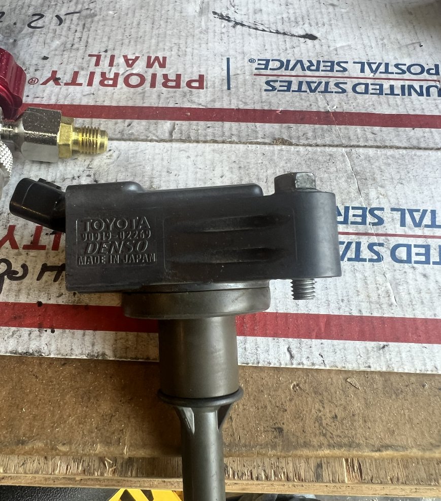

    All 8 are in, truck starts 1/2 a crank (like normal) idle seems smother, didn't drive but all seems normal.
    Here is a bolt comparison.
    Original:
    8arfts:

    Can I ask why you did this?
    If I missed it previously, I apologize. I do a lot of driving and it can be difficult to follow the thread.

    Better ignition coils than factory apparently

    My coils have 142k, new coils are holy shit expensive (for 8) theory is these have more voltage/use newer better tech & it was theorized are plug & play.
    I found them from a Lexus turbo for 15 each with 74 (I think) k miles, & decided to be the guinea pig.
    So far so good.

    Post #12580 from @Jowett describing the new designed coil for the 2.0 8arfts engine.
    I installed them too, after seeing how good of a price @e30cabrio paid, as I have high mileage coils and random non code misfires. These have seemed to help with that and have consistent voltage with no drop. They were designed for turbo charged engines. @Jowett thought they would be a good replacement for the supercharged crowd.

    @Mdl how is the sealing? They fit flush so nothing can get in?

    They fit like OEM.

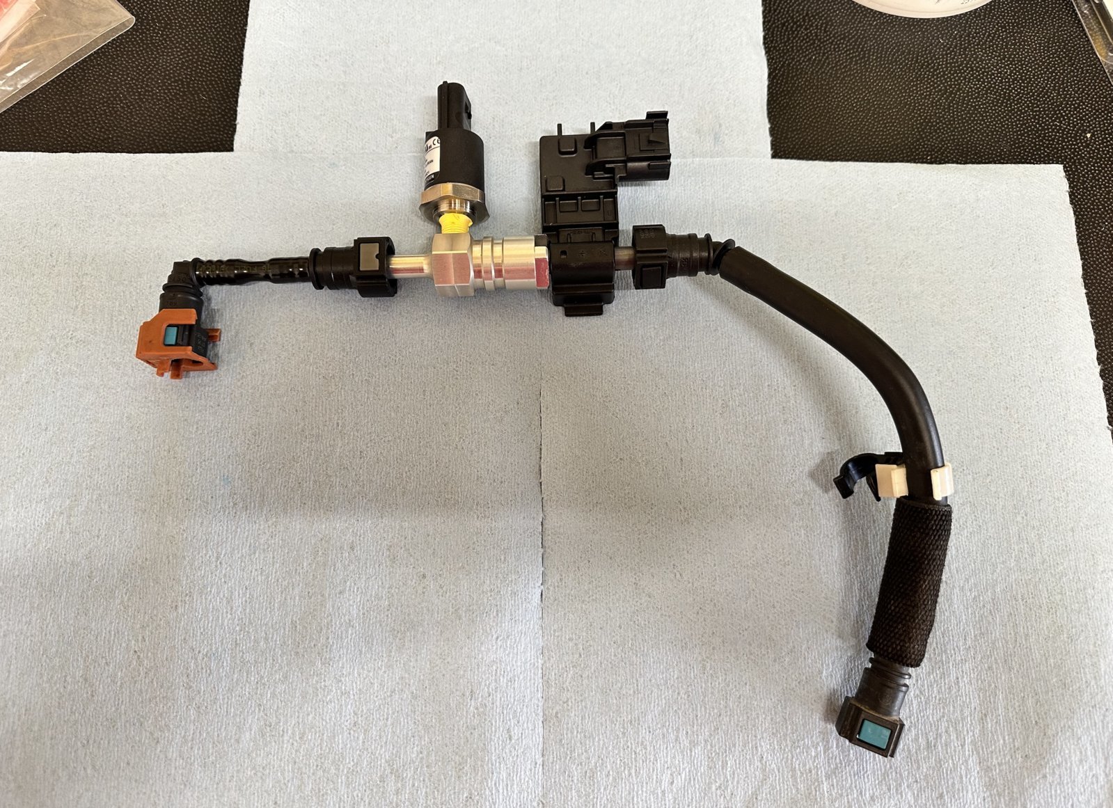

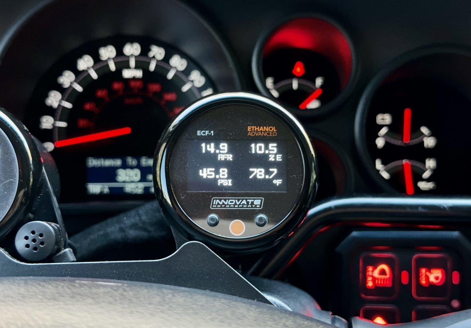

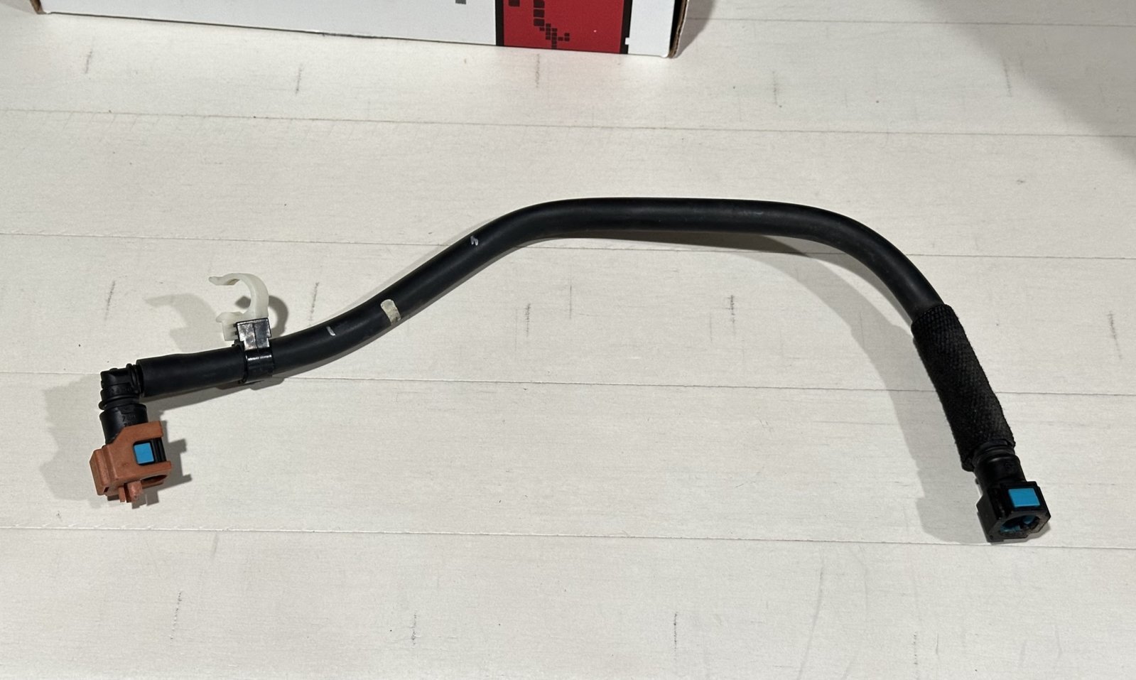

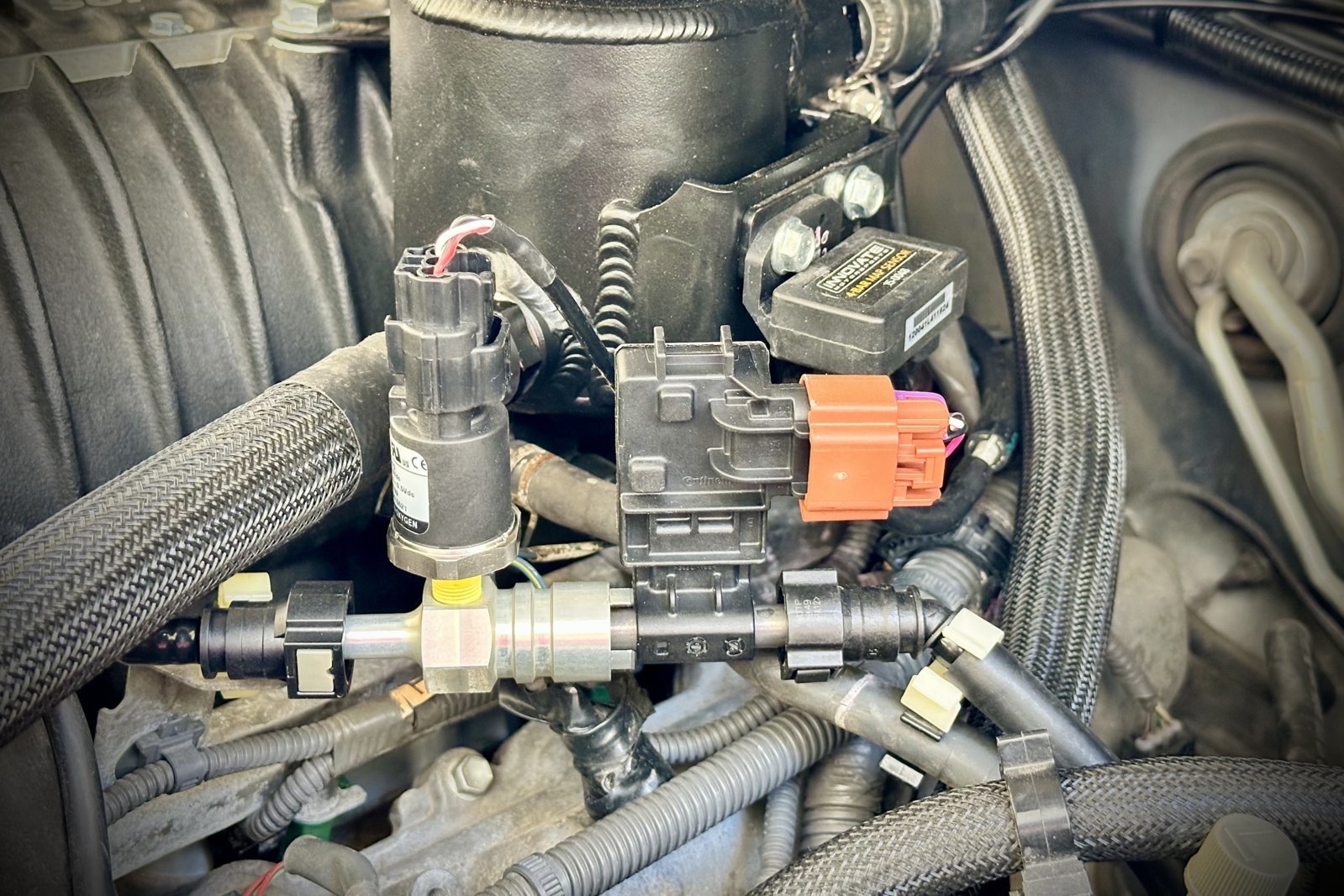

    Speaking of fuel, I've added an Innovate ECF-1 to my gauges. It monitors fuel pressure, AFR, fuel temperature, and ethanol content. Although I didn't necessarily care about EtOH content, the flex fuel sensor is what provides fuel temps. I currently have the ECF-1 wideband hooked up to bank 2 and will have the PSB-1 wideband monitor bank 1 (as soon as I have time to weld in another bung).
    Since both Innovate gauges have an analog out for AFR, and the HP Tuners ProLink+ has two analog inputs, it'll provide for a more informative data log.
    I found it interesting how much EtOH is actually in regular pump gas. I've hypothesized that this is why Toyota sets stoich to 14.6.

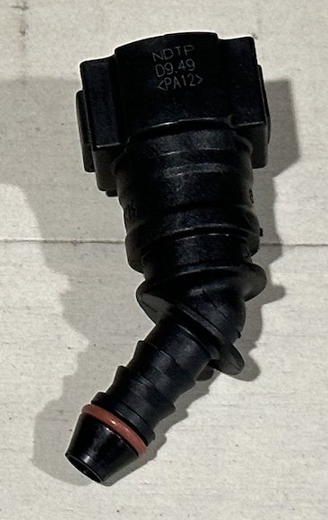

    *If you find yourself needing specialty fuel fittings, I highly recommend Fittings Space, as they have a wide selection, great customer service, and incredibly fast shipping. The male bundy fittings on our trucks (my truck, at least) are 5/16" and the fittings on the innovate sensors are 3/8". The fuel line is 5/16" but uses a 1/4" barb. The barb needs to be for Nylon hose (O-ring at the nipple... sexy). Fittings used to make this work were:
    3/8" Female Bundy to 1/4" Barb
    3/8" Female Bundy to 1/4" Barb 45º
    upload_2024-7-10_12-8-23.jpgupload_2024-7-10_12-8-23.jpgupload_2024-7-10_12-8-23.jpgupload_2024-7-10_12-8-23.jpg

    That is awesome! I wish I had known about it when I got the Autometer Pressure gauge. :(

    Wow that's a cool setup!

    You could use the nx 5/16 fuel adapter with the 1/8 npt port for the innovate sensor.
    Edit: totally missed the post covering the install on the previous page!!
