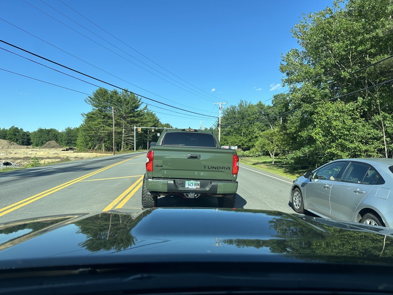

    IMG_4967.jpg So I’ve seen some trucks have a passenger lean to them from the rear, the other day my wife was driving behind me and snapped a picture at a light and said looks like you have a lot of weight on the passenger side because it’s leaning hard and when you take off from a light it looks ridiculous. Has anyone else noticed this with their trucks? Especially since we have more power and the torque of the truck goes in that direction. (The truck has never hauled anything more than a couple hundred pounds in the bed and has only towed a seadoo.)

    Looks more like road crown to me. It has been argued that the factory tundra lean, which is on the driver's side due to driver, battery, steering, and gas tank, is countered by road crown so the stock vehicle rides level on the road. But when we get rid of the tundra lean with a leveling kit or other means, we get a passenger side lean due to road crown.

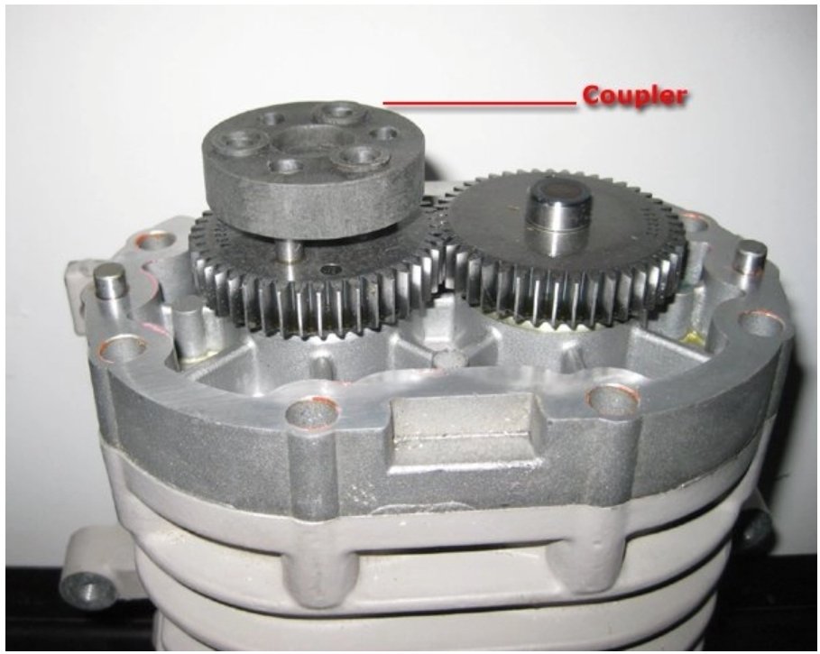

    With regard to the supercharger coupler replacement topic ... what does this group recommend for how to remove the coupler and how to press the new one on?

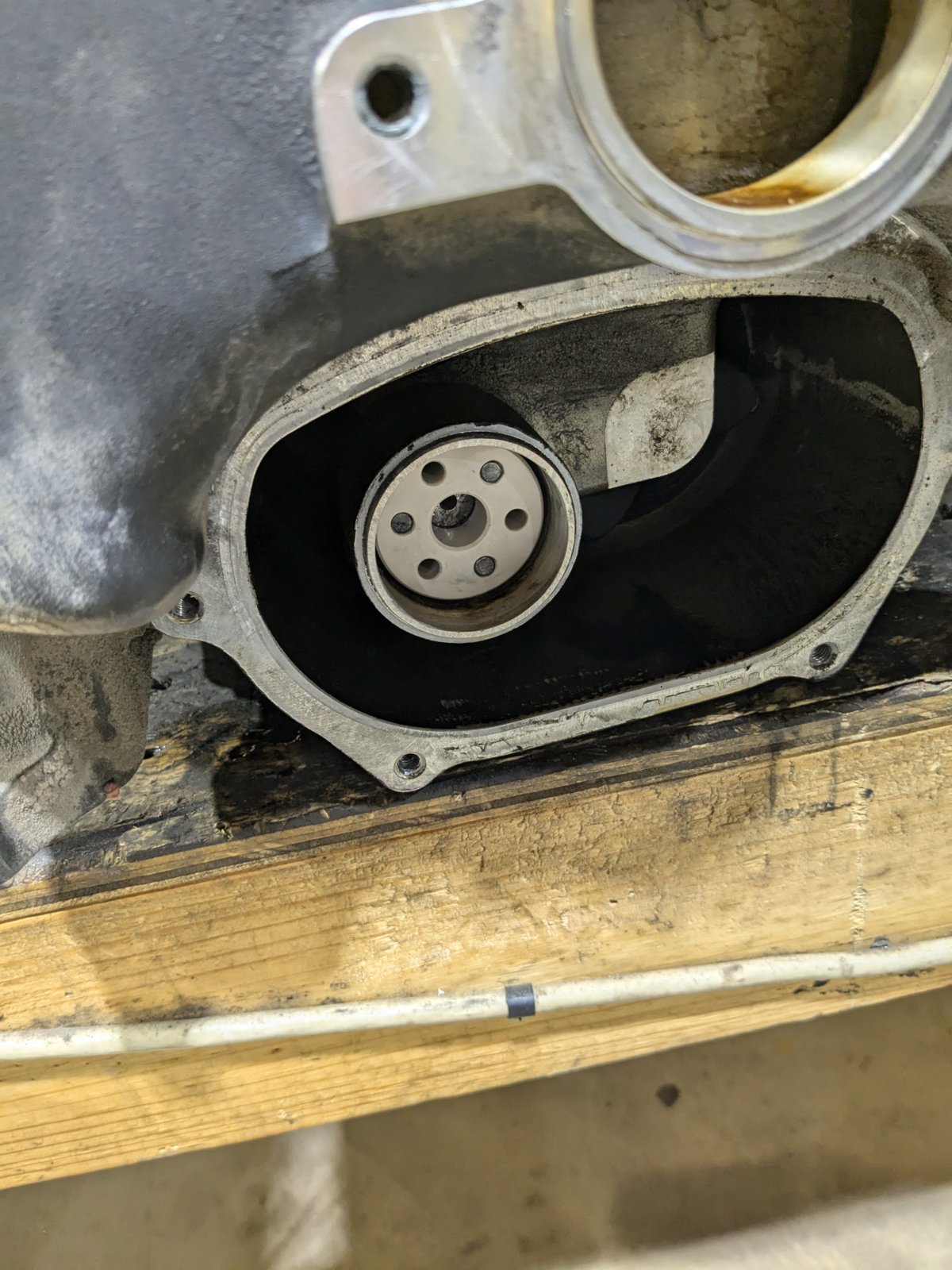

    It just slips on opposing pins from snout and rotor pack. Some will loosen the blower on intake enough to lift front snout to get at bolts. Some will take water crossover and idler pulley off. Don't drp the snout bolts in center section...its an abyss!
    Similar design...

    I don't think it's road crown. The OEM driver springs compensate for all the driver side weight already.
    There are multiple threads with people posting their truck parked on perfectly level surfaces showing the same thing. Almost every single Tundra parked on a level surface will have a rear passenger bedside that sits lower than the driver side and a passenger rear wheel that sticks out (looks like it has less positive offset) than the driver side.
    My speculation is that this is from the one-wheel-peel torque of our open rear diff that puts more strain on the passenger side leafs and pulls the axle out of alignment with the frame. Any bed alignment issue will exacerbate the visual asymmetry. Toyota even compensated for this by placing the upper rear shock mounts opposite each other (one forward and one behind the rear axle).
    I wonder if a SC and the factory open diff would make it worse as well...

    It can be a bitch to get out. Need one or two sizes of prying tools to stick in the center bore and then work around and pull it off. I like to undo the blower bolts and angle the nose up and then the snout can be unbolted, then you don't have to screw with coolant but both options kind of suck. I put grease on the pins to try and help pull it off in the future.

    Like anti-cease? I've read a lithium grease is also used...

    Either or. I use whatever grease is in the gun :D anti-seize would probably be fine, though I usually only use that for metal on metal contact.

    I haven't taken a snout off ... is that really as easy as it seems? Like, once you have access/all the bolts off, just tap it with a rubber mallet and wiggle it away from the housing?

    Yup. There's 6 bolts, and they're (nearly) impossible to reach without moving the coolant crossover or tilting the whole supercharger up. Once they're pulled hit it with a mallet a few times and it'll wiggle off the coupler and that's it.
    It wouldn't hurt to grab the O-rings too but isn't mandatory. You can get a snout O-ring kit, that includes the two O-rings that go between the snout and the blower body as well as the throttle body O-ring.
    Pry the old coupler off, throw some grease on the pins (three on the blower body, three on the snout), tap the new coupler on, line up the pins as best as possible (which is half way luck) and tap the snout back on. Six bolts back in, and you're off to the races.
