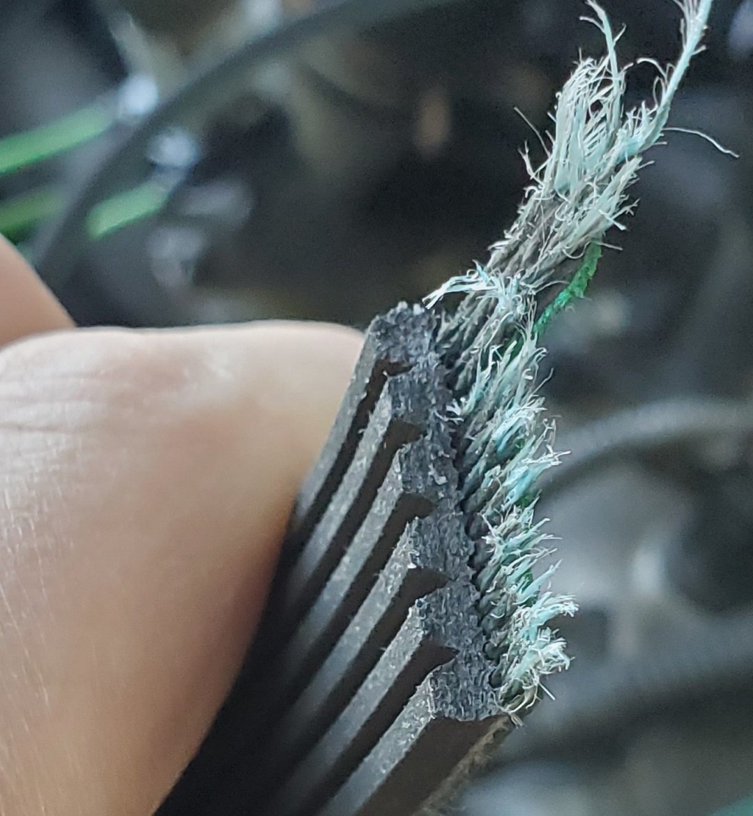

    Well I just had my 2nd serpentine belt eaten by my AC pulley clutch with 90 deg weather. Not sure if it's my belt tensioner causing slack when I get on it. Luckily I was 5 miles from home and had my e-fan on. But...it boiled right when I pulled in my driveway.
    Hopefully its ok. Temp came down right after I shut down and kept fan on.
    Ordered another HD Gates and tensioner...freaking uncool!

    Are you running a small pulley? I don't know if I've ever seen such a clean belt failure. Is the smaller radius causing premature failure?

    I don't think the smaller radius is causing it. @snivilous and @Fastlane47 are running the smaller pulleys without incident. My first failure was an older Dayco with the cable reinforced belt. It was wrapped up inside my AC clutch.
    I ordered another Gates and New Old Stock Dayco. Will run the Dayco with Gates as a backup.

    Check all your pulleys to make sure you dont have any burs. If youve got through a few belts already something may be cutting into them forcing them to snap

    I looked them over and didnt see anything that stood out. The only thing I can think of is under hard acceleration the tensioner could be giving slack or?
    The first one was from a seized idler pulley bearing.

    Did it ever do this before the small pulley? Is this the first belt to shred on the small pulley? Have you ever replaced the tensioner?

    The first belt, Dayco, was on the 2.3 pulley. I had the SC idler pulley seize up and belt shredded.
    This Gates HD belt on the 2.0 pulley snapped after I went about 50% throttle. The belt was 6 mos old. No...tensioner had 130k on it! New one is on order with another belt.
    I believe it may be the tensioner.
    The belt is smooth and has a pretty clean break. Defect with tensioner?

    Hopefully! I always tell people to run a new belt if stepping down pulley sizes just to remove any stretch from a large pulley. Would make sense that a tensioner that has been worked hard with a tight belt could have issues keeping up when there's less tension on the belt. Plus couple that with the small pulley loading up the belt harder from driving the blower so fast. Seems plausible it's making the tensioner slap and shock load the belt.

    Thanks! The belt was about 4 mos old going to the 2.0. I'll check out the condition of all the pulleys and swap out the tensioner!
