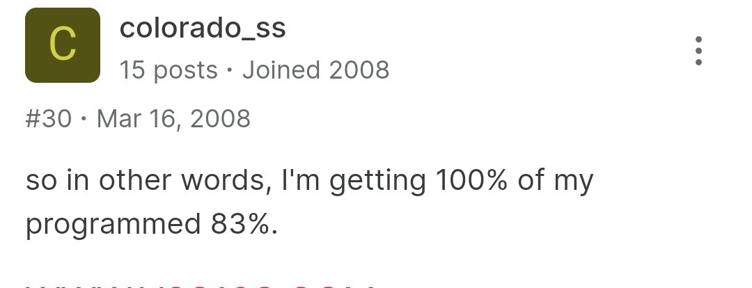

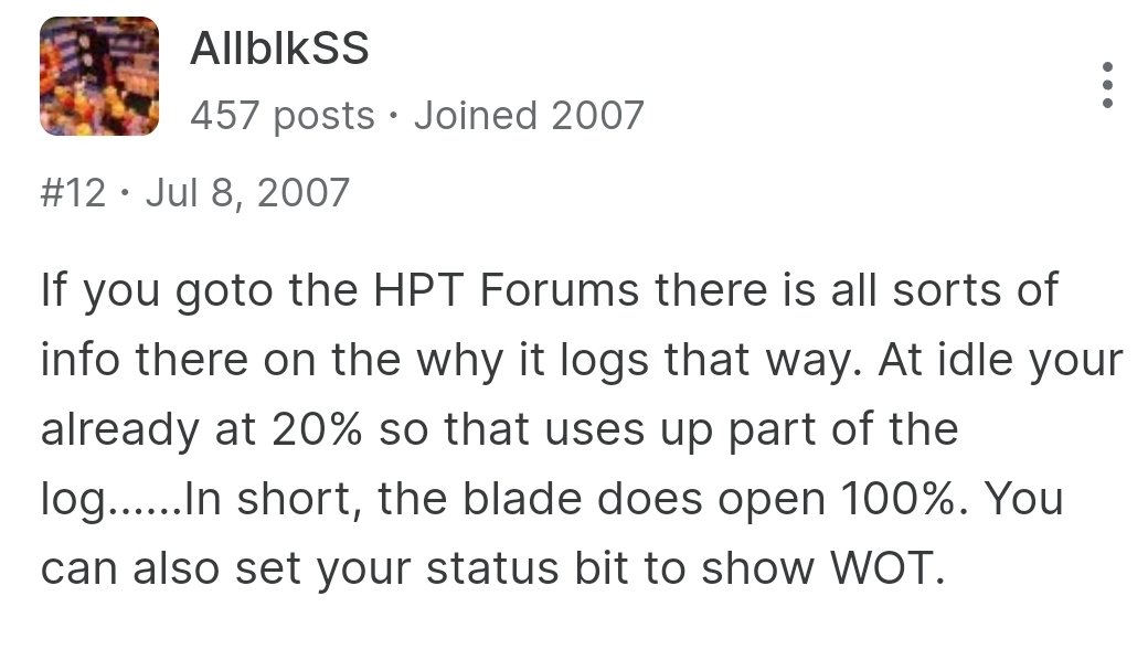

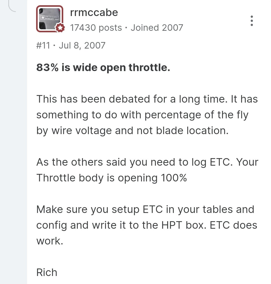

    So I was talking about a Banks Pedal Monster, not the Pedal Commander. I had one for a short while and found some of the same dislikes. I got lucky with my truck and the pedal was just about perfect off the lot; my sequoia, OTOH, has horrible pedal feel. I agree about the possible safety issue with the Pedal Commander pulling voltage off the pedal circuit itself (which I believe is the ECU) instead of an auxiliary source.
    You are correct in my implications of pedal controller total output not being able to exceed the the 100% pedal limit.
    Reason i was thinking about the Banks unit is that it pulls power from the OBDII port which is more robust than the ECU pedal circuit. I was wondering if there is some sort of voltage drop through the ECU/pedal circuit. I'm still a little baffled as to why my pedal only reads 93% at WOT when running, but with the engine off it will read 100% no problem. I figured I could change some settings around on the Pedal Monster and monitor/graph the pedal vs throttle to collect some data and compare. I know it prolly wouldn't directly answer my question, but I like to tinker and try to figure stuff out. And after saying that, I'm still struggling to figure out a good pedal map for my truck: it's a little jumpy in spots, and in the winter that can make for some hair-raising experiences (a hair too much pedal and an unexpected downshift on the freeway to drop mad torques to wheels just when the road went from wet to kinda icy makes for walking sideways a 70 mph...). I realize the Pedal Monster would most likely exacerbate it, but I can see how it behaves on two different vehicles and try to make some assumptions.
    Awesome info! Much appreciated! I do notice that my throttle position shows as 16-20% at idle; I assumed it was a voltage offset or some such that just read that way, so it makes sense that perhaps the TB doesn't require 5v to open completely, but does it at some lower voltage such 4.8V, making the sensor read less than 100% while logging.
