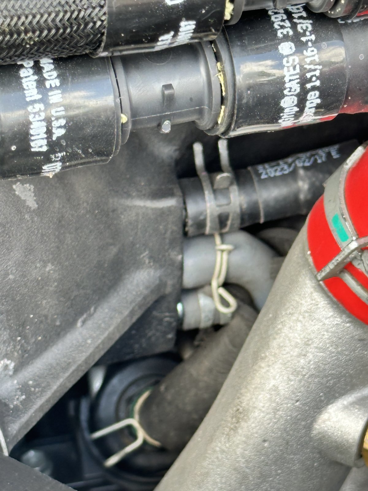

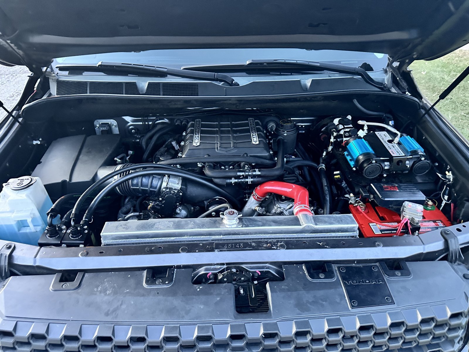

    Can anyone tell me what hoses are the pcv and crank case in and outs on these pictures ?

    PCV goes from the green fitting under the supercharger to the supercharger, PCV catch can should go between those.
    Crank case goes from each valve cover to the Tee fitting on the intake, Crank case catch can should go between those, although nobody gets any oil on that side, and you can skip it.

    so line in from catch can goes to crank case then line out from catch can goes to T on the intake ?

    From PCV to line-in on catch can, line-out to supercharger
    From Crank case T-fitting to line-in on catch can, line-out to intake

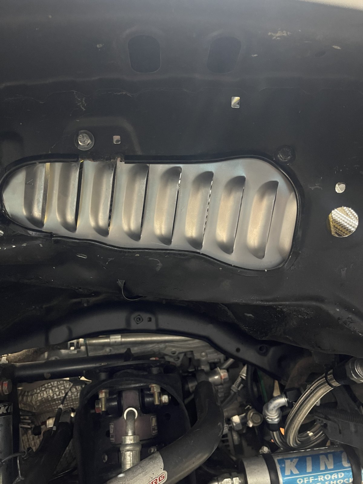

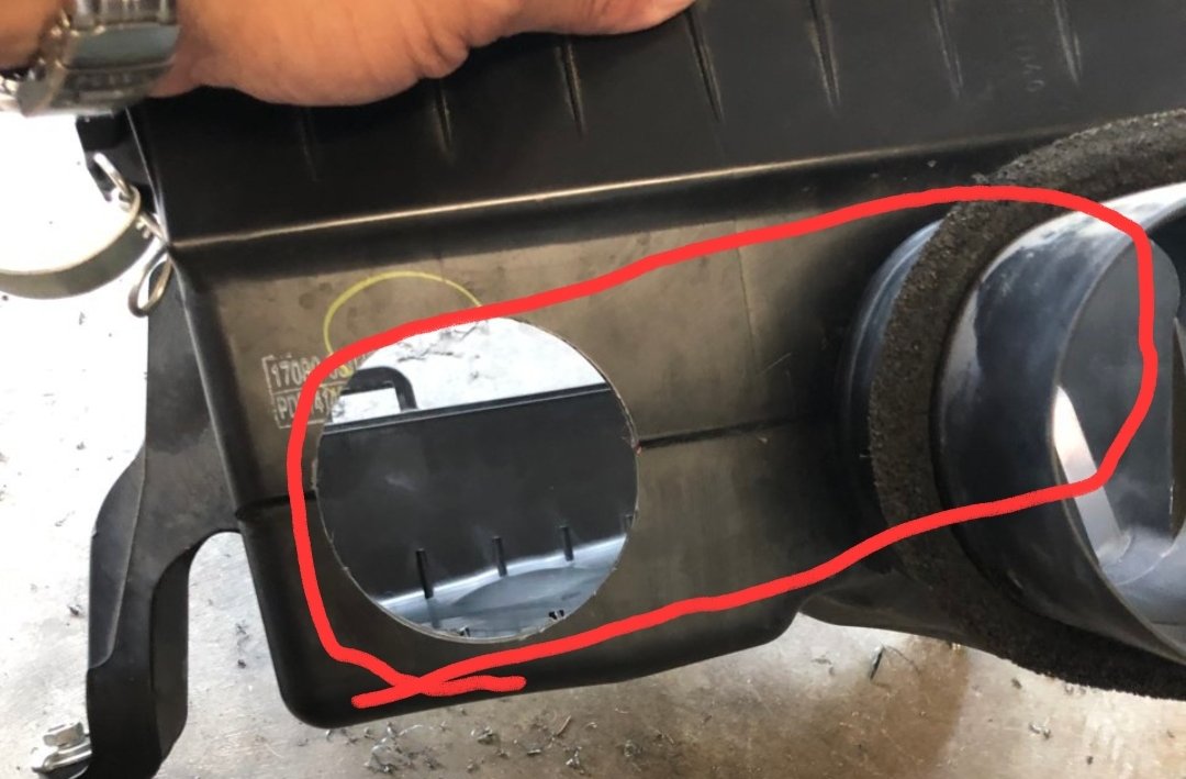

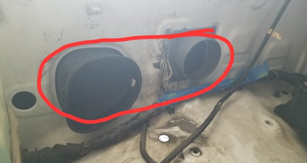

    @reywcms what material did you use for venting the prospeed out to the fender intake area? Assuming you still havecthat setup.
    I was thinking of cutting my lower airbox from my sabm to the air accelerator. Creating a 10.75 x 3inch opening to both fender and lower airbox. Was thinking of using aluminum flashing as a mold to lay some glass work for the air inlet between the two. Would have the fender lip sealed with rubber u channel and screen covering.
    If it's even worth it?

    Yep I cut that whole area out and combined them. I used hotrod louvers and faced them towards the front. Nutserted and bolted then painted black. Then used foam to cover the gap from the lid to the wheel well. Your flashing should work well to fill that gap like you mentioned

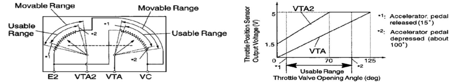

    Throttle butterfly can sweep 100 degrees. A picture will explain what you are seeing a little better. 1B8666F0-AB63-4CFB-81C2-ED4A4F4F700D.jpg
