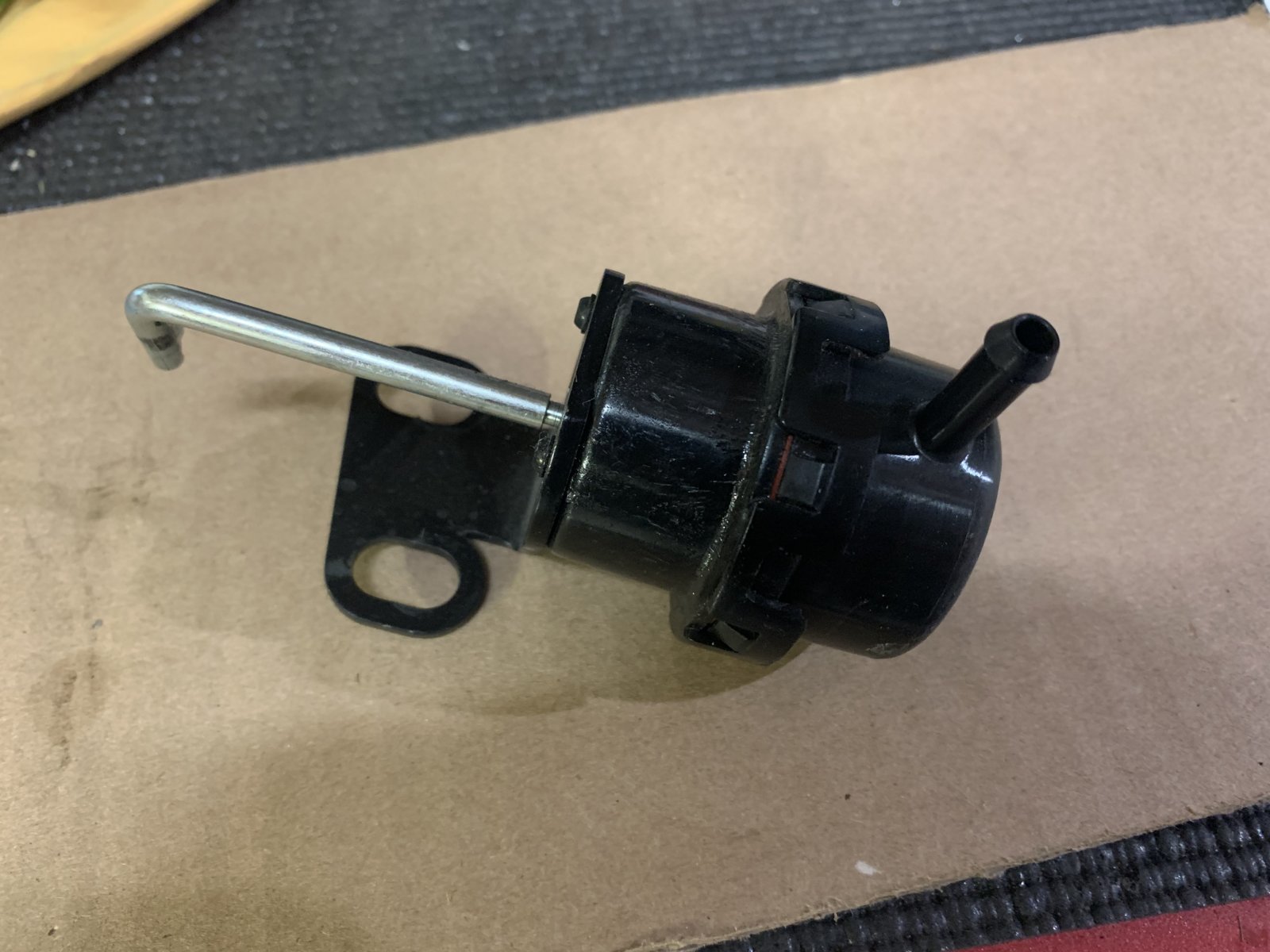

    I have a friend who bought some weird old Mercedes, bunch of quirks. He takes it for a test drive, and gets back to the dudes house and pulls the key out and it doesn't turn off. He's like how do I turn it off, and the dude goes oh here. He pops the hood and grabs a hose and starts sucking on it and the engine dies. Apparently this was standard operating procedure for this dude to turn the car off :rofl:

    You gotta ask yourself how many other things he sucked on before he discovered the right hose.o_O

    I strongly suspect that @snivilous was on the right track.

    I assumed the 2nd nipple was for atmospheric reference or something of that sort.

    Milking.
    You can milk anything with nipples.

    https://www.northamericanmotoring.c...ass-valve-theory-of-operation.html#post336228
    Good explanation and discussion of bypass operation and the restrictor. On demos of a bypass valve it slows down how quickly the diaphragm moves from one state to another.

    I think both @snivilous and @Silver17 are correct.
    I think it is there if you needed additional control of the valve. Vacuum actuated bypass seems to be a problem for big cams, more overlap so they create lower vacuum. If you wanted to control the bypass referencing throttle body position or delay opening/closing above/below certain speeds/accelerator positions.
    There are electronic type controller that go inline with the vacuum reference valves which I suspect they are acting like a variable restrictor (the brass nipple we've been talking about the last few posts) but there are others that control the valve using the atmospheric side. Can't remember the name of the product but someone posted the listing some months back.

    Bypass valve actuator from a Whipple.
    M3Tundra-JK and Wynnded[QUOTED] like this.

    Was there a brass orifice?

    If I recall correctly I remember him mentioning the mounts were breaking. If that is the case I wonder if there is a way to reinforce them. He and his crew probably torture test them with all the jarring.

    Not that I saw. That's how it came out off the blower; the new replacement didn't have a brass orifice either.

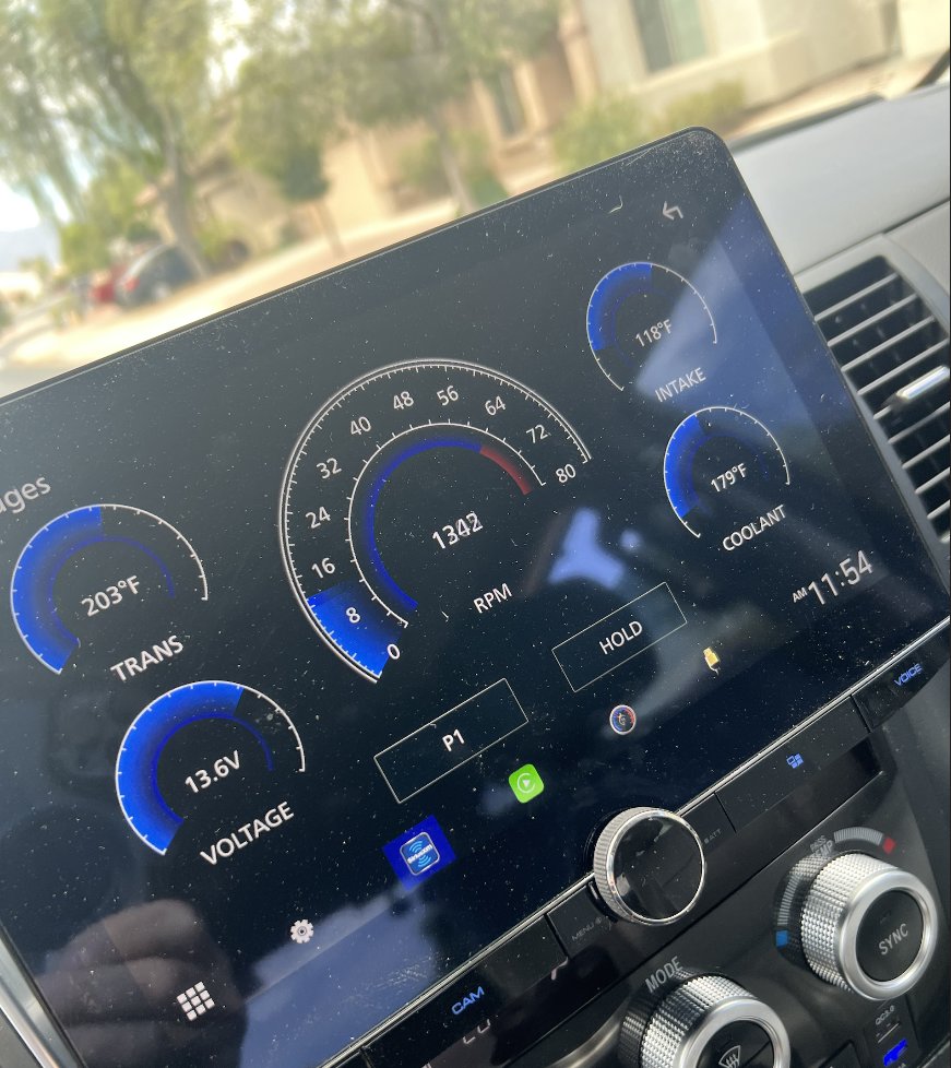

    I just installed a Mishimoto aluminum radiator. Before I ran at 196-206, now I am running at 177-181. It has been 111 to 115.
    I also have a large aluminum SC coolant heat exchanger.

    I did the CSF radiator and drove from Oklahoma to Abilene in 110 heat on a brand new super charger and it was cooling like a beast. I also upgraded the hoses (HPS) they are 3ply withstand heat up to 350F. Hoses definitely worth it, I honestly think if your going to do the super charger just replace the stock radiator.
    fyi I was pulling a 7,000 pound boat going 75-80mph.

    I'm guessing you don't have a real gauge to monitor actual temps?
    Ive seen 235* on my sgII, yet the dummy gauge never moved.
    I'm hoping those temps are more reasonable with a SCer.

    I was definitely 235+ logging through hptuners. That supercharger needs every bit of cooling you can give it. I noticed my trans temps were little high as well. Also, for some reason I really think headers help a fuck ton and just hear me out. My truck literally sits at 2300rpm maybe -2 + 2 psi and is smooth as a rock at 70-75mph. Idk if the additional air flow coming out makes a big deal but it sure seems like it with a super charger + header combo. Feel like I am driving a semi truck haha… really need @snivilous tune my truck

    I have access to the gauge via my head unit and iDatalink maestro, but I’m limited to four gauges plus the speed or tach. I was alluding to the contrast between the dummy water temp gauge and the dummy transmission temp gauge - I’ve seen the dummy transmission temp gauge move before, which is why I started monitoring actual temps via the head unit. I don’t typically monitor water temps anymore since they didn’t change more than 10 degrees. Now with the SC I plan on watching water temps again but it’s constructive to hear what others see for temps. Upgrades sometimes needs upgrades :)
    But, ya, I realize the dash is dummy gauge..
