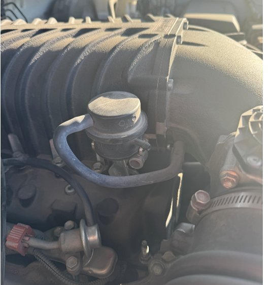

    I can't keep track of who has what. So, if you're running a TVS 2650 Whipple/Harrop, please check for the orifice at the bypass and report back please. Two units not having one is a coincidence, more becomes evidence/confirmation ...or some such :p. Thanks!

    I just noticed that your bypass has....uh, two nipples. I wonder what the unconnected one's purpose is.

    Looks like it's on the other side of the diaphragm, so presumably if you want to actuate it with positive (increasing) pressure as opposed to sucking on the top one :D

    I guess that as long as the end result is the same, the approach isn't as important, huh? :rofl:
