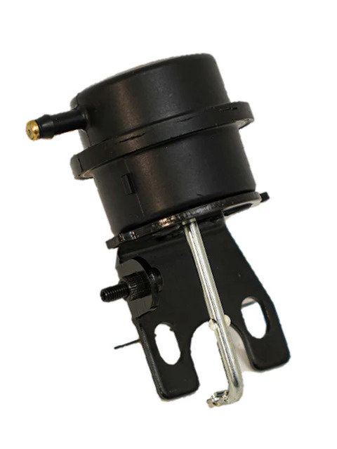

    I mean the brass restrictior. Been out for a while.

    I opened it up by 2/3rds. I just drilled it open at each pass from fully opened to where it is now. Did it back when it was discussed some months ago. Probably should just remove it...

    Tvs1900. I believe the 2650 has one too. Bottom of bypass where vacuum hose attaches.

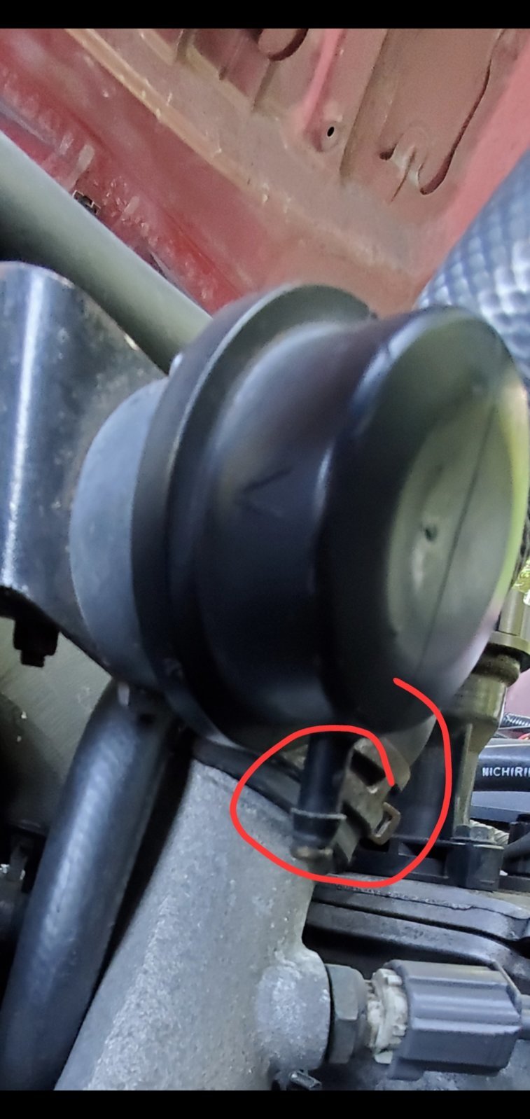

    I just went out and checked my TVS2650 and didn't find one in the same location as there was on my TVS1900, at the bypass valve. If for some reason it's in the other end of the vacuum line, I can't get to it with the blower installed. The hose goes from the bypass just above the stock Fuel Pressure Regulator, behind the throttle body to somewhere under the front of the blower where I can't see, nor fish my hand.

    I looked overvthe magnuson site should have a .035 orifice at the bypass. Could of looked at a different one by mistake...

    So what exactly does removing the restrictor do? I just checked and I have one.
    " Remove it for better overall vacuum at idle and cruising, better bypass valve functionality (now moves as quick as the throttle body can) and better boost consistency. Added bonus is you gain back boost you should have with the pulley in place"
    Trying to comprehend what better overall vacuum does as far driveability. And also, will it boost more, it says you gain boost.

    You will have boost build up quicker, not a gain in psi, and it could feel a bit touchy when accelerating. The restrictor just restricts how fast it will ramp up or down based on vacuum. You may like it or not.

    You're looking for that little brass orifice that looks a lot like a carb jet once you remove the hose from the nipple. Or it may stick in the hose, or fall out to never be seen again.
    Now that I've thought about why mine isn't there, I think that I likely removed the hose to get it out of the way when I was installing my fuel pressure regulator and it probably fell in to some cranny.
