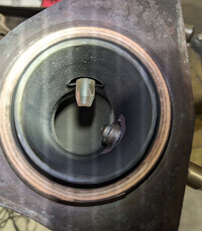

    The sensor is mounted after the cat on bank 2. I'm kidding. The bung is roughly 6" downstream of the truck's wideband O2 - so about 10-ish inches from the header flange, on bank 2. I'm open to suggestions for placement on bank 1 (adding a bung with the addition of the ECF-1).

    Did you use the bung that Innovate supplied? IMO it's too tall, and the combination of that and the offset from the truck's sensor might be your issues. I cut the bung supplied down a LOT

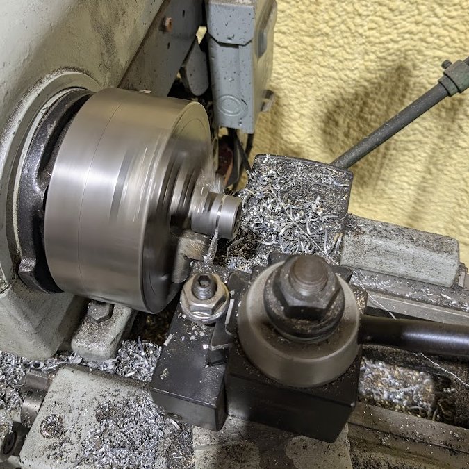

    Without cutting it down the O2 sensor ends up about flush with the end of the bung, so flush or a little set back from the actual exhaust tube, kind of like those O2 spoofing devices. With it cut down this far the sensor is well into the exhaust stream, similar to the stock sensor:
    Not to say there's any issue with how yours is setup, but MAYBE that's contributing? And food for thought for your new sensor placement then.

    I used the tertiary bung provided on the SPD exhaust, which appeared to be shallow. And thank you for pointing that out about the Innovate, as I was thinking it was too tall as well! I'll have to hit it with a deathwheel or grinder before install.
