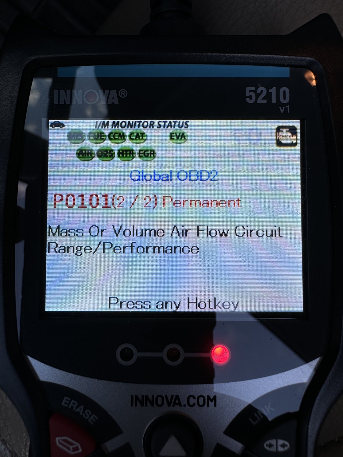

    Well, just threw another P0101 code. This is the second time in the past year although I haven’t been driving it much over the last few months. Is there any way to convert MAF lb/min to volts? I’m assuming not. I believe I exceeded the 5v limit triggering the CEL. Perfect timing too as I’m due for emissions testing. :facepalm:

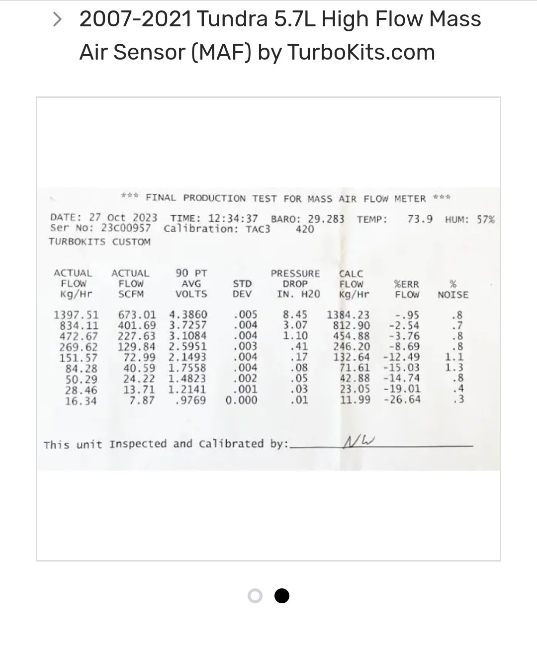

    Would the @TurboKits.com MAF be the solution for my P0101 codes? This would also require a retune with the new MAF right? I don’t currently have a way to data log to check the MAF voltage - I need to get another laptop for this since I had hptuners installed on my work laptop and it was replaced recently. The new work laptop has less permissions and I can’t install any programs. Hope everyone else’s weekend is going better.

    1. Yes you can convert flow rate to volts. Pull up the MAF graph for your tune and you'll see flow rate and the corresponding voltage.
    2. If you can view flow rate you can view voltage directly. If anything you should be able to view voltage because flow rate is derived from voltage based on the MAF table, the voltage is the raw input from the sensor. If you have an OBD2 scanner it should just come up as MAF Voltage I think.
    3. If the code is thrown it doesn't really matter either way. It's hitting 5V most likely.
    4. TurboKits MAF will fix it but require the tune updated, which is easy.
    5. If it only rarely does it, I would NOT worry about it. Throwing the code doesn't do anything. Maxing the voltage most likely doesn't do anything. The truck will use the last known MAF values (is the 5V values) for all the calculations past that. I've done lots of tunes where the MAF maxes right at the top end and it makes no difference. Hell I've had lots of people where the MAF maxes below 5000rpm and you can live with it. If it's a rare occurrence, just clear the code and don't sweat it. The truck won't run any differently after it has blown the code. For all the hassle to "fix" it's probably easier and certainly cheaper to just ignore it.

    I’ll try not to let my ignorance show here, but 0-5v is the voltage range for any MAF hooked up to the stock ECU. Many vehicle sensors are 5v. Whatever MAF you use will max at 5v, but the physical airflow required to reach that limit differs - like a heavier spring sags less even though the max suspension uptravel is the same.
    The stock MAF will only read ‘x’ amount of airflow whereas the TurboKits MAF will read ‘2.5x’ airflow (those are hypothetical numbers BTW). You can swap in a MAF that is built differently for more airflow before maxing out voltage, or you can increase the intake diameter which effectively slows down the airflow. This requires some software changes to rescale your MAF voltage/Flow rate to let the ECU know the MAF signal means more air flow than the stock intake size. That is what I did - change to the Magnusson upper intake lid with a larger diameter tube where the MAF resides - so that I could increase pulley size while staying below MAF voltage threshold with more airflow. I’m at altitude so the beast needs more air volume since it is less dense.

    Email @TurboKits.com since their website seems off. I had a guy a week or two ago say the same thing and then he ordered one and got it two days later.
    Now where "issues" start to happen is that the ECU can only read that max airflow value, so you may require physically more airflow to reach 5V like @blenton said, but you can't tell the computer that. Which at that point is when you need to scale the injector constant like you described. For example if your current tune reads 512g/s at 5V, and the TurboKits MAF requires 30% more air to reach 5V, you can't just scale up that 512g/s number in the MAF table since it's maxed, so instead you'd want to scale the IC up by 30%.

    The MAF takes a slice of air and outputs a voltage. That voltage is based on some type of measuring, say a spring deflecting. Regardless the max reading is 5V. For a stiffer spring in the sensor you need more airflow to hit that same 5V. The stock spring needs so much airflow from that slice of area it's measuring to hit 5V, and the TK one needs 30% more air to hit that same 5V using that same slice of area.
    Compare to a larger intake, where that slice of air is smaller (relative to the total intake area) so now the amount of air hitting the MAF is less, thus less voltage reading at the same airflow.
    So the TurboKits MAF needs more airflow to hit the same voltage, where as the larger intake has the same effect but by physically reducing the airflow on the MAF.

    P0101 is actually not the code for exceeding the 5v threshold, that is P0103. PO101 is more likely from a dirty or failing MAF sensor, air leaks, turbulence, or poor MAF tuning as I recall. I used to get it as well, and it never happened WOT or near redline which is where it would happen if I was exceeding the 5v limit. I know I kiss 5V even still with the magnuson intake but I no longer get P0101. I attribute it to the air straightening honeycomb before the MAF as well as the tune surrounding the MAF tables being spot on.

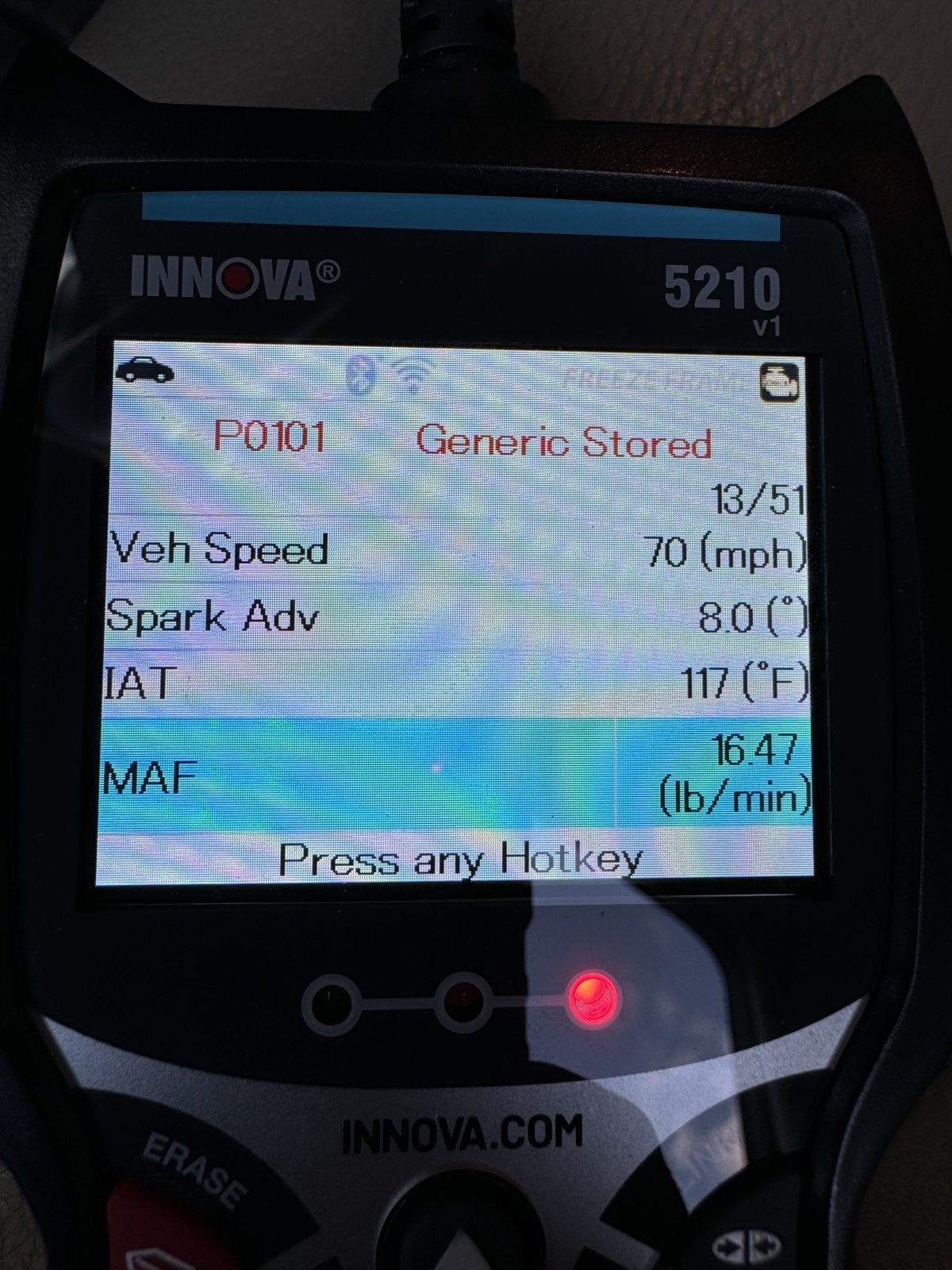

    I didn't think 16.47 lb/min was at 5v.
    I occasionally got a p0101 at low rpm just after startup about 5 miles down the road at 20mph on a hill. It took a few tune revisions but was a discrepancy with my airflow/ voltage after going to a 4.5 inch intake.

    That makes sense. I haven't seen this code since installing a new MAF sensor. Old one had a cracked screw hole so I attributed air was getting past the gasket since it wasn't tight. No code since then.
