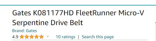

    Any Harrop owners with smaller pulleys...what belt size are you running? After installing the 77.5mm pulley, I'm having issues with the Gates K081177HD slipping, and I can't get the K081153HD onto the pulleys. Any other options out there?
    77.5mm + K081177HD with stock tensioner slips and squeals like crazy, but belt stays on the ribs
    77.5mm + K081177HD with Harrop tensioner makes clacking sound and belt starts walking off the alt pulley (I did this multiple times, resetting the belt every time)
    85mm + K081177HD with stock tensioner works, only slips during shifts
    Stock belt size w/o supercharger works with both tensioners, belt stays on, no pulleys out of alignment or strange noises.

    I use this green one....no issues.

    What size pulley? That one works great for my stock 85mm, but slips and squeals with the 77.5mm

    I still have the original provided belt with the kit on mine with the 77.5, no issues. I keep the gates green fleetrunner in the truck to go on when this one fails.

    77.5mm it's been on for a few months.

    @armyoffoo are all the rest of your pulleys OEM size? Seems odd unless your stock tensioner is very weak perhaps? I only have 67k on my truck so my tensioner may have more bite depending on your mileage.

    Yes, everything else is standard size, 56k miles. I was using the K081177HD belt for a while now, I've got a new one being delivered today. I can run the 85mm pulley and be functional, but I want the boost!!

    I’m also running the K081177HD on my 77.5mm with no issues. Going to a 75mm pulley when that comes in from Harrop.
