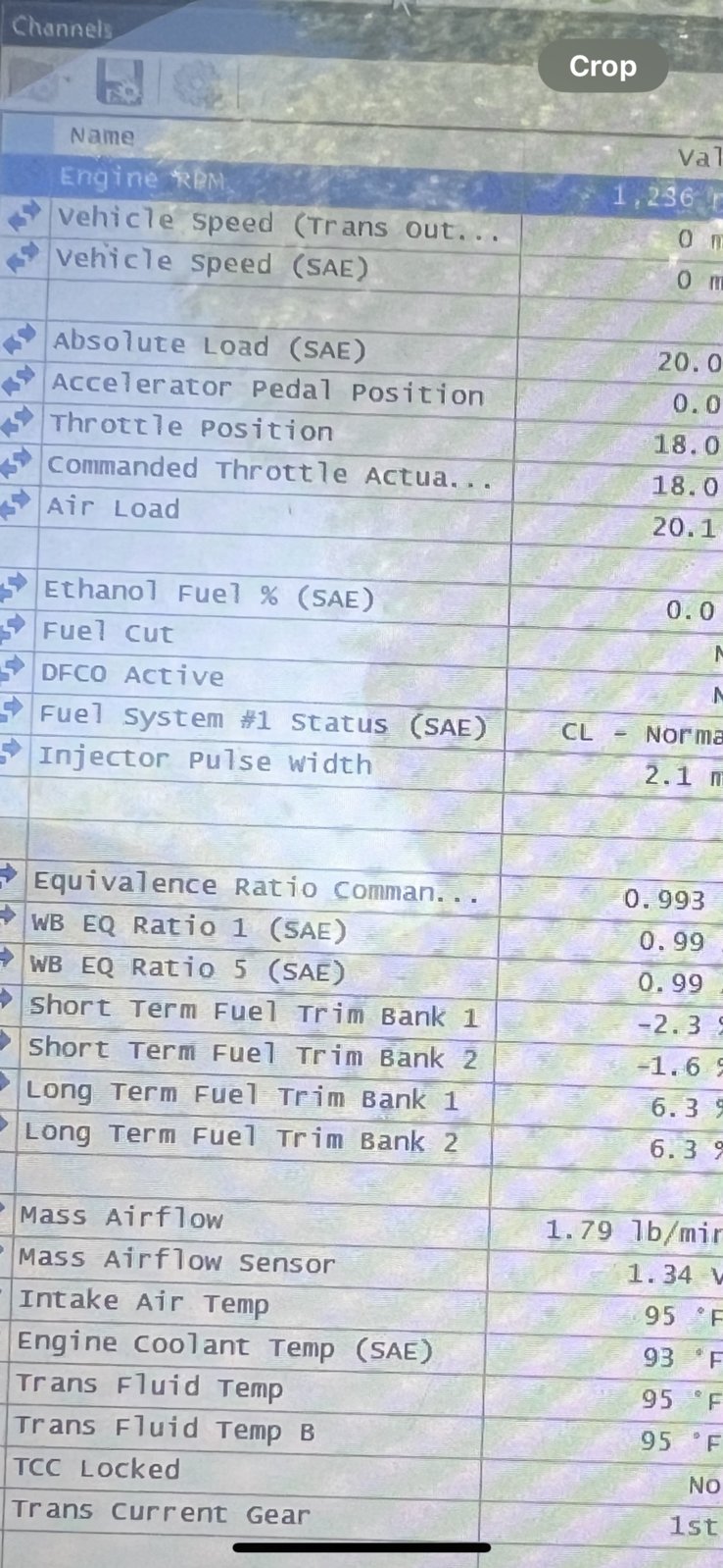

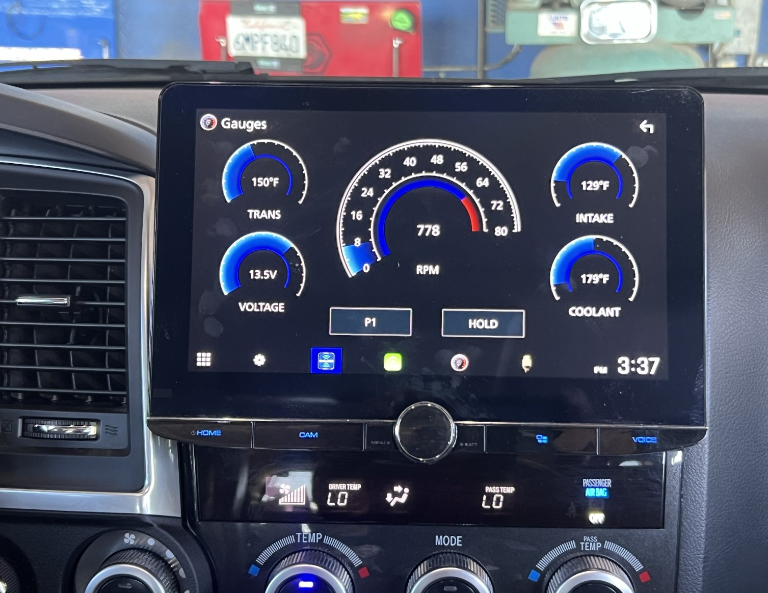

    Got it back, only the radiator & cooling parts in, he had an emergency after wasting an hour not getting the 2.3 pulley off. Said it is too small for the puller I got the original off with & he broke his puller trying.
    I'll bring the truck back Saturday for the cats.
    It was idling for 20 minutes before I left, running almost 20 degrees cooler, the thermostat that was there looked new.

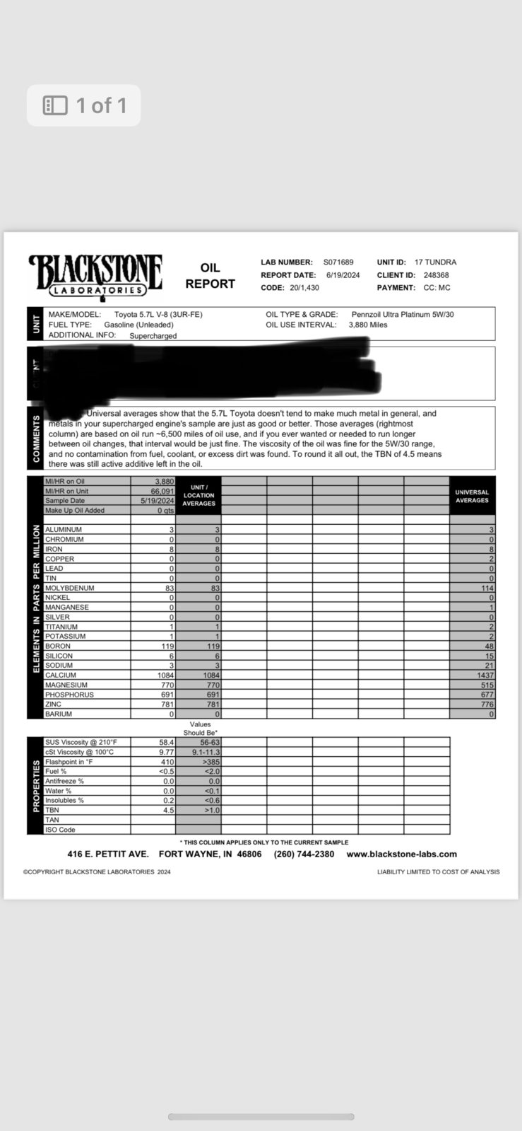

    Got my first blackstone report ever done. Almost 4k miles on Pennzoil Ultra Platinum 5w30. Good results it would appear to me. I was worried I had something coolant related going on as I had to top off my reservoir, but I believe it’s from the upper radiator hose and cap seeping based on residue I saw in those areas. Gonna have to replace a few of those items.

    It's a very good report! Congratulations!

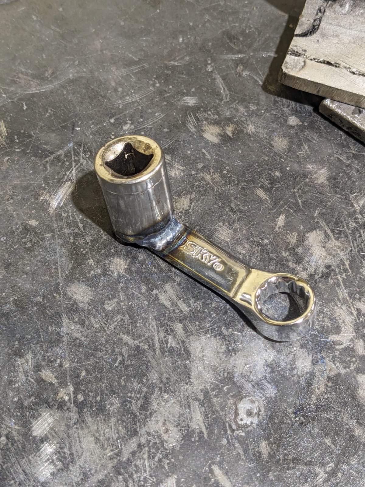

    New O-rings, seals, coupler, pulley, oil, and cleaned off as much shit as I could (I'll detail the outside once installed). Ready to go back on the engine!
    And in the process had to pay the blood sacrifice to the supercharger gods due to a box cutter blade, hopefully that means the rest of the truck will go smoothly.

    Yikes! The only real choice to fix that is to use "super" glue it back together.
    Amirite?

    Exactly what I told the nurse I was debating before heading to get stitches :rofl:

    Superglue ONLY if you have no other choice...good call on stitches!
