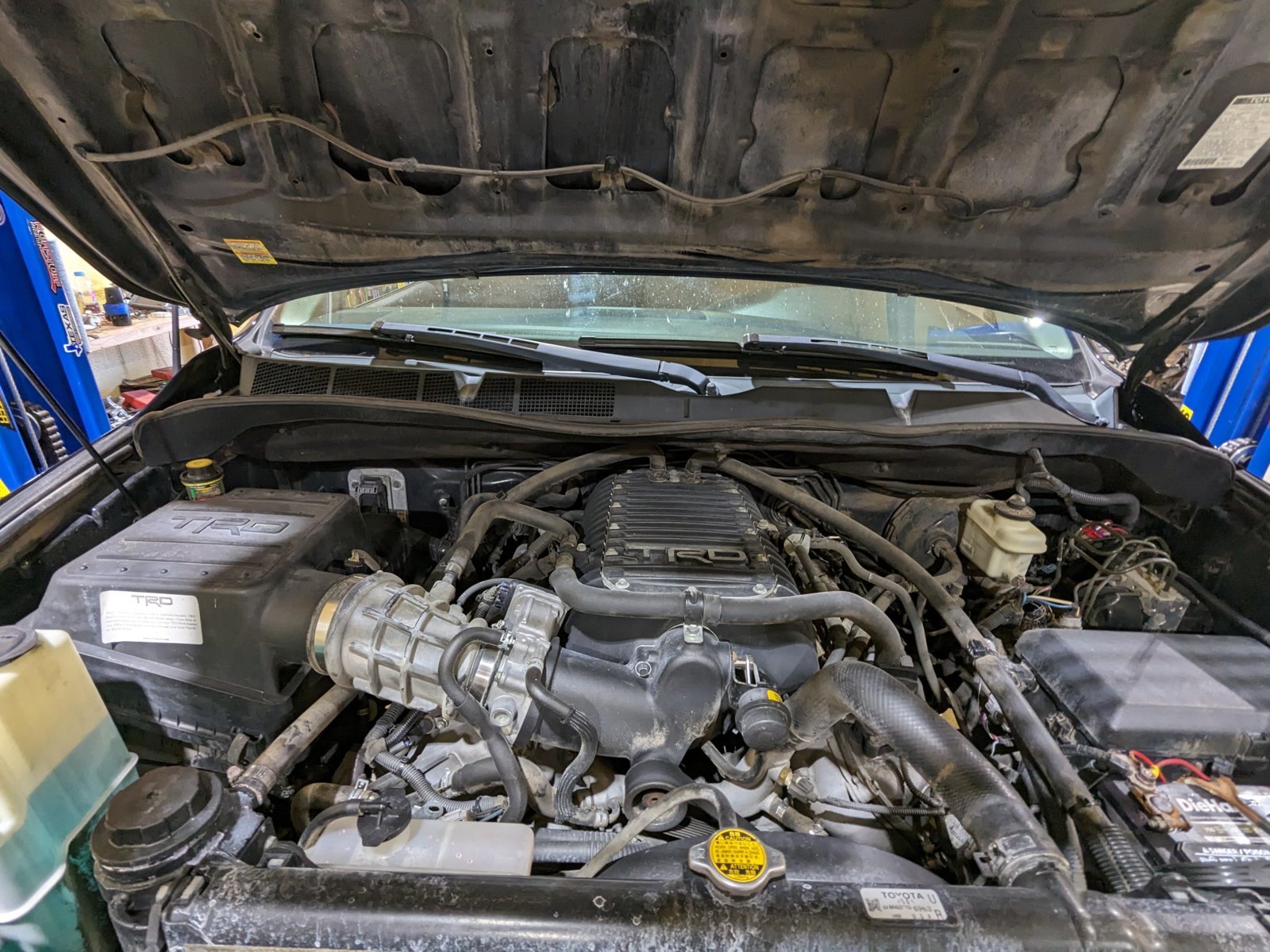

    Dude from up north dropped this off over the weekend. Going to install a 2.0" pulley kit, 650cc injectors, AFR gauge, catch can, fuel pump, IPT valve body, transmission cooler, spark plugs, and tune it. And then he apparently has a 2021 Tundra he just bought and is installing a 2650 Magnuson on it and will drop that off for similar treatment in the future.

    Dang, people are getting after it, stepping it up with the S/C mods.

    Only 650s with a 2.0 pulley?

    With my 750's and 2.0 pulley I'm about 72-78% so should be a "little" wiggle room.

    I wouldn't mind going larger, but the "Prospeed" injectors are janky so I don't like them, and the Five-O injectors I feel like are more prone to issues, so I'm doing Deutschwerks, which limits it to 650s. But it should be fine, lowest elevation it'll see is 2500ft most likely. Maybe go down to Las Vegas once in a blue moon, but I'll throw in a big pulley so he can drop the boost if he wants. With boost reference the injectors will probably be in the 90% duty cycle range, and majority of the time being in Salt Lake City they won't even be that high.

    Even though he's at elevation nice another stock engine with the 2.0...

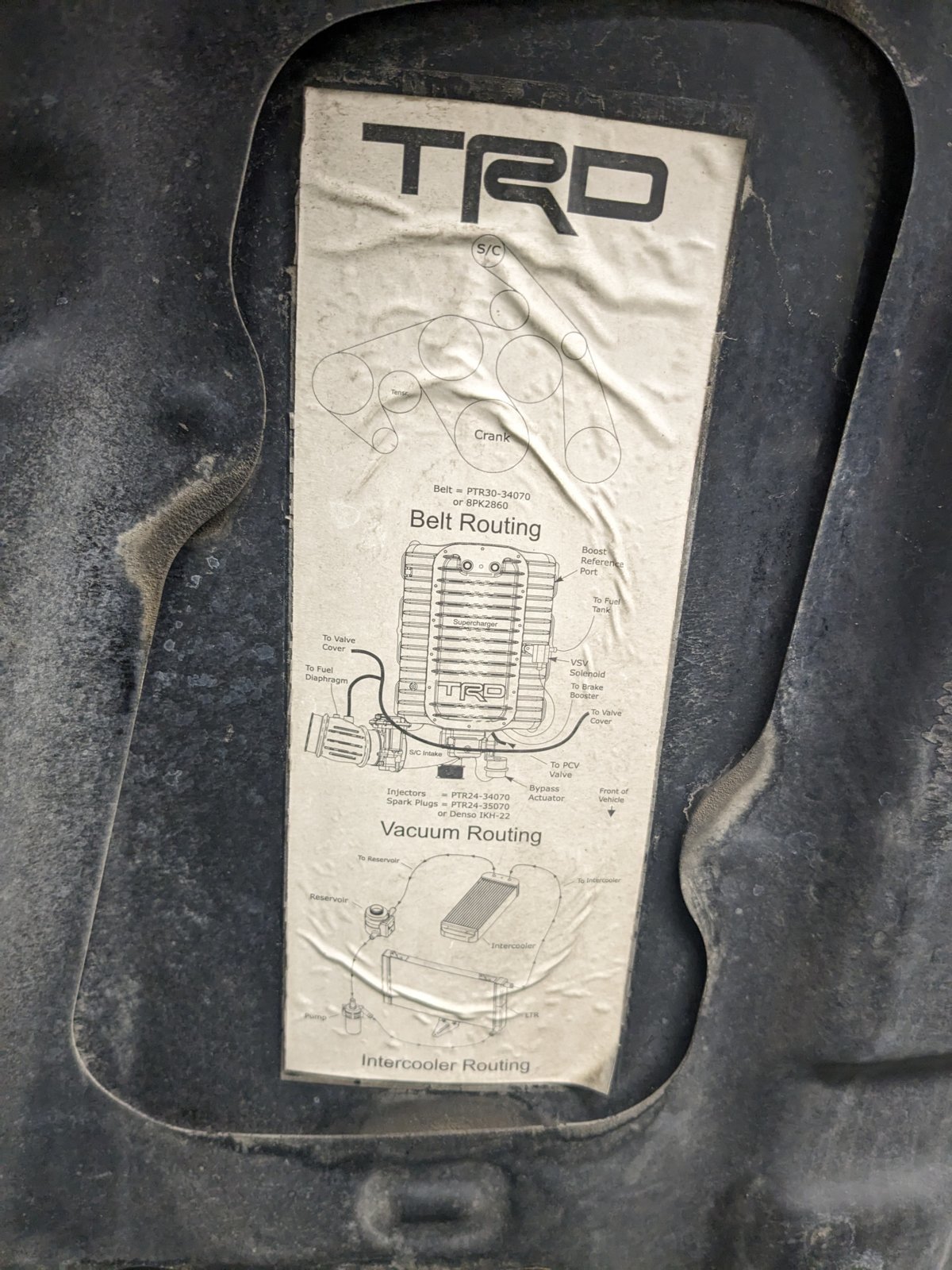

    This is a cool decal

    I wish the maggy kit came with a belt sticker
