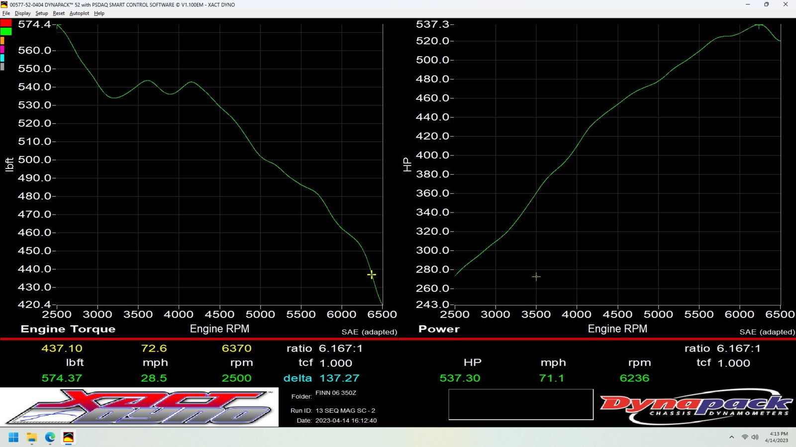

    e30cabrio
    Oct 20, 2017
    #10410
    6,533
    West Valley, Phoenix, Az.
    Boosted 2013 Sequoia TRD FAUX
    This is mine on a much lesser tune with a smaller Throttle Body, lesser intake & slipping belt. I bet it is minimum 10% more now.
    Saltyhero13 and NatesNightMare like this.
