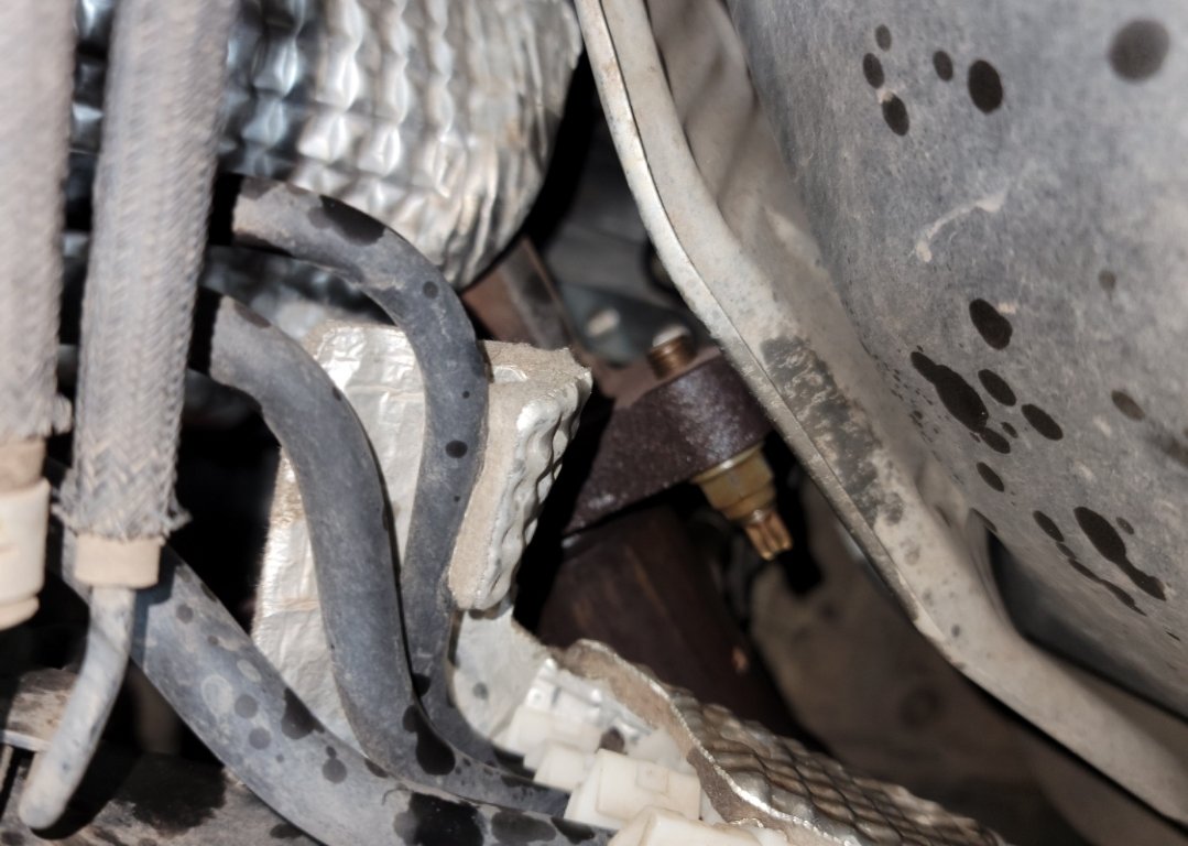

    Another nice detailed write up. When I switched to AN braided fuel lines I put heat shielding sleeves all along the drivers side as it was close to my headers and exhaust. Maybe needs some extra shielding if it persists. Hopefully the spd and t-stat is the ticket.

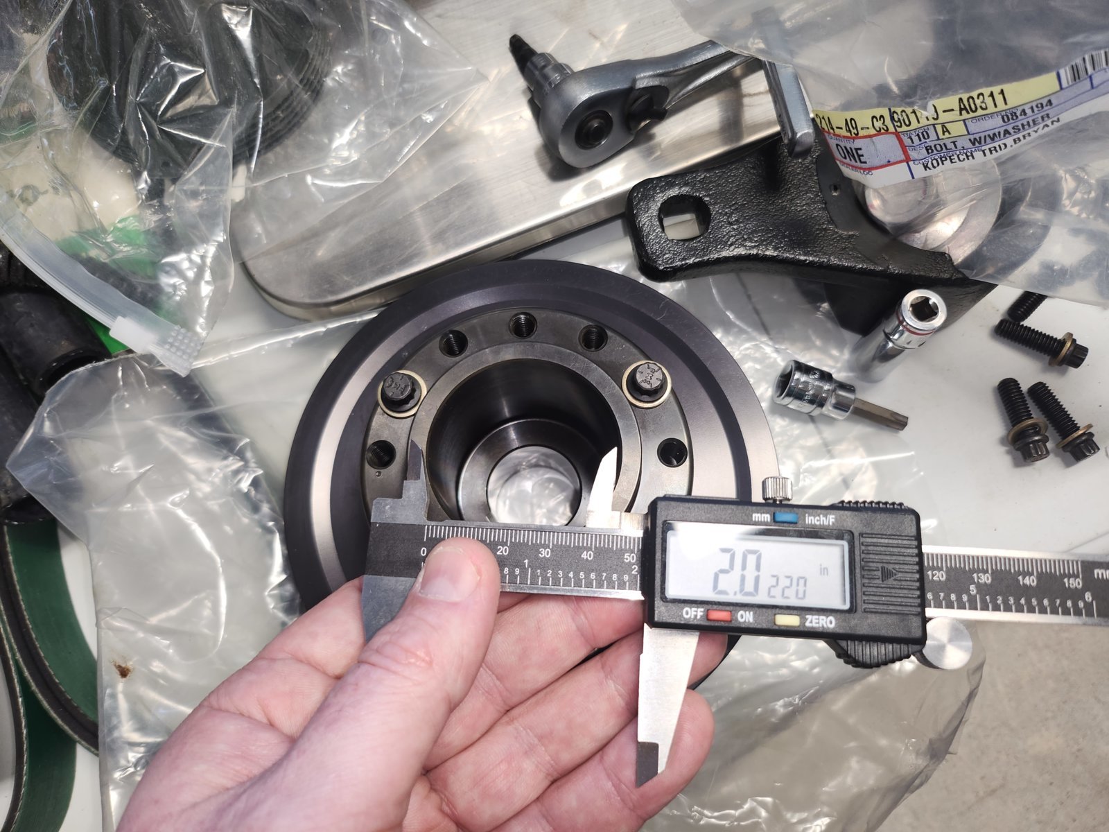

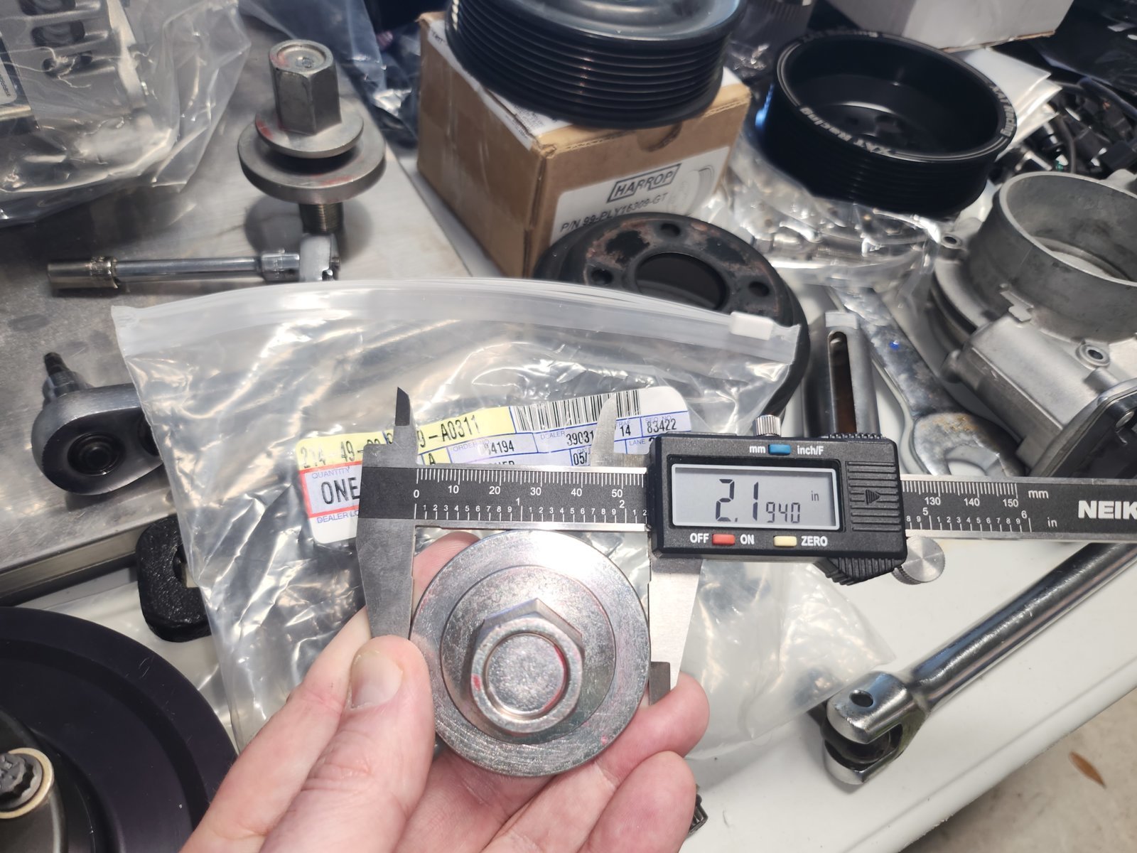

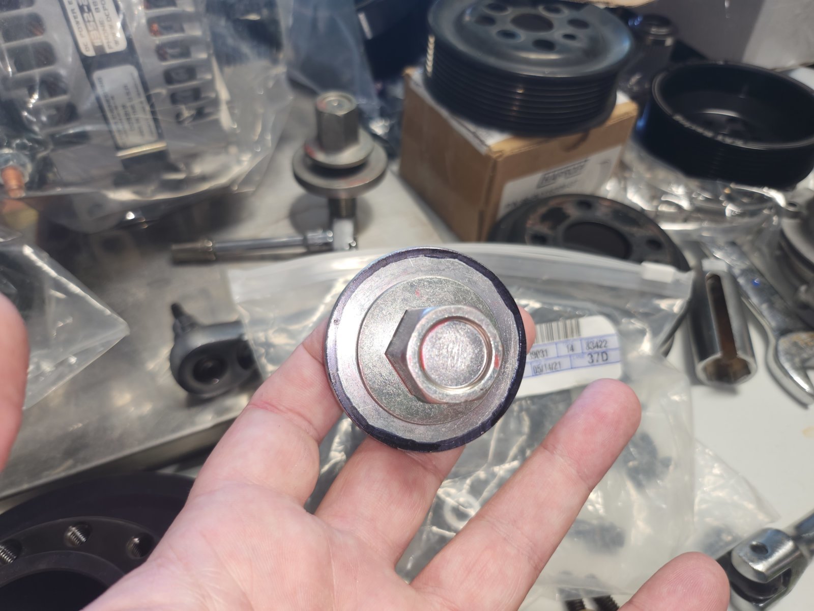

    One thing to note on the ATI pulley, or at least XAT's version, is the stock pulley bolt doesn't fit...you have to grind the washer down about .1" all around. I held the washer with vice grips and used my grinder with a flap disc to get it down to size.

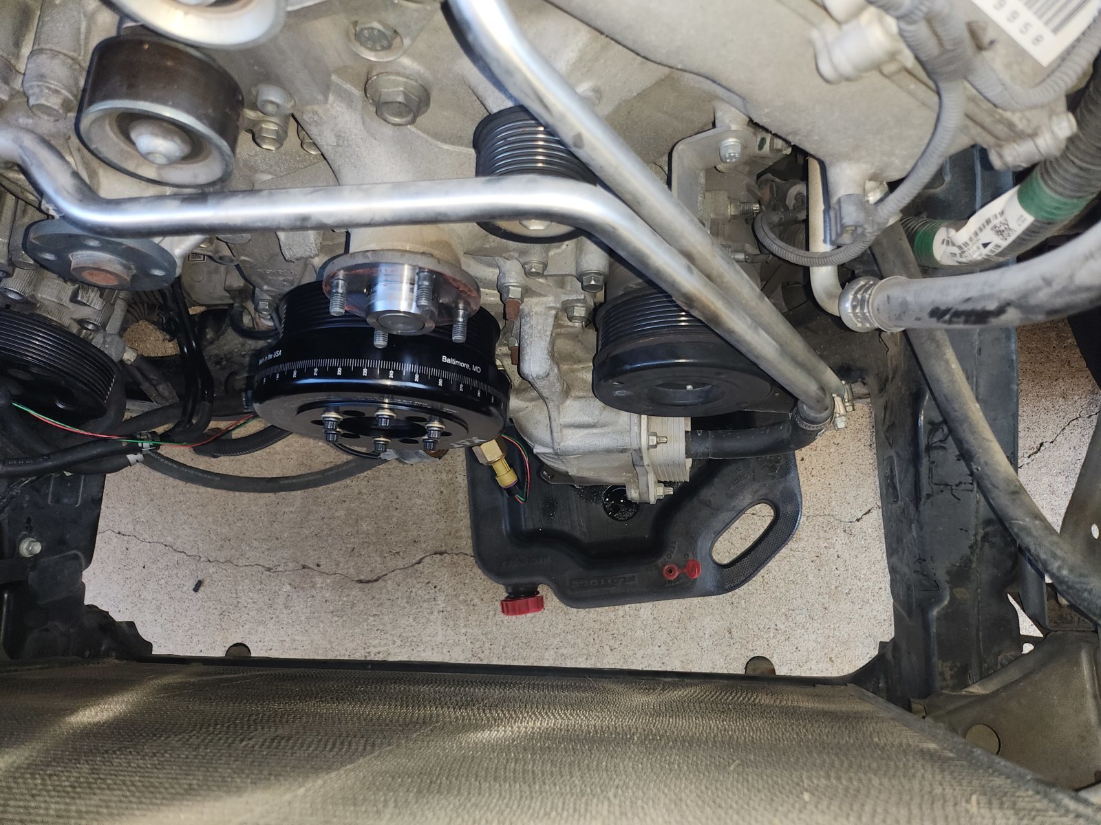

    Another hurdle I just encountered after installing the hub...the damper won't slide over the hub because it interferes with the oil pressure sensor...so I guess I'm moving that now...

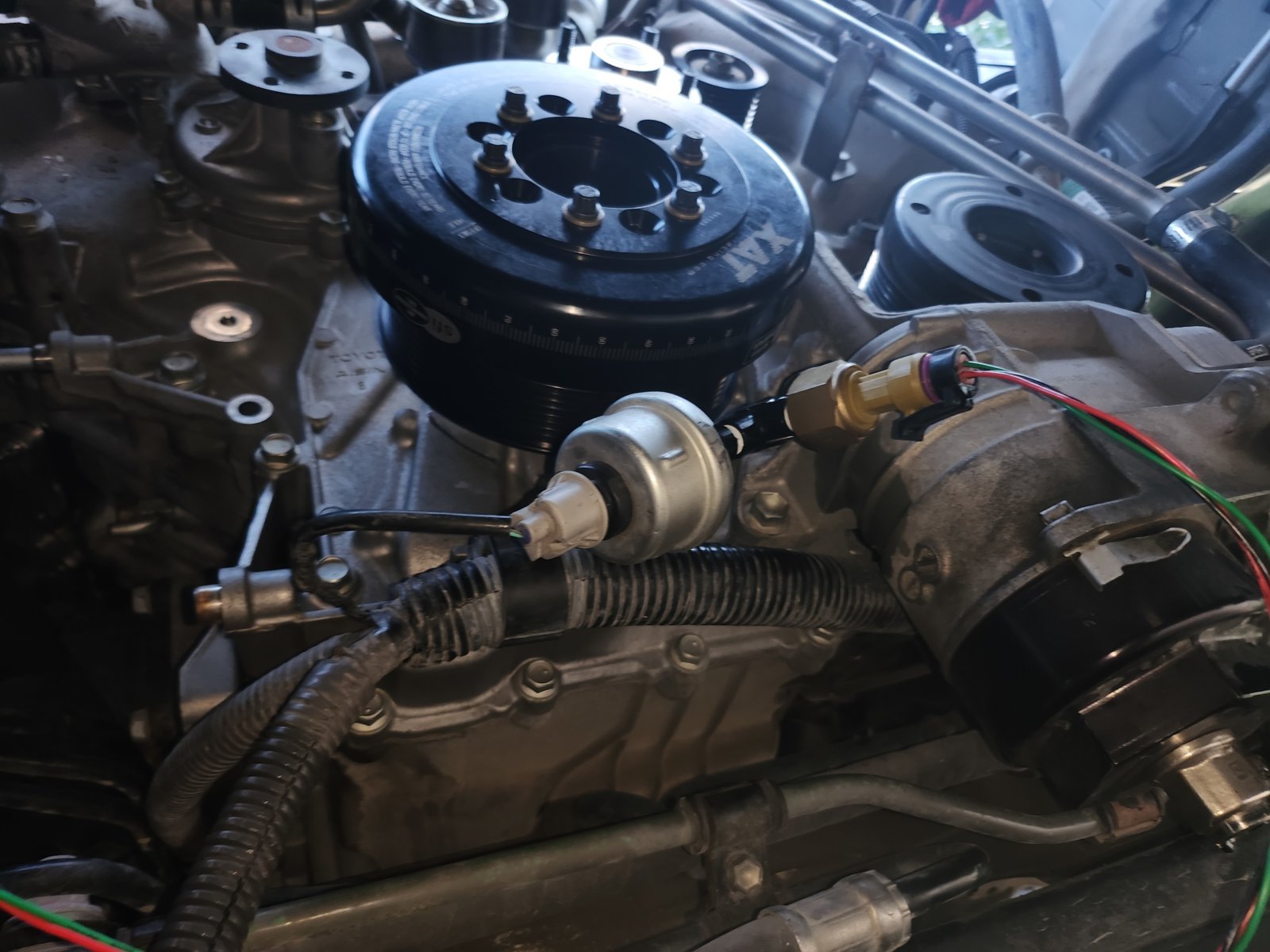

    I relocated my stock oil sensor and installed my AEM oil sensor while I was at it, parts list below. I didn't have to adjust the wiring, plenty of room for the balancer now...and a larger crank pulley when the time comes.
    1/8BSPT male to 1/8NPT male adapter from McMaster Carr
    1/8NPT Tee adapter from Earls
    1/8NPT male to 1/8BSPT female adapter from Earls
