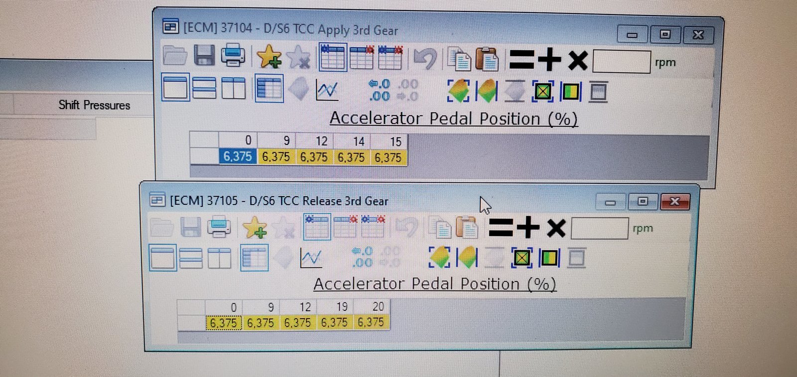

    Can anyone who has disabled the flex lock on their tunes show what values should be input into the tables to do so? I may do that with mine to avoid the excess heat for no good reason and prevent wear on the TC clutch.

    6375rpms for both apply and release for all cells. D/s6 is 3rd on up and sports is 4th on up.

    Am I lucky or did Sniv lock my transmission tune in? I am unaware of any shifting issues (hopefully not jinxing myself)

    Thank you sir!

    It's all good. I brought up an old post by slownstock about disabling flex lock. His theory was after market torque converters don't play nice with them, they generate excess heat as the apply and release like 100x's a second. It was help drivability but mostly to gain a few tenths of mpg savings to meet epa mpg standards.
    I saw the shudder tsb and forgot who but Toyota tech was saying it was flex lock and the torque converter design. I disabled it did a fresh ws atf change and added a extra 1/2 qt atf and my shudder and p2757 went away.
    I told John at ipt and he was looking at trying it on other toyota vehicles with shudder issues/2757. He said it would help in prolonging the trans life. It's always reversible.

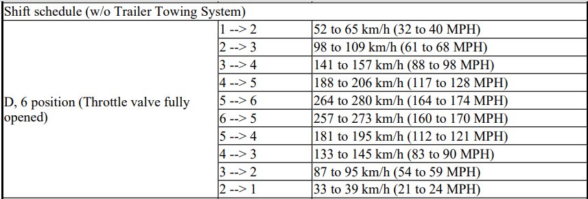

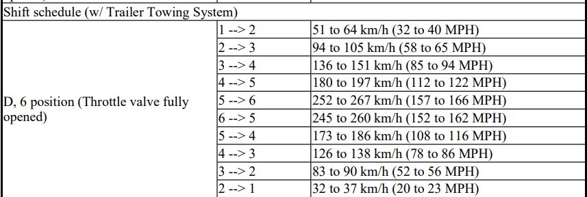

    The differences in speeds between w/o and w/ the tow packages may be due to different final drive ratios as standard equipment. :notsure: 3.90 vs. 4.10.

    I haven't got the truck up to 166mph yet. Toyota says it can well...:eek2: Fastest I've seen was 156mph by a guy who disabled his abs fuse and used GPS to log his speed

    Yeow! I'm not a big fan of speeds like that in a truck, too much air that can get under it and mess with the handling. But that's just me.

    Not me! Some yahoo years ago filmed himself in TX or AZ just flat out to the floor for 5 minutes. Crazy in a truck.
