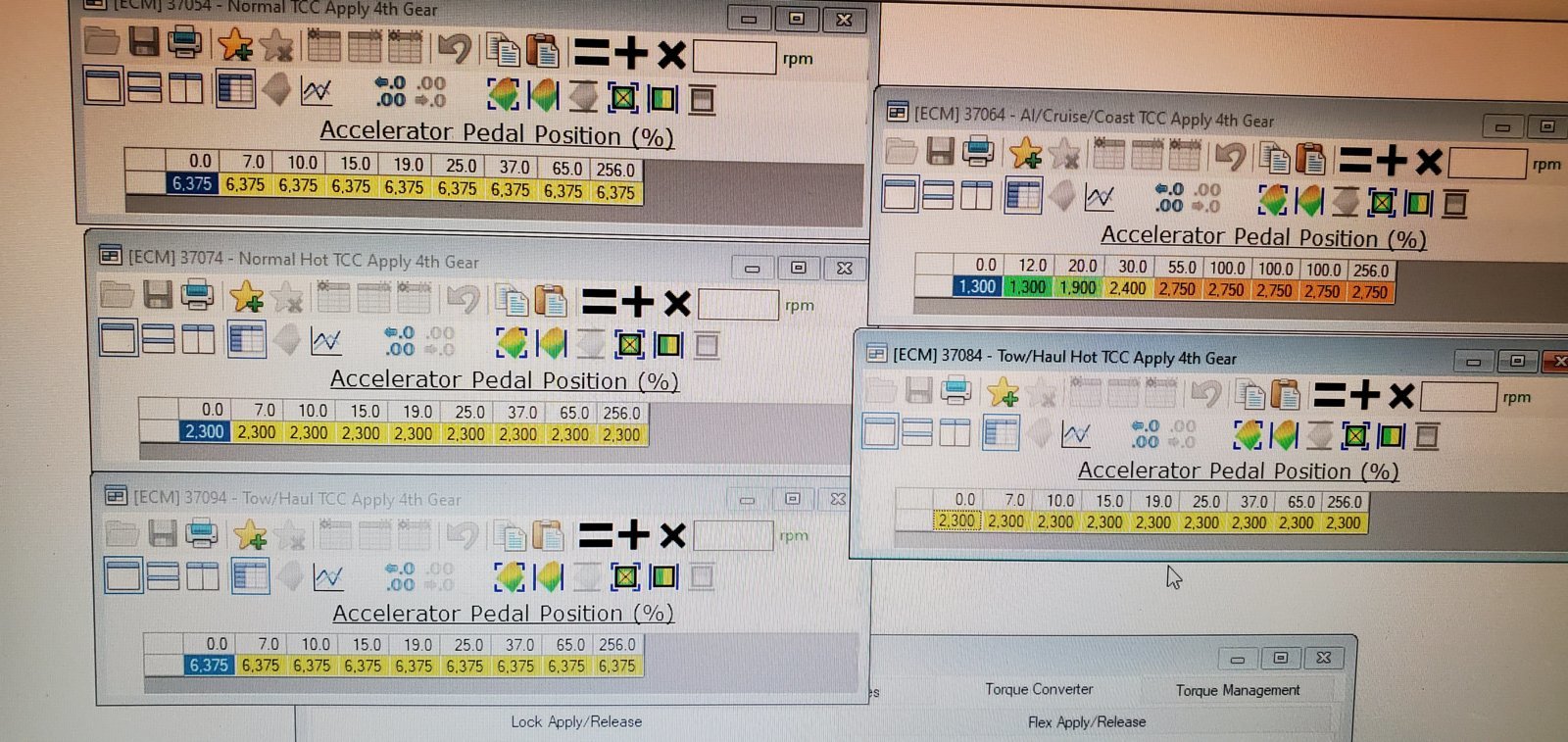

    6375rpm is default disable from my stock tune. Bad pic from my cheap tune computer... one could set tow haul to lock up 4th for those hill climbs. Other stock tunes can vary since mine is 2007.

    I remember coming across the same chart once upon a time. IIRC, 5900 RPM in 4th gear with stock tires and gears would be over 130 MPH. I'm pretty sure I saw 4800 RPM the other day while passing some jack wagons.. on a back road in Mexico, of course...
    I am very curious about the clutch load capacity like you are talking about. I was under the impression that under heavy load in the lower gears 1-3, it's best to keep the TC unlocked to use as a buffer, so to speak, between the clutches and the engine power due to the gear reduction, torque multiplication, and physical size/clutch surface. But by the time you get to fourth, the shaft speeds and torque transfer is such (being 1 to 1 obviously) that the clutches are no longer an issue and heat becomes the problem.

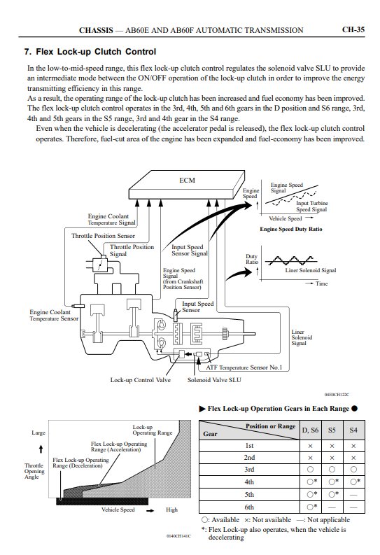

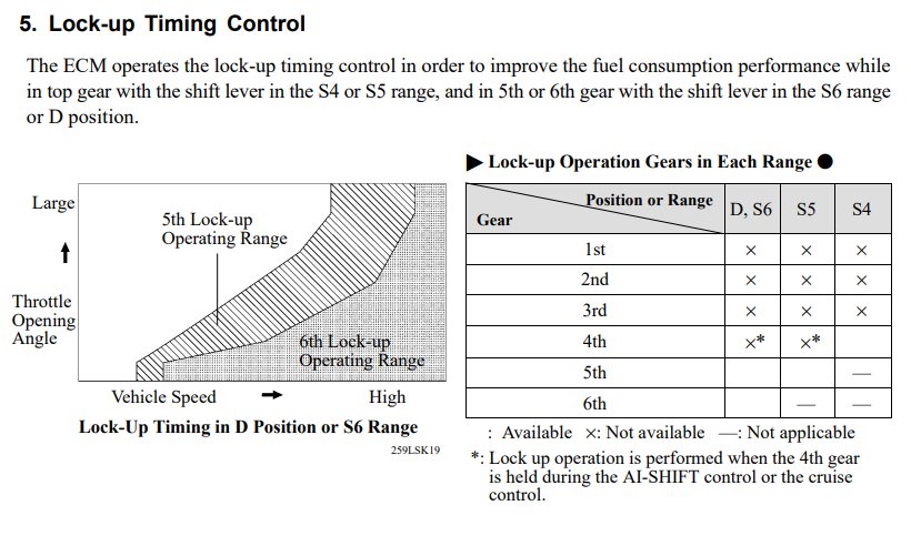

    Found these two nuggets:

    On the earlier years the flex lock and weak damper in the torque converter were causing shudder and p2757 code. Toyota made the TC have a heavier damper and I think a thicker lining in the tc to deal with excess heat from the tc flex lock engaging/disengaging so many times a second. I dealt with this overcthe years but since disabling flex lock I haven't had any issues.

    Any benefit to keep flexlock for our applications (looks like purely for mpg) or recommend tune it out with HPT?

    Disabled it on mine. Truck drives a lot better and the rpm isnt constantly changing from it locking/unlocking, which I found extremely annoying. No noticeable difference in trans temps or mpg.

    When I spoke with John he was interested in disabling flex lock especially those that experience shudder. I did have 4th lock up at 2300rpm in normal and disable at 2100rpm but he said there really is no need in normal mode. So I just set it back to normal.
    Cruise is already set to lock you would have to set each mode up individually. Changing one does not affect the others.
    Flex apply release is independent of the regular torque converter apply release settings.

    I looked at it as less heat being generated in the torque converter and longevity being supercharged.
    I too haven't noticed any loss in mpg and seemed there was better shifting. Definitely can tell when it locks and unlocks.
    You can test it out and always revert it to the original flex apply release settings if you don't like it.

    It haa to lock in gears above 4th because when mine isnt itll start to climb in temp until it locks then itll cool right away
