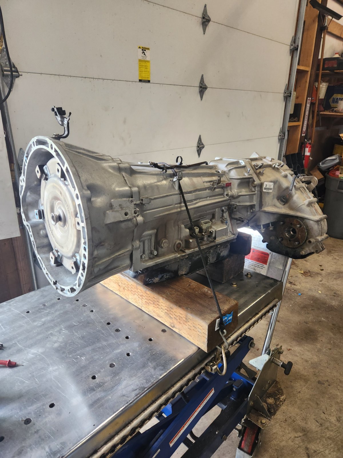

    God damn! That, "will be after rebuild" a beautiful piece of equipment there!

    I'm envious of all the other Tundras I see on the road that have functional transmissions...

    I apparently missed it and am behind the curve. What happened to your stock transmission?

    I smoked it, about three weeks ago. I really haven't said too much about it. When I do it makes me want to drowned my sorrows in an entire quart of Tillamook ice cream. All forward gears slip real bad, although reverse is fine and the fluid smells really burnt. I've asked IPT to build me one of their super duper units, I figure why fuck around.

    Well shit man I'm truly sorry to hear. It's probably inevitable for me since I been fumbling around with transmission tables...... So I'll be looking to you guys when that day comes lol

    I would get an IPT valve body upgrade if you don’t already. That’s likely all most transmissions need to stay alive (1k now vs 7k later).

    That's what I was doing, although I don't know with any certainty that what I was doing was the cause. But I can say that I probably won't be tuning the converter to lock up in 3rd gear with the new one, even if I'm told that it can handle it.
