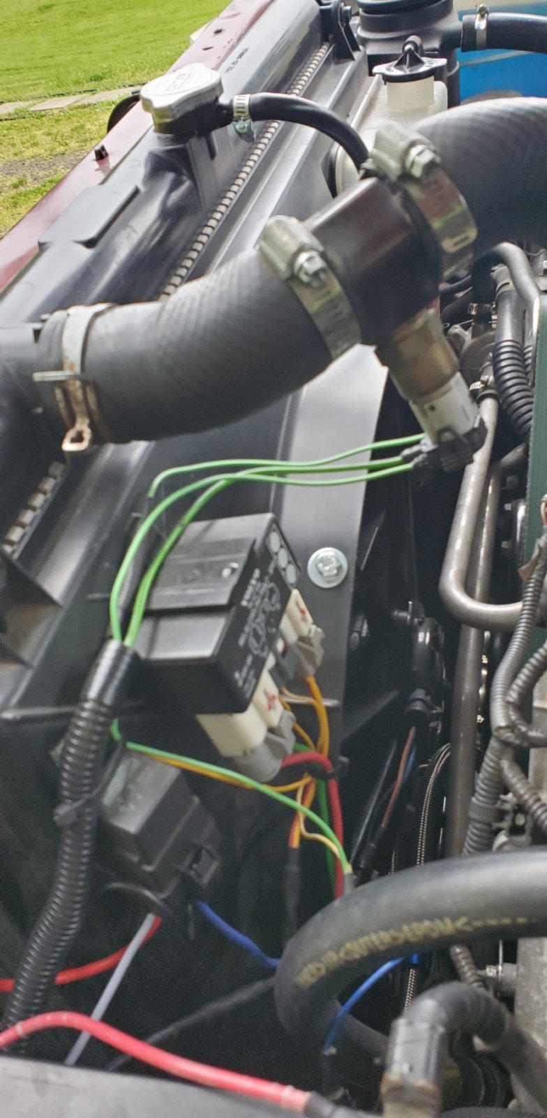

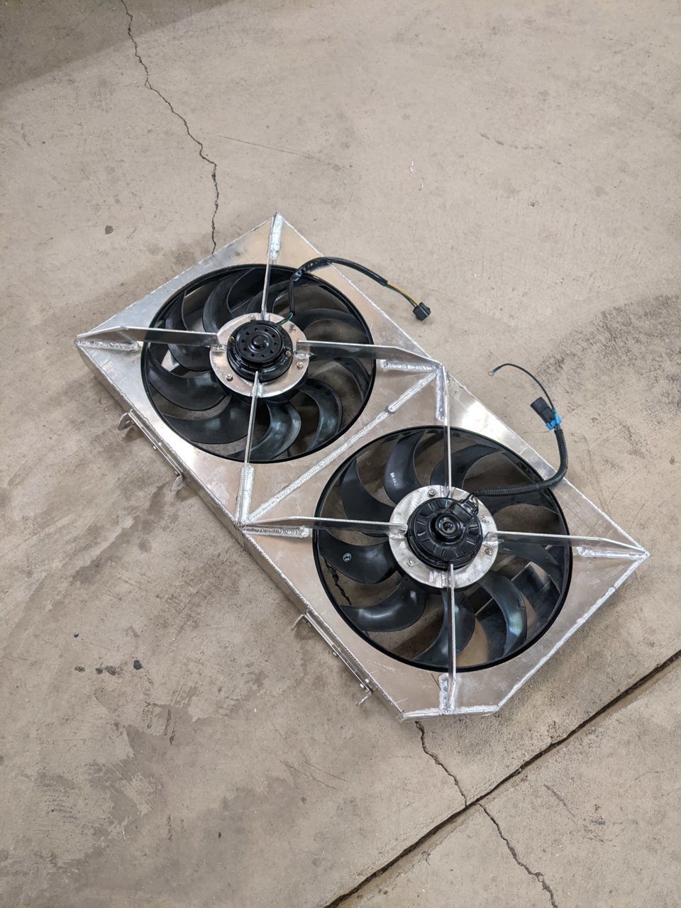

    Here's my Taurus fan, Volvo relay and BMW thermostat. I removed my a/c relay as it was having issues. It's a Frankenstein setup but works...

    Damn sir, you build some cool Shit!

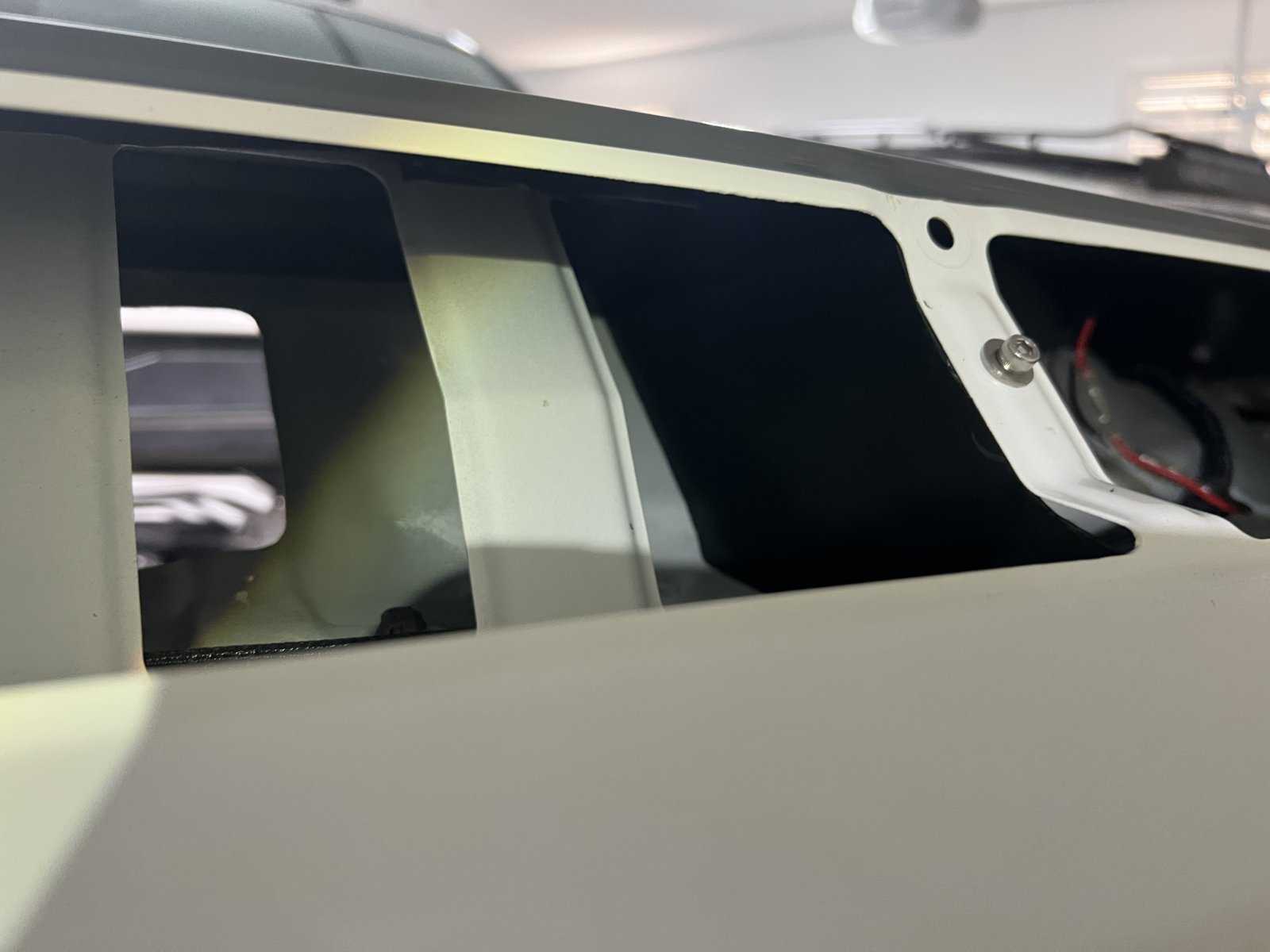

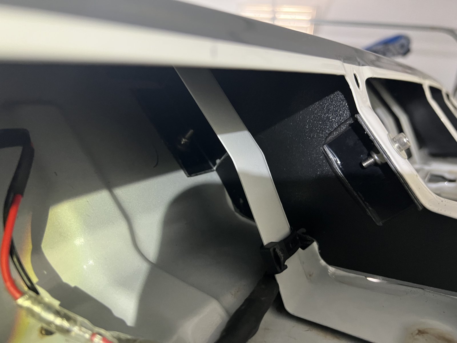

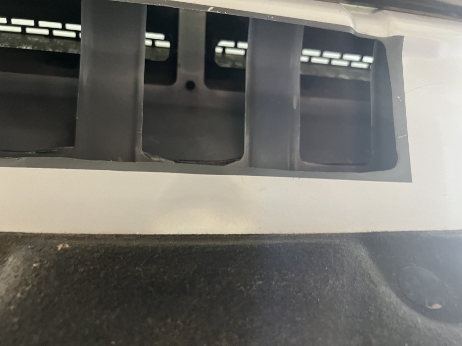

    Has anyone cut through the hood bulge to let air flow through that way other than for a light bar lol?

    yep we did this on the old man’s rig before going to the vented hood

    Not here, but I'm starting to research water management of louvers since I'm debating putting one directly over the turbo, solely for heat exhaust.

    Nice, I was thinkin about it today. How did it work out other than water getting through?

    You have a turbo blanket on it?

    Yes, and while the blanket is cool enough to place a hand on, I'd still like the evacuate the radiant heat as much as possible, especially when stopped/parked. Long term plans. It'll take me a while to figure out which way I want to go.

    Worked well! Definitely recommend but getting heat out is the key hence we went vented hood
