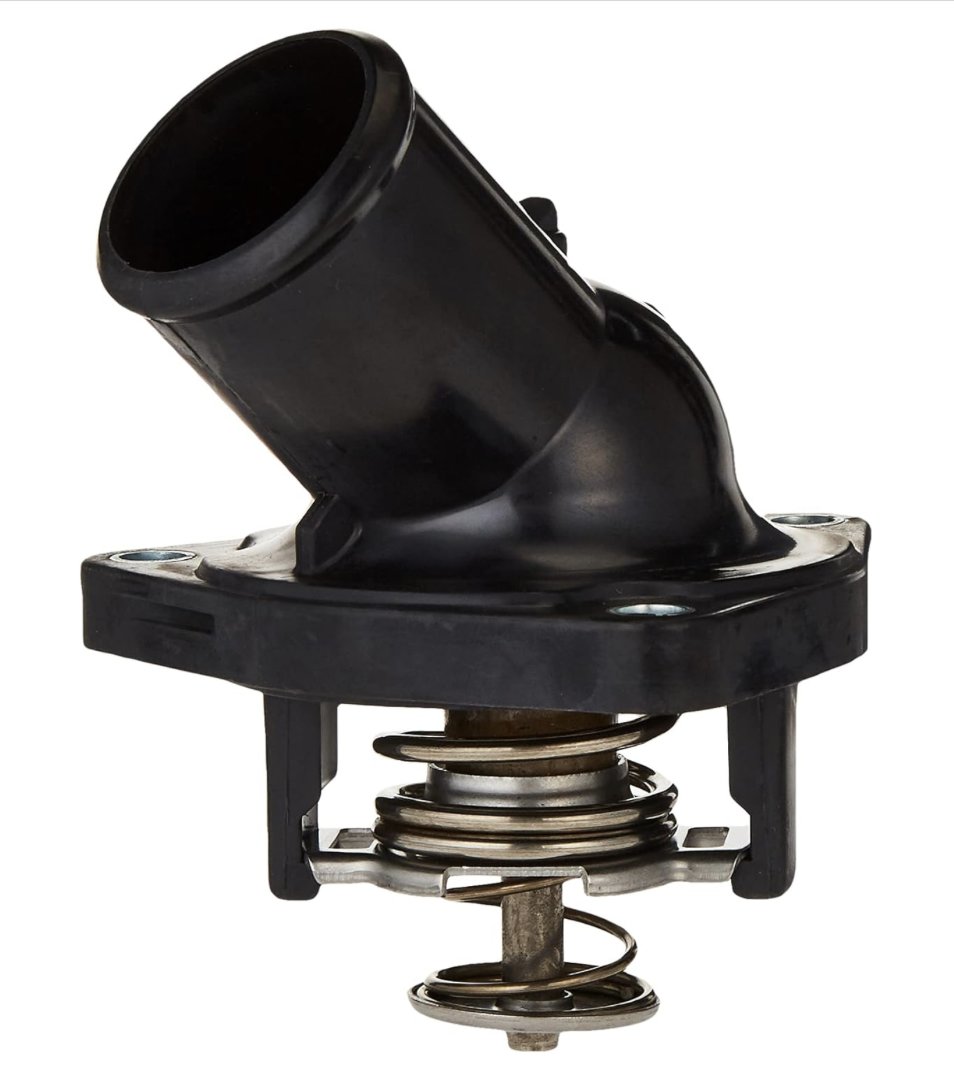

    I'm gonna ask a (probably dumb) question.
    can I simply "cool" the motor by getting the 160degree thermostat?
    or
    Mdl likes this.

    I saw the 160* thermostat and was wondering the same thing. Consider me subscribed to this entire discussion about cooling.

    you gotta be careful asking about running stuff cooler...I tried that with "pinning the transmission" discussion and they* jumped my shit.
    *they = self proclaimed Toyota engineers

    Not dumb. Too cold is bad as well. Optimal operating temps for oil and engine are ~200.
    Lower temp thermostat would be great for a tracked vehicle approaching higher temps 240+. EDIT: External oil cooler (extra cooling) seems to be the better solution in this case.

    Funny you should bring this up - I have the Mishimoto housing and 160º thermostat arriving this Thursday (I'll install on that day as well). With +90º days in CO's forecast, I'll let you know how things go!

    But, on the thermostat, I'm with your question. I THINK it'll help absorb the small, short lived spikes I see until the water/meth kicks in, but much like the pinning of the transmission, does it essentially not matter at the end of a 3-4 hour tow? Am I still going to be kissing the 200-210* on long climbs at 0.0psi?
