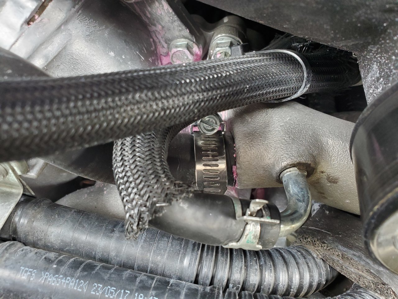

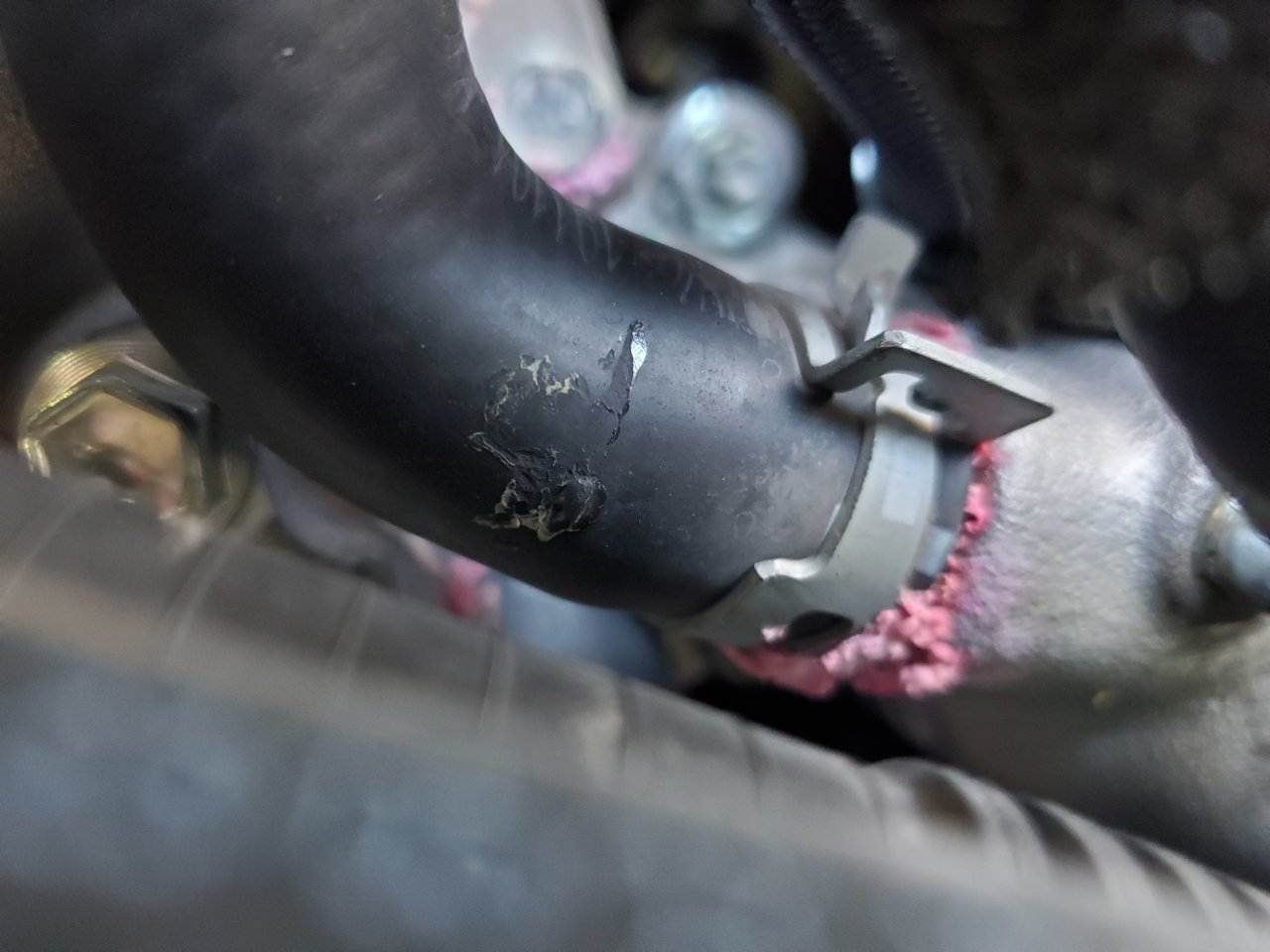

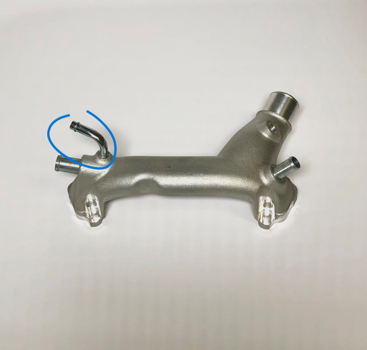

    Figured I'd post this here since it would likely get the best response. I know most of you guys are running the Harrop, but any thoughts are welcome. I had the Magnuson installed just over 2 years ago and maybe 7-8 months (just guessing here) after the install I had a very slight coolant leak from the hose that connects to the crossover pipe. It wasn't really a leak so much, but mainly crusty coolant that built up at the hose connection. This has been cleaned up and comes back. I had the clamp changed from the factory style to a worm clamp per Magnuson's direction and it still continues. The hose appears good with no splits and is cut even. The clamp is tight also. Toyota tech thinks there might be a hairline crack or fracture in where the nipple comes out of the crossover pipe. Magnuson has agreed to send me a new crossover pipe which should be here tomorrow. Does anyone know if I'd be able to swap crossover pipes without removing the blower?
    Saltyhero13 likes this.
  24. Mar 29, 2022 at 12:12 PM
    #1614
    Wynnded
    Wynnded What MPG...
    #379
    5,711
    Rockies
    Souped up truck
    Yes, I have done this replacement. The blower does not need to come off.
  25. Mar 29, 2022 at 12:14 PM
    #1615
    AZTundra
    Feb 13, 2018
    #12894
    4,476
    Paul
    Phoenix, AZ
    Glad to hear that. Did you have a similar issue?

    Generally, but in my case it was this little bugger that was leaking.
