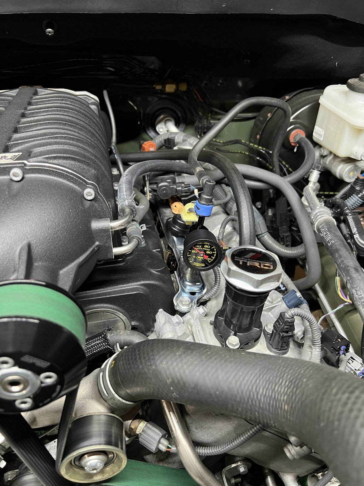

    Abell207
    Abell207 New Member
    Aug 24, 2020
    #51252
    188
    Anthony
    Maine
    2020 Army Green TRD PRO
    I added this pressure gauge a while back and mine also bleeds down after an hour. Stock rails and lines, just dw300 fuel pump and dw650cc injectors with the supplied Harrop FPR.IMG_4259.jpg
  27. Jun 6, 2024 at 4:09 PM
    Wynnded
    Wynnded What MPG...
    #379
    5,588
    Rockies
    Souped up truck
    My Haynes manual says that after five minutes of being shut off, the fuel pressure can drop down as low as 21psi. I know that they're not the gold standard reference, but the book was within reach...
    Saltyhero13 and Mdl like this.
