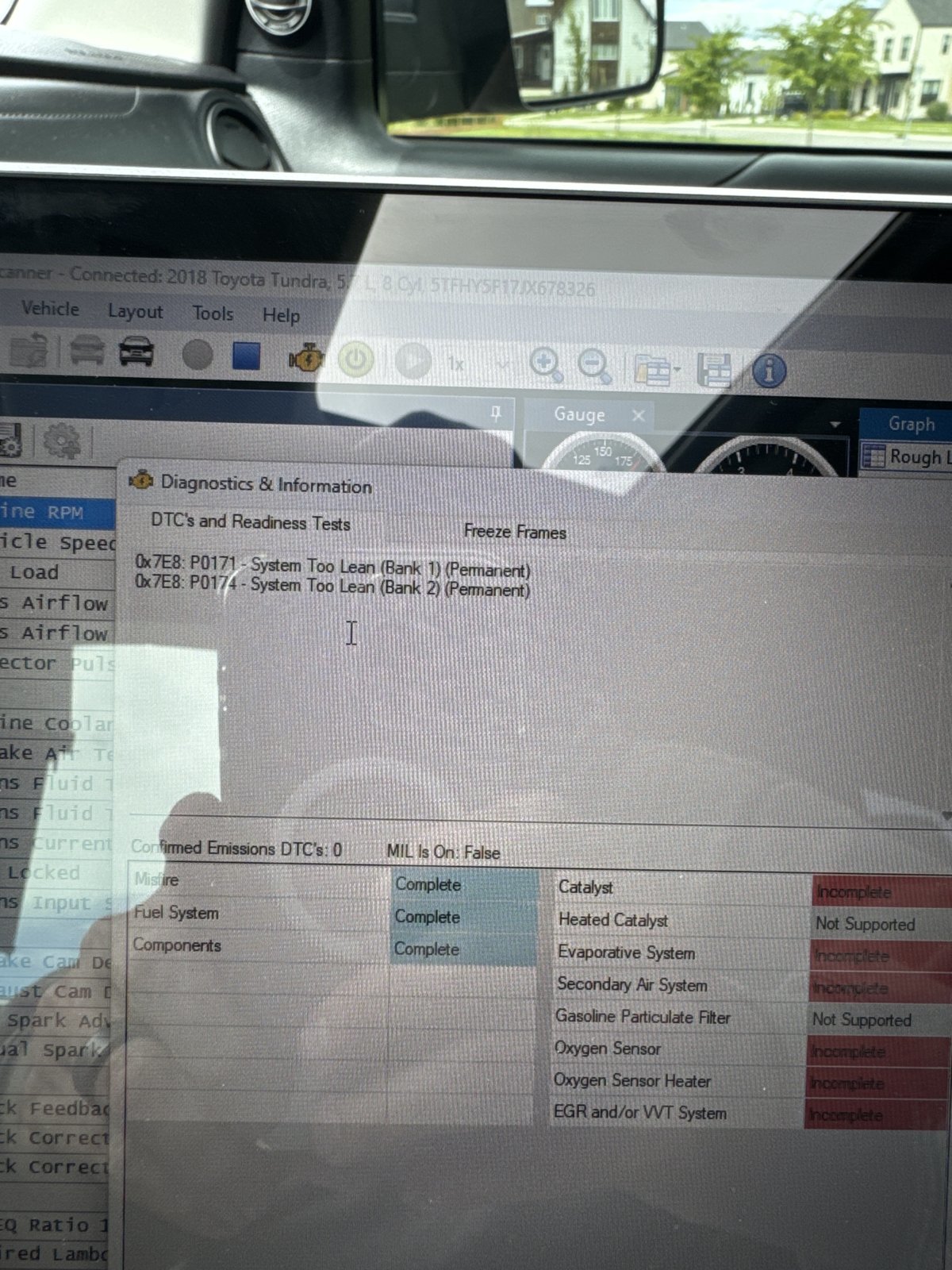

    So I was just driving along normally and the truck freaked out and it threw a P0171 and 0174 code? Haven’t had any issues since install. Any ideas what caused it and is there anything I can do to prevent it?

    Do you have any leaks in your plumbing? Seems like it could be you're sucking in some unmetered air or something...looks thru your fender well and look at the exhaust that was "removed" to weld that bung in...I assume they removed it and if so, sometimes the OE gasket can faulter when changing pipe connections...I had a new gasket installed when I did mine as it was recommended by the exhaust guy and after seeing it once done, I'm glad I paid the $8 O'Riely's Felpro gasket! I haven't had an issue since...I'd check with Freedom and see if they used the existing gasket or if they replaced it...that will be the reasoning...or, at least I'm 90% sure it would be...easy fix

    Check hoses going to the intake, throttle body coupler. Either the tune was already off and it finally went off far enough to trigger it (though looking at datalogs most of them were within 1-2% for fuel trims), or something post-MAF is leaking. If you have a datalog send it over and I'll check it out.

    Air leaks are...we're my nemesis. Definitely check all connections. Ccv tubes good? A little maf cleaner sprayed around tubing gives a higher idle. Was my friend for a little bit.

    all the connections look good. I’m hedging my bet on a shit weld job. I don’t think they took the cat off the truck when they welded it up. Looks way too low on the side vs where @HulkSmurf14 had his bung installed

    Start it, and spray wd40 on the bung...see if it spits on you...just have them fix it...as annoying as it is, they should do it no problem! :welder:

    As the codes are for both exhaust banks, I would think that it's gotta be something with the engine/intake/tune. A bad weld on one bank isn't going to set a code on both.

    Gotcha! Thank you for the info. Just seems strange that it’s ran fine for a couple months and then after the gauge install it crapped the bed.
