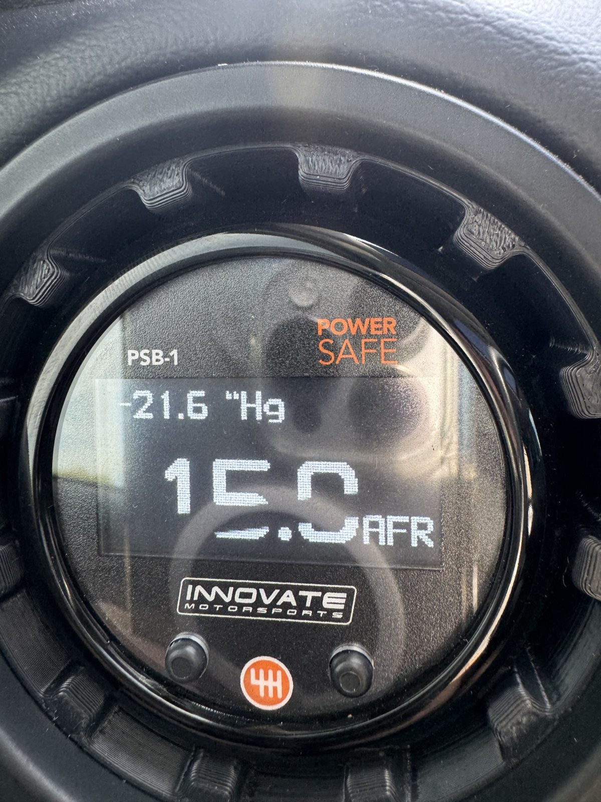

  28. Jun 4, 2024 at 7:44 AM

  29. Jun 4, 2024 at 7:49 AM
    HulkSmurf14
    Aug 9, 2019
    #34377
    2,801
    2014 Tundra Limited
    Tastefully enhanced...
    That's legit...I typically grab 4.6psi max...I have slightly more air with the SABM...that's why you need the Sniv pullies!! And injectors...and....and...lower elevations will net you more boost...

  30. Jun 4, 2024 at 7:50 AM
    Vendeta2k
    Jul 13, 2017
    #8550
    2,296
    Jay
    Bozeman, Montana
    2018 Limited Cement CM
    Thanks for the info! Also updated the post to show the photo was taken at idle at a stoplight
