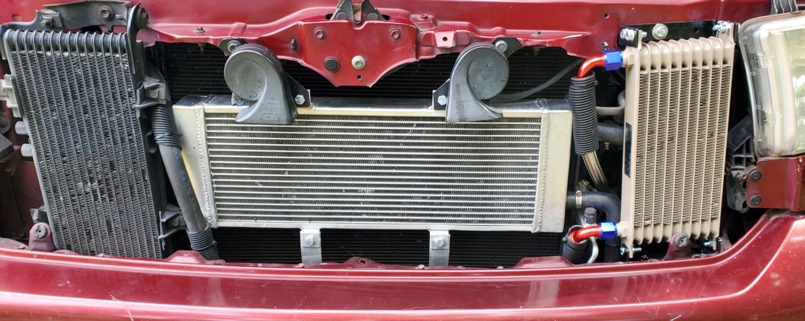

    I would of been nice if I had a before and after IAT's. When switching to a larger air/water cooler, HX.supposed to be 2x the size. Just thicker than what you get in the SC kit. The original HX was starting to fail. So logical to go bigger and with a bigger pump.

    These pics always amaze me.
    There is still 2 more coolers that you can't see in that picture, yet the engines don't have a problem staying cool.

    The mechanical fan pulls a lot of air! The a/c condenser and radiator still stay nice and cool. I've been running an e-fan since 2016. A bastardized setup in the factory shroud. But it works...
