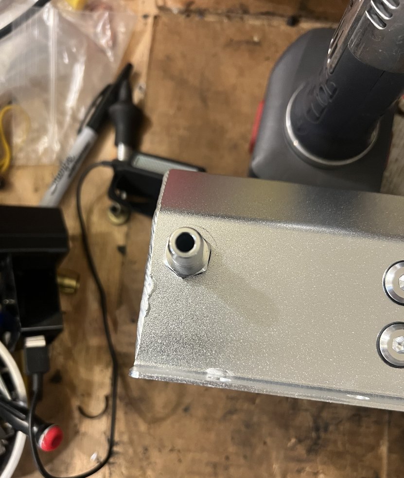

    Drill it out and swap the fitting for something larger

    Would need an aluminum welder. Metal wouldn't be thick enough to tap

    Do a through hole with a nut on the back side

    Meh not worth the time and extra parts :notsure:

    Send me the parts and $20 and I'll weld the fittings on and send it back :D

    Here is the approximate difference, can't it be tapped to accept the larger fitting?

    The inlet/outlet on that is way too small to handle the flow necessary to cool off your charge...
    The holes are too close to the side to do a bulkhead fitting, TIG welding a new fitting on would be the only option. The material is likely too thin to tap reliably.

    The intercooler tank doesn't need to be under pressure? Thought they were to help with cooling.

    The pump will be restricted by the feed from the tank and the pressure side will be much higher since the tank will also be a restriction on the flow coming from the bricks. That will reduce flow, cause IATs to rise, and wear out your pump faster. What most people do is increase the size of the pump, and then increase the size of the lines to 1" or larger.
