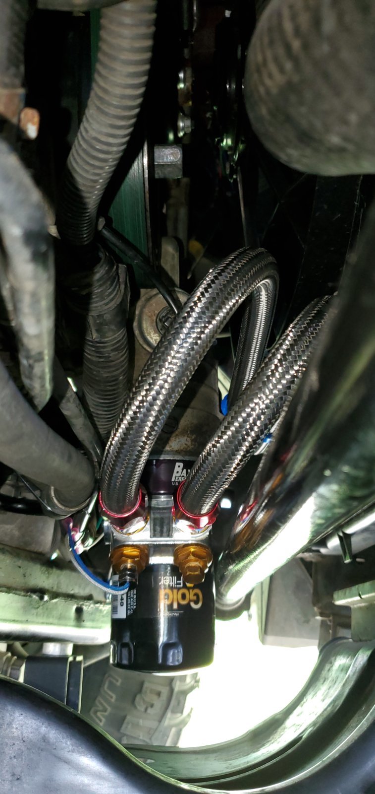

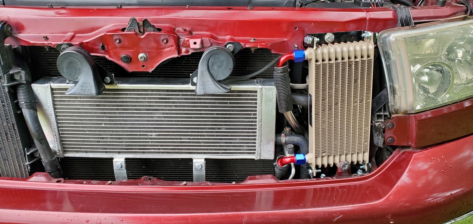

    Finally installed my fleabay engine oil cooler. Will see how it holds up. Able to get 9.5 quarts in.
    Fastlane47, Jowett, Silver17 and 9 others like this.

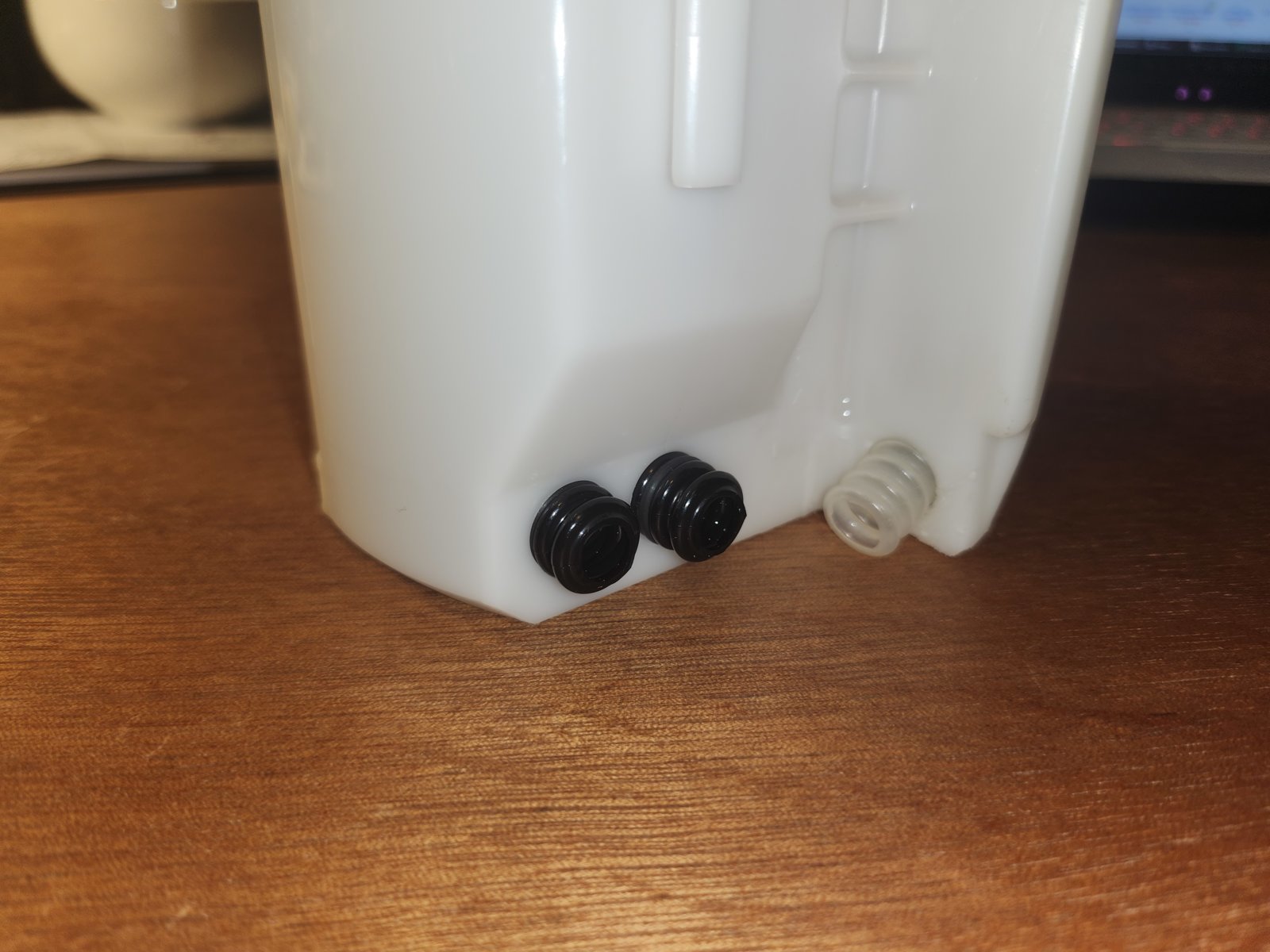

    Just don’t floor it on an incline below like 1/3 tank, it’ll run dry! I do like the simplicity of the 274 with holes as the pump is only pumping and not doing a secondary venturi to fill the basket, this likely maximizes the stock wiring and hoses. Don’t use regular hose clamps as they can’t get tight enough and the 274/system will slow leak when off and make for hard starting (second photo hose clamps : bad).

    He also is FFV which is supposed to have a larger venturi system to handle the ffv high pressure. I installed a ffv tank used a walbro 450 model 267 with no hole drilling and venturi system.

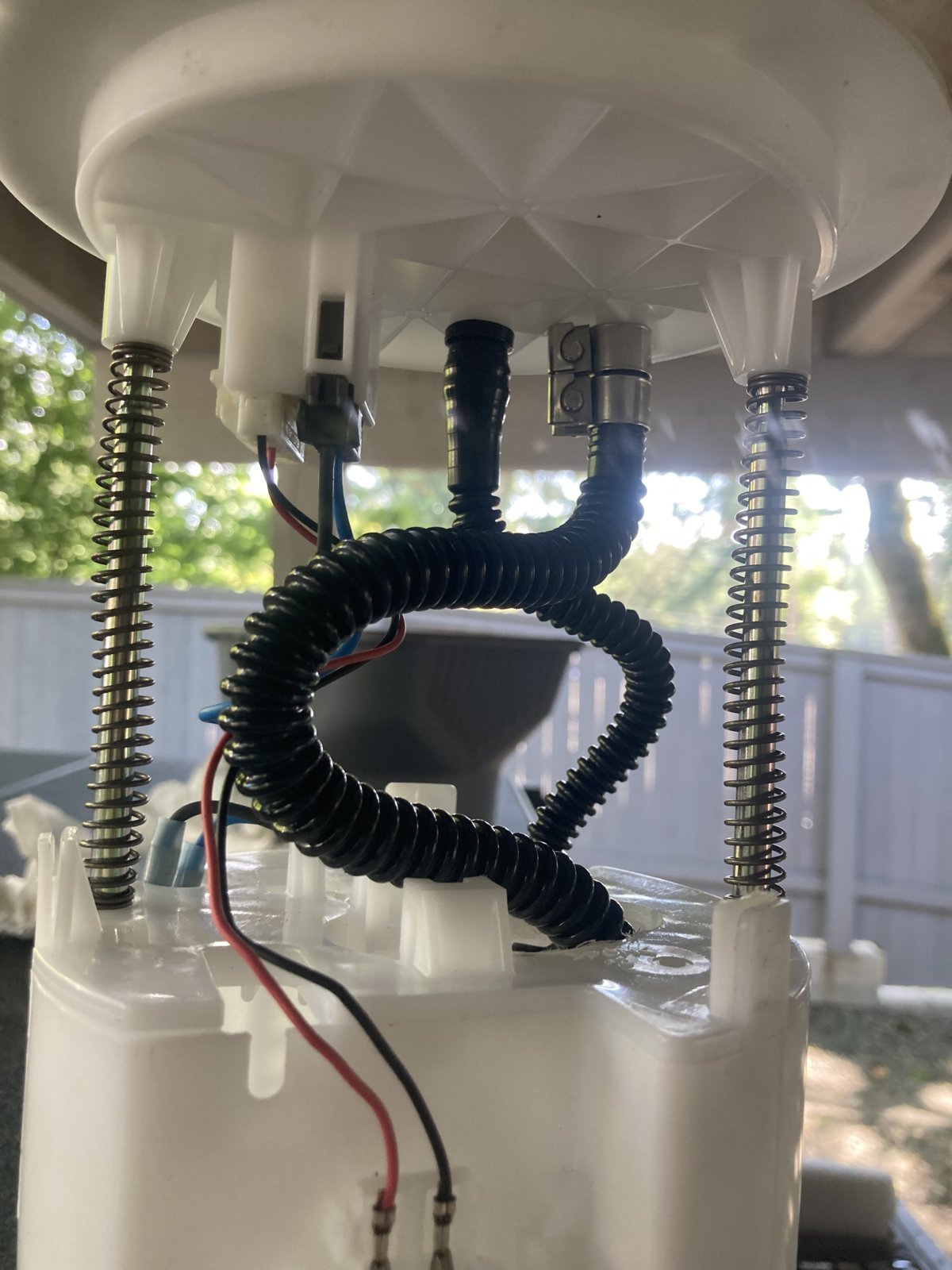

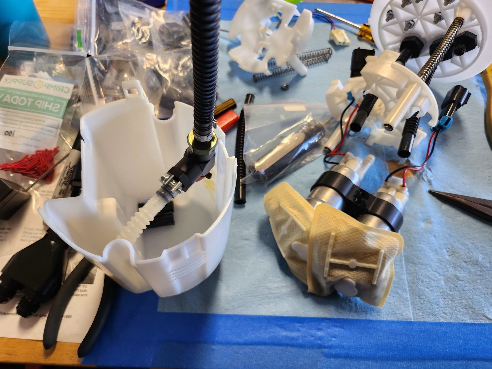

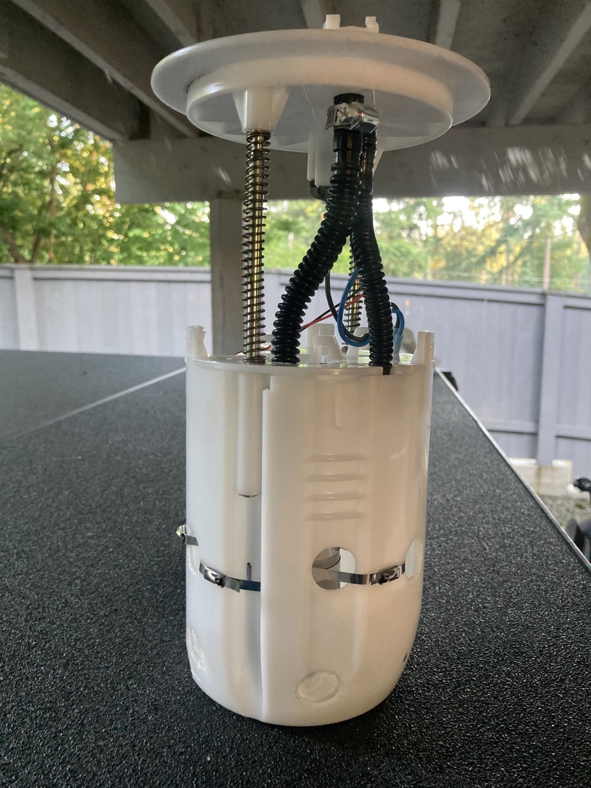

    Gotcha, fuel pump and hardwire in. Gonna install the fuel rails soon and fingers crossed no more fuel pressure loss

    Since you couldn't get the vsv relay to kick in high psi. You can try hot wiring the pump. You'll give it the full 14.2 or so volts.

    I bought the DW hardwire kit, wiring it straight to my battery!

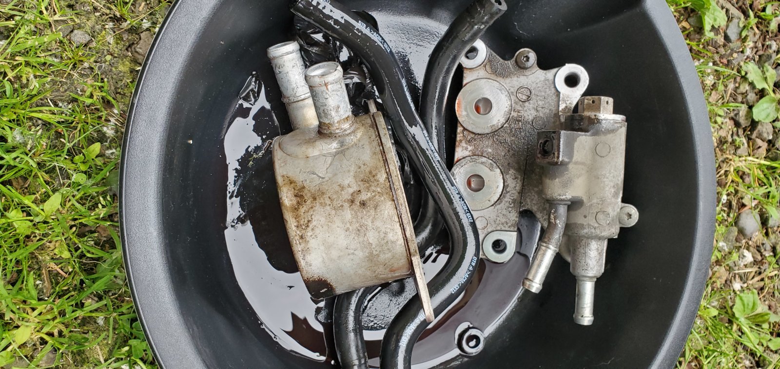

    Decided to do my trans fluid a little early as I was being a bit rough on it lately. Not too bad.
    Was going to try havoline world atf but came across an ad for ws fluid at 1/2 off. Guy sold his tundra and had a case of ws fluid. So I grabbed that. Removed my trans thermo and coolant puck. Straight lined it. It was a slow day...

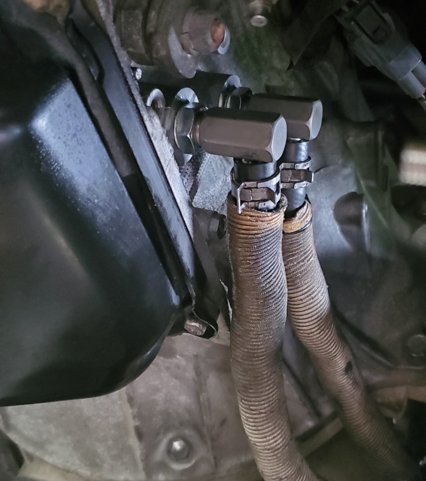

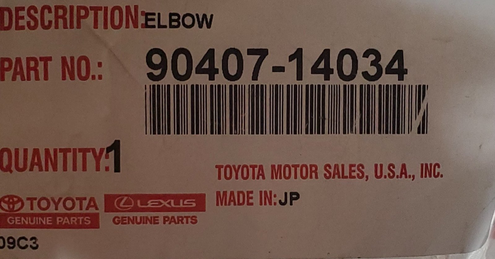

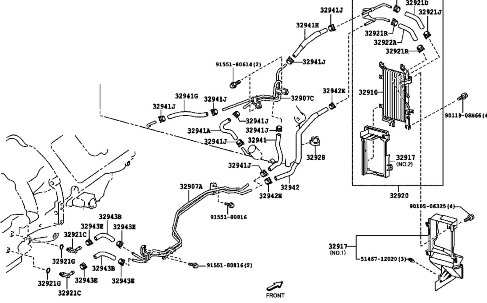

    What fittings are those in place of the puck? Where are the lines to the trans fluid cooler?
    Mdl likes this.

    They are elbows that John at ipt mentioned in a video. They don't come with o-rings but found some to fit. Just going straight to cooler and back. The coolant lines I removed and joined it with an 3/4 hose elbow.

    @armyoffoo. I used your idea with the Greddy thermostat on the Baxter performance adapter. I used a smaller filter to reduce the weight but it seems pretty stout. I don't have the mechanical fan to worry about the oil line placement. It opens fully at 176 deg. Seems ok for now. Thanks for the idea. I'll throw on the wix 51516 later.

    Tbd, still getting everything installed and will test. If it’s still losing pressure, I have no idea what else to do

    Well. You tested everything in order and as a last resort was dropping the tank and changing pump with it hard wired.
    This will do it! Sending positive vibes...

    Thanks. I forgot about ordering the o-rings. At first I thought it was a crush washer but nope...need those o-rings.
    Thanks for your help with the engine oil cooler ideas. I just went with the least expensive and easiest route. But if I do come across a RC F cooler...haha

    No problem. One of these days I’ll finish the oil cooler and write it up. What size lines did you run?

    10AN hose, .56 ID, and the cooler is open at 176 deg. I found that the stant coolant thermo pills will fit in if I need to increase the temp.
