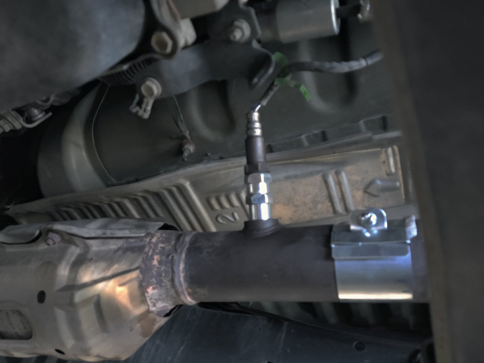

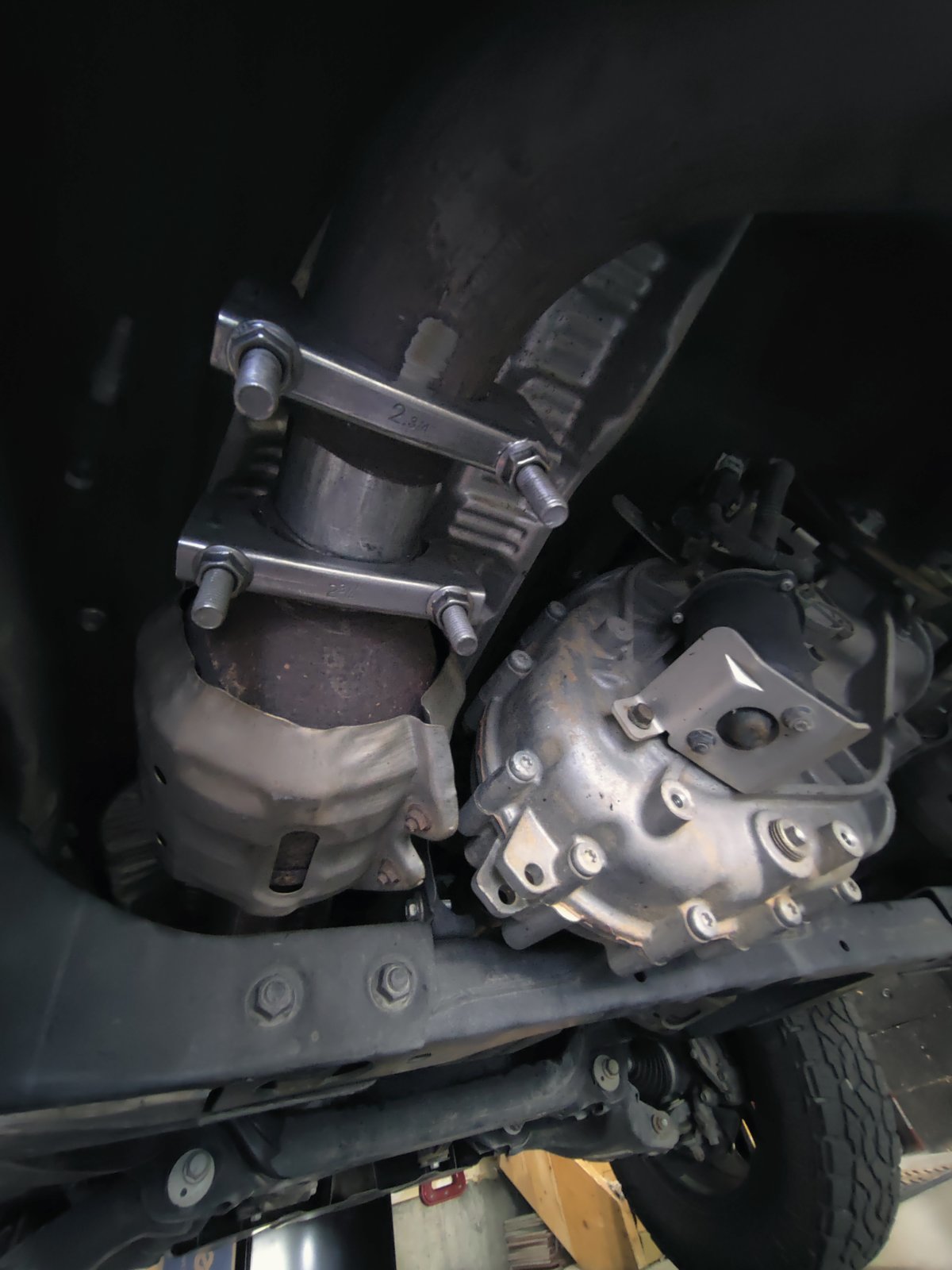

    Alright got the gutted front stockers back on up and running now to tune! Threw in the O2 spacers on rear and running the secondary cats. Just a FYI for anyone cutting the driver side DP. A 2" EMT conduit fits perfectly in the 2 3/4" stock pipes. Takes some finesse but it fits snug, enough for me to temp repair my driver side cut pipe. Slide it in and clamped both side shit is air tight. Good for anyone who decides to gut a stockers secondary cat for more flow.
