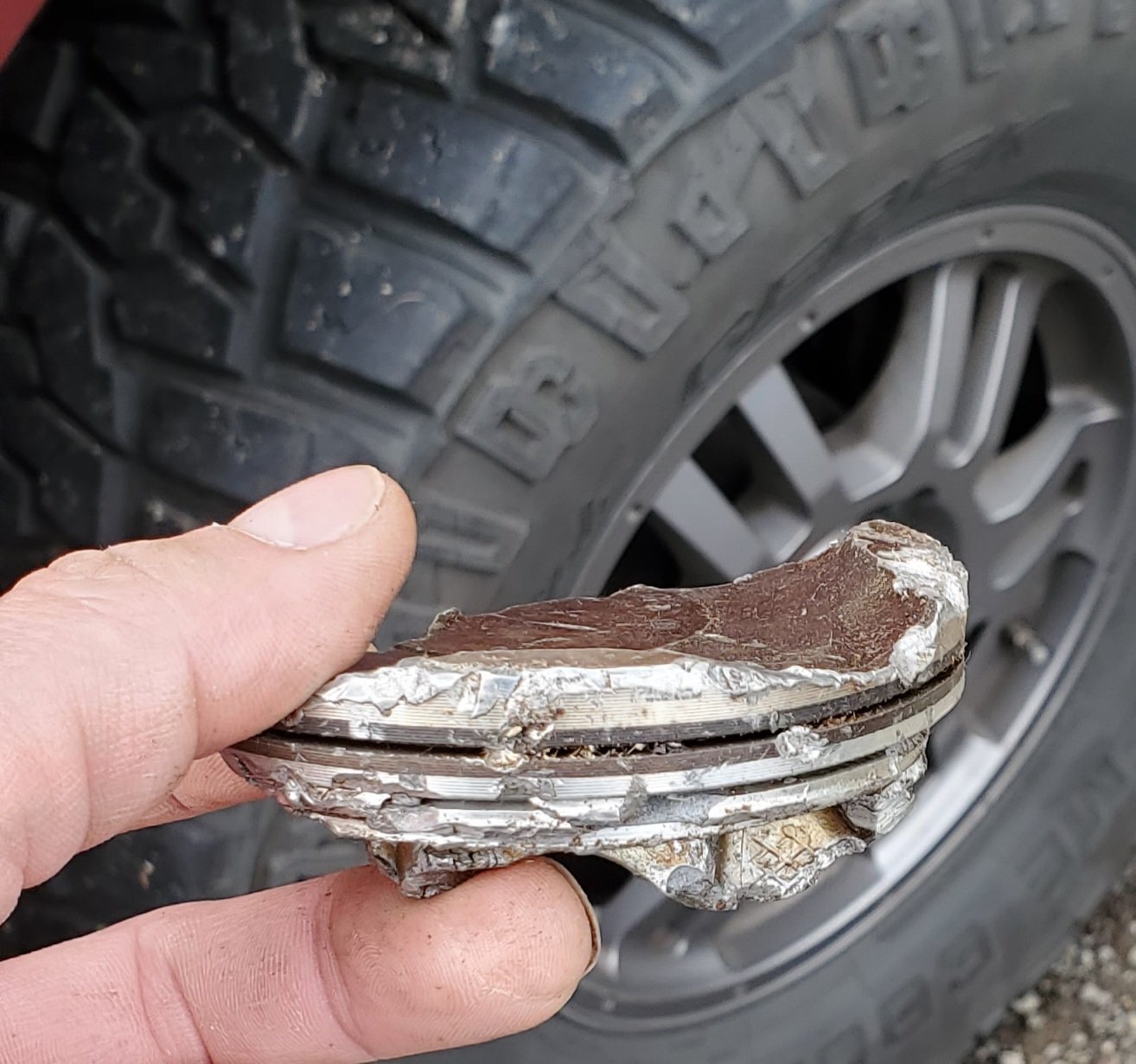

    Not to be a Debbie Downer...was going through an old tool box and found a "reminder" why we need to keep things in check.

    Geez Louise, it looks like that piston drug down the road while still dangling from the connecting rod.

    Nope just wedged in between crank webs...

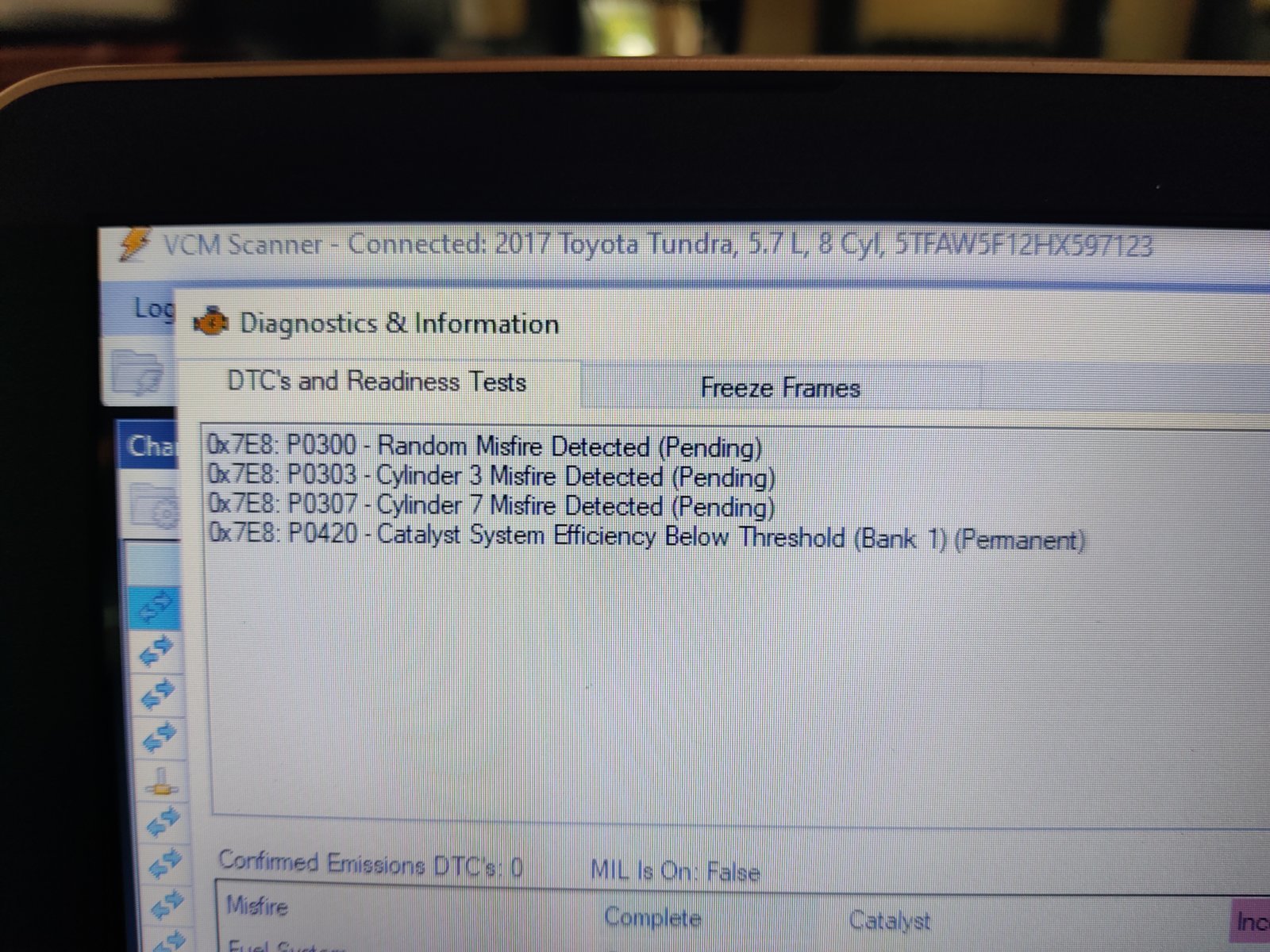

    Well shit looks like bank 1 cat is fucked. Misfires, lean up high, stumbling.... Looks like running rich kills these cats pretty quickly

    On some. Seems luck of the draw on getting ones to survive. Went with metal catalysts back in 2014. But I do have to run simulators.

    Looks like it happened just in time. There’s a group buy going on SPD midpipes with cats as well as their catback thanks to @reywcms I’m probably ordering some this week myself!

    Thanks for the info! Running DD from cats back just need the cats for now.....of course this happened right before I'm getting ready to camping lol

    That's what I figured, gut the rear test pipes change the cats and run some spacers
