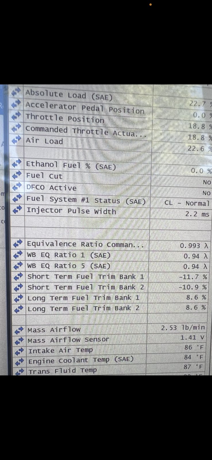

    First fill up after the non flex ecu.
    No ethanol.
