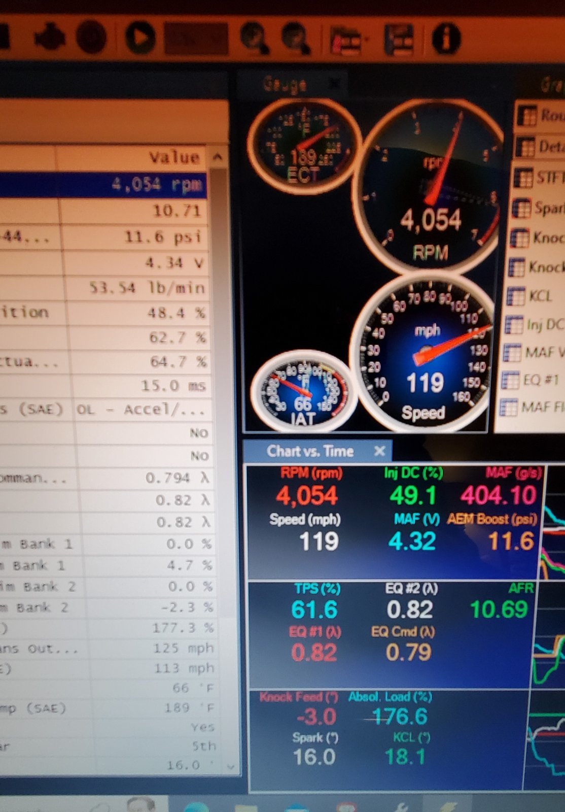

    Mdl Hey there...
    Jun 14, 2023
    #98638
    3,525

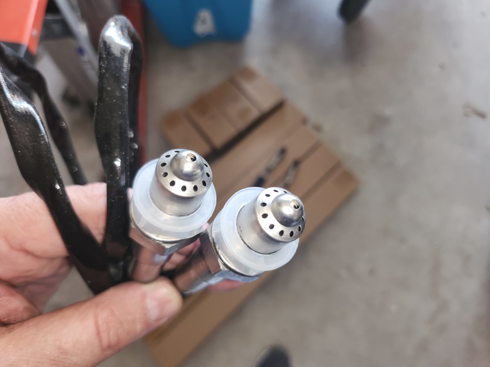

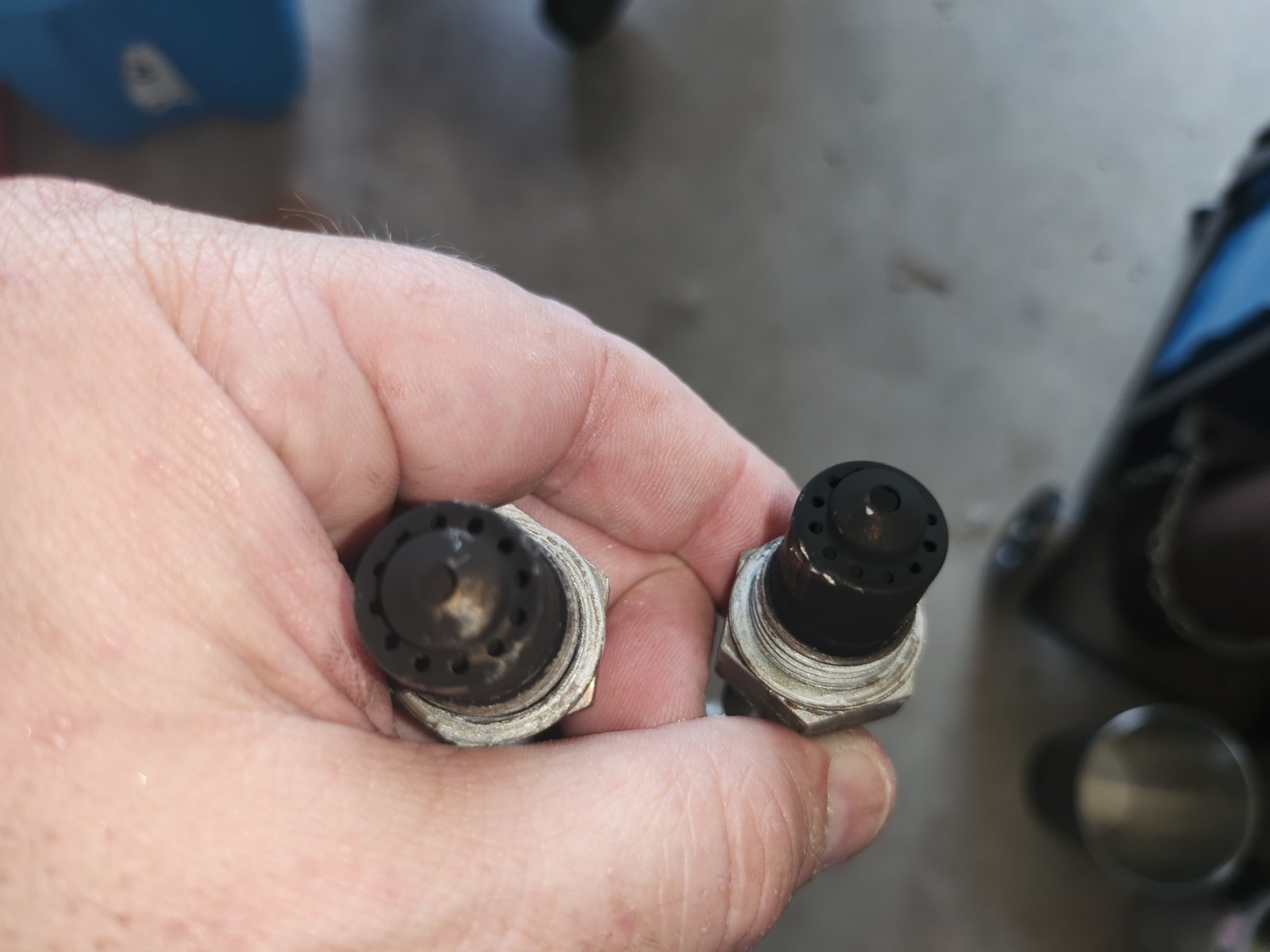

    Pretty sure the sensors were not the issue, but they were old, so I replaced them anyways. No change in wideband readings after replacing the sensors, and I was wrong about the narrow band, it is reporting as slightly richer on the same bank. If it's not raining I'm going to try swapping some injectors around this weekend to see if anything changes and check connections, hoses, etc.

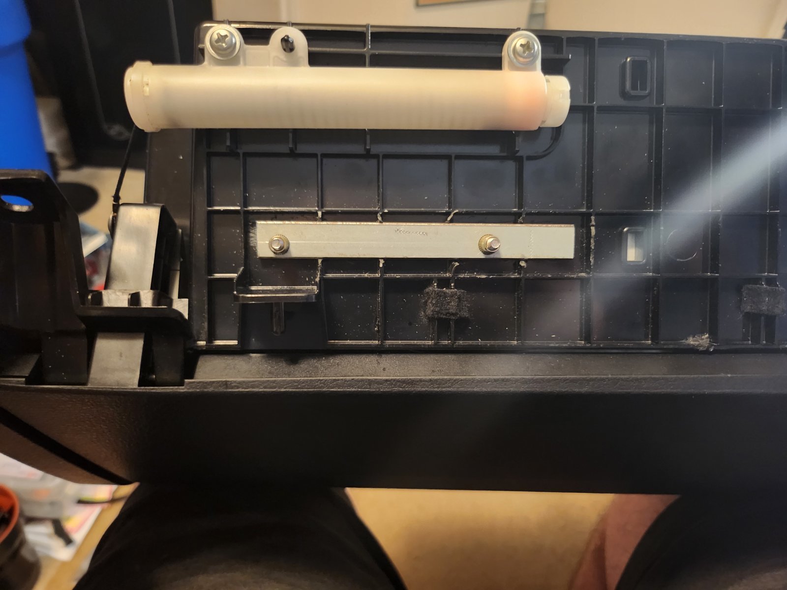

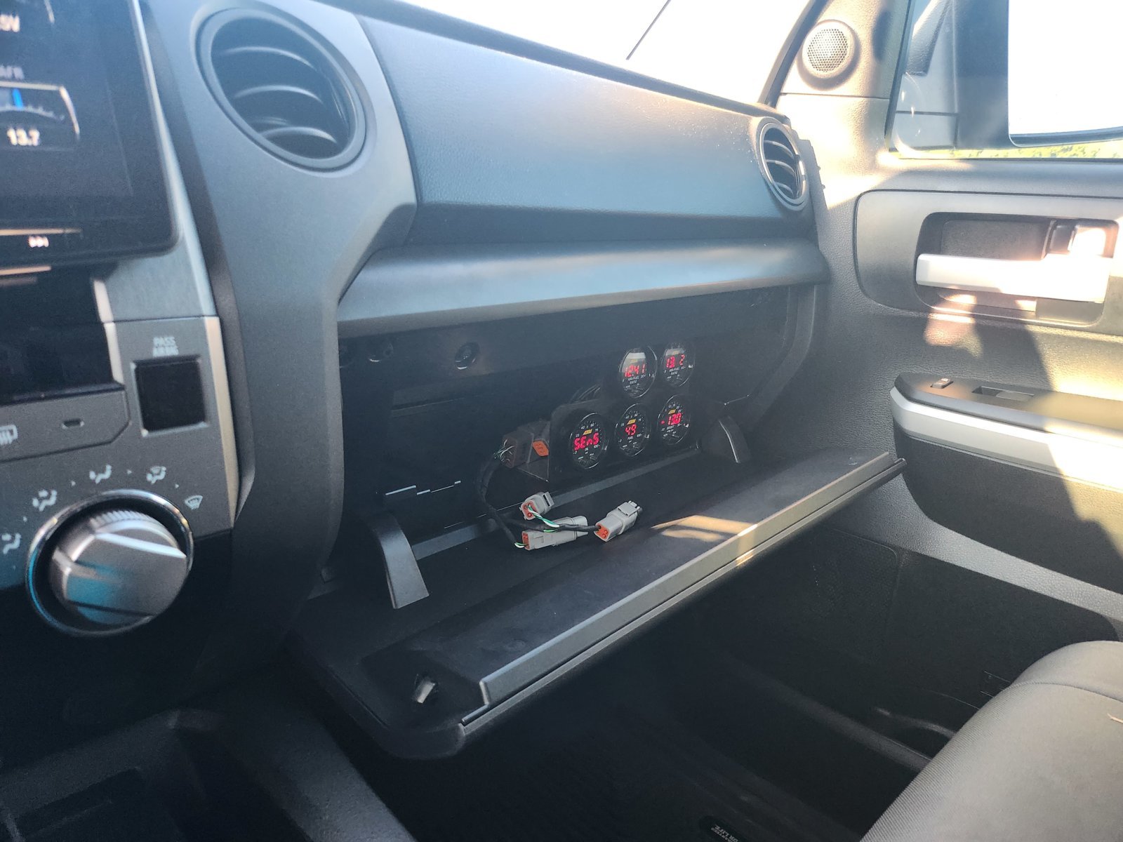

    Custom mounted mine in my glove box, not exactly easy to look at a glance, but I got them mainly for logging. They are "through" a piece of ABS that is riveted to aluminum angle that is secured with screws that go into nutserts under the glove box.
