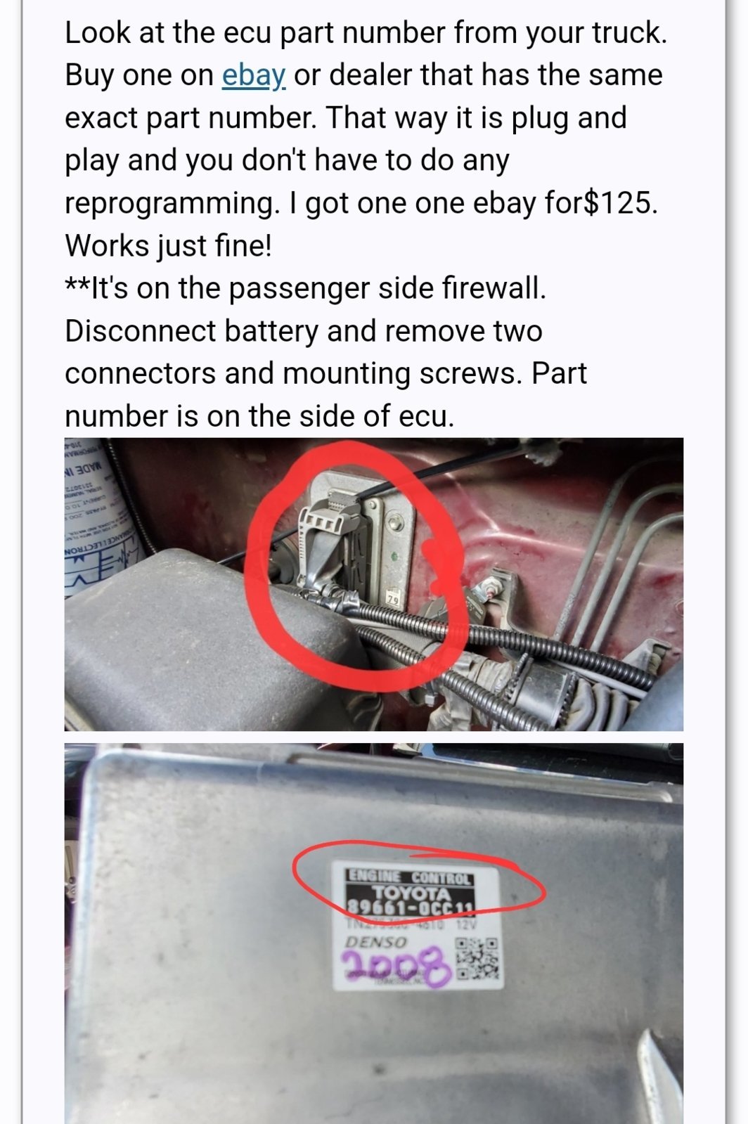

    Welp I can finally say I’ve become victim of a bricked ecu on my 2020 tundra using HPtuners for the first time. Didn’t want to have to make this post but not sure what to do at this point so I’m looking for help. I started working with @snivilous on the tune and went to flash it, got to about 35% complete and got a timed out error. Tried doing it again and no communication with the ecu. I used D3Performance before switching and had no issues flashing many times using their software. I even tried to use their recovery system but with no luck. @snivilous has also created a thread called “how to recover/replace ecu” as a few of us have had this happen. What are my options??

    Sorry that happened, I hope it is recoverable. I got exactly what I needed from this eBay seller, closest I saw was 2017 but maybe they have a '20
    https://www.ebay.com/str/ultimateautosolutions

    Well I had both versions installed on my laptop because I was having issues trying to read my stock file but I think when I opened up the file I was going to flash with, it may have opened with the beta version now that I’m thinking of it. Not sure if that was the cause or not
    Mdl likes this.

    You had swapped over from a flex to a non flex ecu. How was that process? Did you end up buying the same MY ecu as yours or was there a range you could go by. I’d assume I can’t go any lower than a 2020 because of the changes they made.

    Have you tried non beta version. Is your ignition fuse blown? Did you pull intercooler fuse? Use battery charger? Check all ignition and ecu related fuses.

    I only checked the 20A ecu fuse not the ignition fuse. I also tried to see if the non beta version would make a difference and it did not. I will be deleting that one just in case that was the issue and only using the stable release.

    Hpt will ask you to try to write with beta version. Check fuses. Strong internet link. They even recommended using a better USB cable.
    We're you able to reload the original tune. Back to stock?

    When I emailed them about mine bricking they basically said "guess you need a new ecu then"

    They take the whole "brickable" seriously, profit over liability. Sometimes you get a tech who will try to help.

    I tried in the beginning when all this happened but gave up as it was getting late. I’m going to try the resistor mod when I get home from work this afternoon and hope that works. If not I’ll find the part number and buy a used one.
