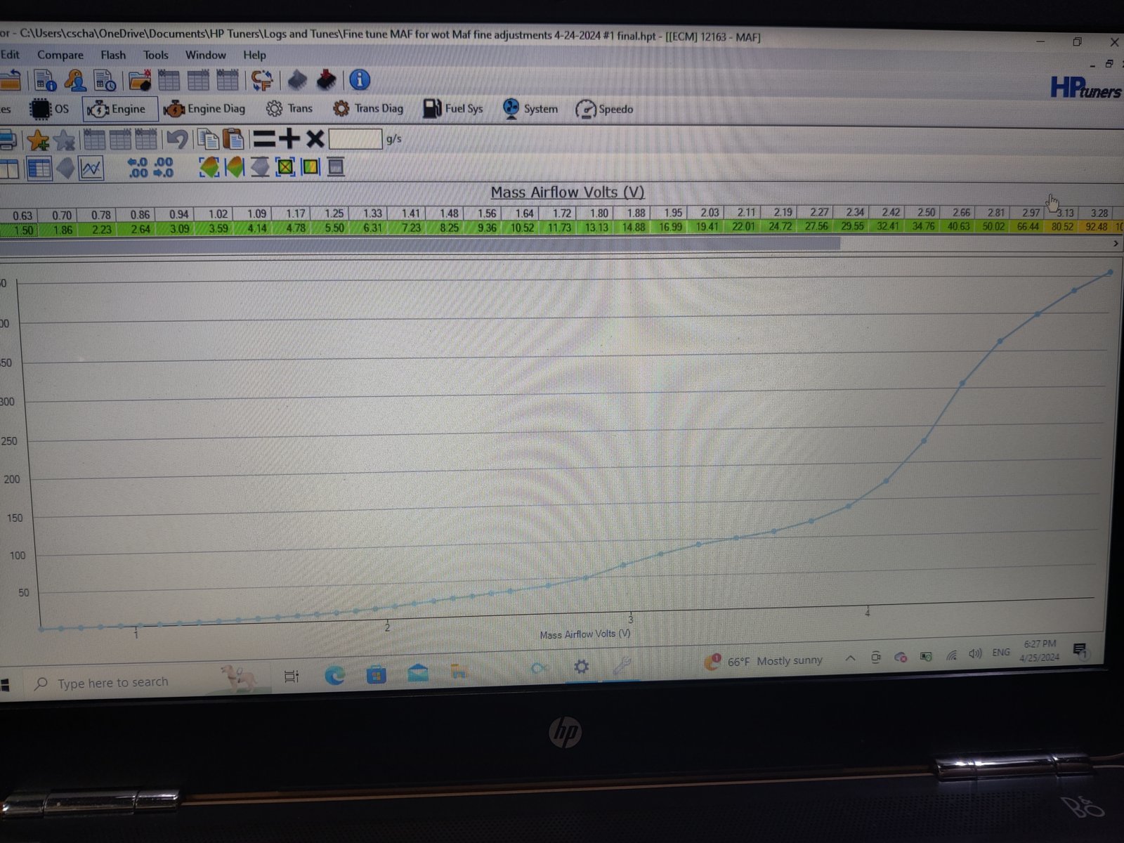

    Idk what the fuk is going on then:notsure: Parameters in logs are great hit peak of 10ish psi but DC in 80s in 10's I give up lol. Is this spraying meth?

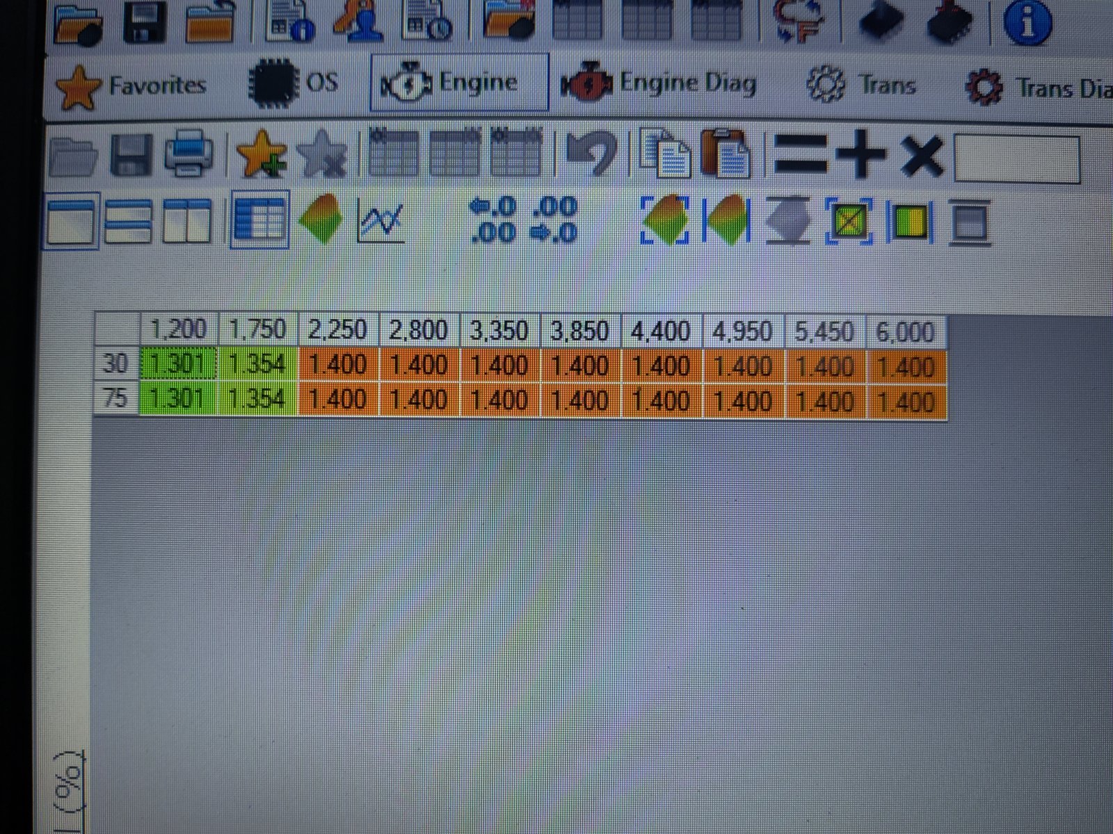

    Have you tried pulling fuel in the MAF table? I have my PE at 1.4 almost across the board targeting 10.44 with A/F almost dead nuts commanded. I just add/take a few percent at MAF Volts. Seems to keep A/F pretty consistent.
    At same time my MAF curve looks funky but I believe it's the initial surge and then leveling out once boost is built.....I think lol

    I was thinking that I'd try pulling it from PE first and if the adjustments are to coarse, then work on the MAF table. My PE values are very low, I can't look at them atm as I don't have access to my truck which has my cord/MPVI2+ in it.

    Understood. I tried PE but with boost reference I was having a hard time with A/F. Then again I'm the only dumbass with 750s hitting such high DC so who knows

    That is true. When I dropped from 5k to 3k elevation I had to richen up PE. That's when I decided to flatline PE and mess with MAF instead. Last fishing trip went from Denver to Deckers and A/F did not stray thank god
