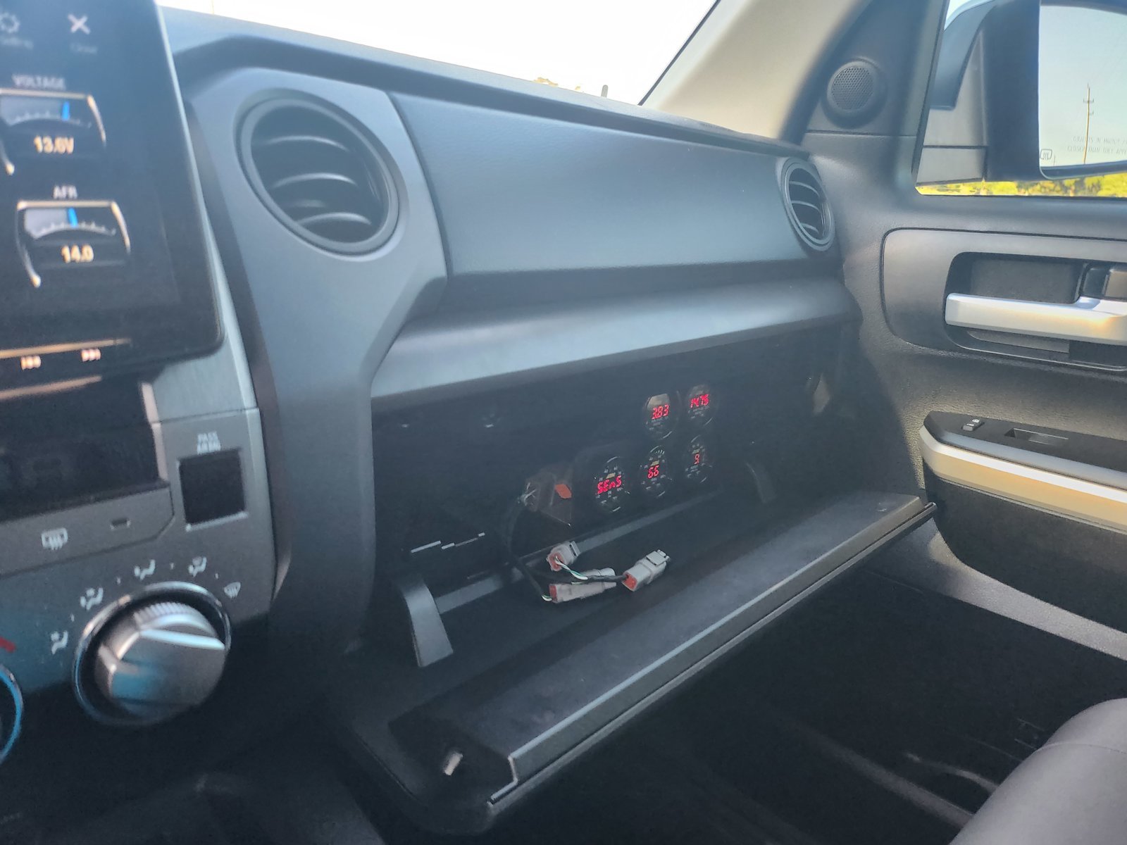

    What's the AFR gauge read? Does it ever richen out?

    It's at 13-14 on both sides, didn't see it get richer so I got out of it, but before I had the gauges I hooned it all the time, so this is scary. BTW, I'll be getting your tune flashed and datalogged today now that I'm finally setup.

    Pull up the stock narrowbands as a check for the widebands. The narrowbands will go down to 12:1, so if they're reading full rich and the widebands haven't moved then the widebands are wrong.

    The stock AFR is showing 14 at the same time, according to my headunit's display. I managed to get it in the picture, top left.

    Something is majorly up then. Also I would expect the wideband and narrowband to be much closer than 0.75 off from each other. Mine are usually within 0.2 at most.
    If you flash the tune I sent you at least you'll have an A and B comparison, the one I sent you richens out at 35deg throttle angle. If it's still behaving the same after that tune then something really weird is happening.

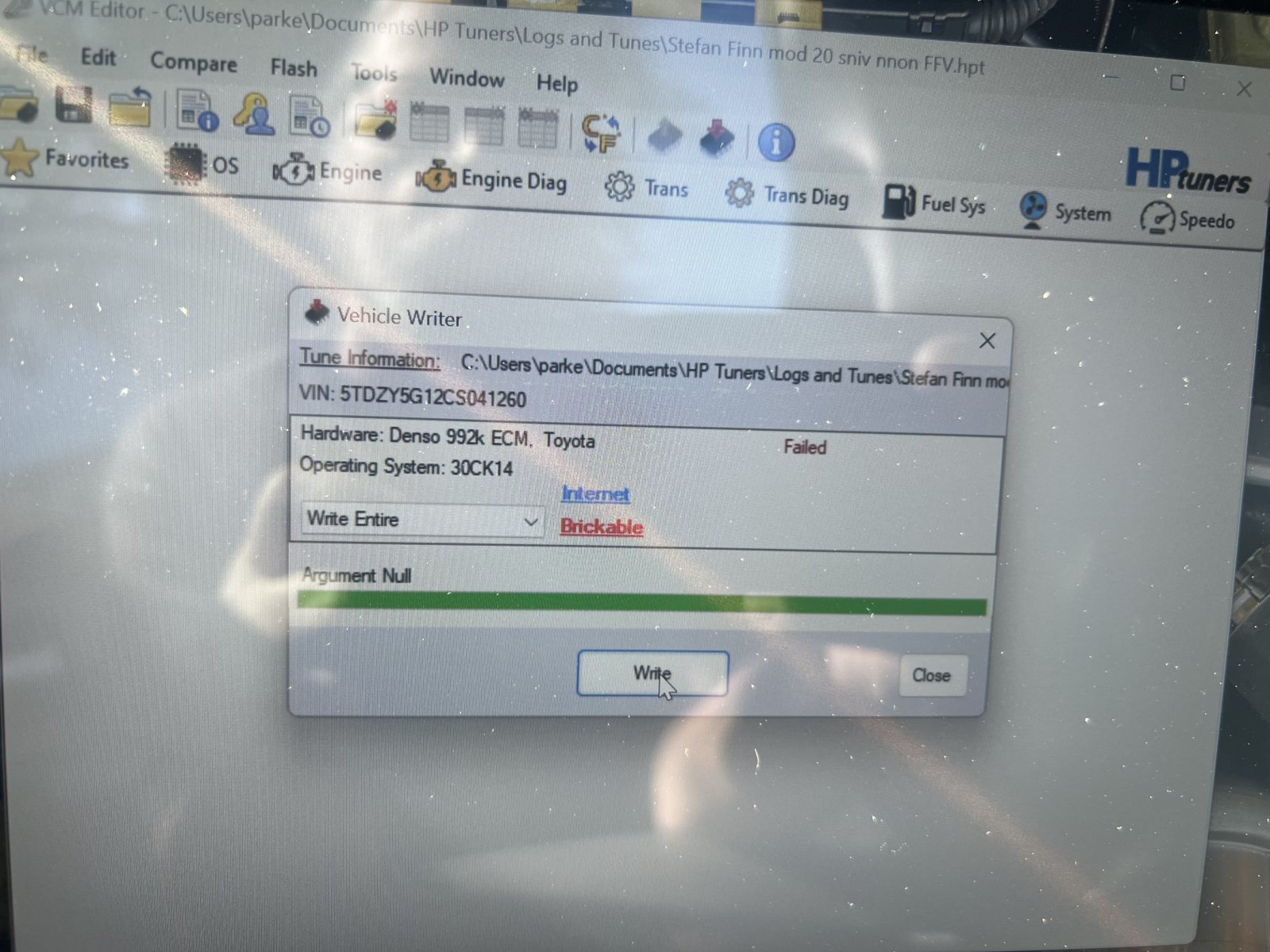

    First I need to thank everyone that helped, you guys rock!
    Here is some oddness, when I first got the Non Flex ECU in, I flashed the last file I had from Sniv no problem & after the R&R it works great, he just sent a file based on the read & it fails to load. He made a new file based on his last file for the flex, removing all the flex junk & it wrote no problem.
    Here's the error that freaked me out!
    WTF???

    I got that once but I realized I didn't put my ignition fuse back in. Then it wrote fine. Another happened when I lost internet connection right when it was about to write.
    I had a hotspot timer on and didnt disable it.

    No. That it says "Argument Null". Meaning there's no connection to ecu or unable to write to it.

    I didn't do anything. But I'm confused, and maybe @ViktorG can answer this.
    e30 puts in a new ECM. The new one can get flashed with the tune from the previous ECM. But the "stock" file that HP Tuners downloads for the new ECM is different (as expected). The new ECM file doesn't have the flex fuel tables for example, and the calibration number is different and the VIN listed is different. But that file cannot be flashed onto the ECM. Only the previous file from the flex fuel ECM can be flashed onto the new non-flex fuel ECM.
    At the end of the day, as long as ethanol content doesn't come back, who cares. But it doesn't make sense to me. And say another tuner comes along and grabs the stock file from the ECM that HP Tuners downloads, well that file can't be flashed onto the ECM and just errors out. So now we need to always have the original ECMs file to use, but there's no way to actually get that besides already having it on hand... I'm lost.
