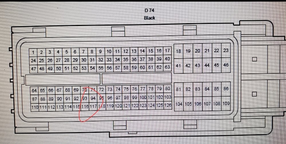

    Pins 94, red wire and 93 green wire sensor 1.
    Pins 117 white wire and 116 black wire sensor 2 bank 1.
    Edit: just realized i looked on the 2010 diagram.

    Yeah and the d53 module has the grounds.

    Battery is sitting disconnected for the night, I really hope it isn't the sensors, they are expensive & a pita to get to.

    Thanks. I wouldn't think it be both sensors on bank 1 most likely at the ecu. Really only place that was touched was at the ecu plug.

    The codes are contradictory. O33D is no signal and 0228 is high signal.
    Wtf?
    Lol
    I'll pull the compressor out and check the connection after looking everywhere I can and sending Sniv a log.
