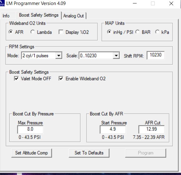

    Added money to it.
    Yes ok, so I went to best buy and bought the adapter so I could plug my laptop into the gauge. upload_2022-2-20_19-20-50.jpg
    The Boost cut pressure was at 8 which makes sense because when I specifically paid attention today I saw the "B cut" pop up when my boost PSI hit 8 or above. So it appears it's 8 PSI by default. BUT My gauge still said the peak PSI was 10.7. I did really notice it suck the power out of the truck when WOT that time. But the manual say's "the relay will interrupt all solenoid control and boost will default to spring pressure."

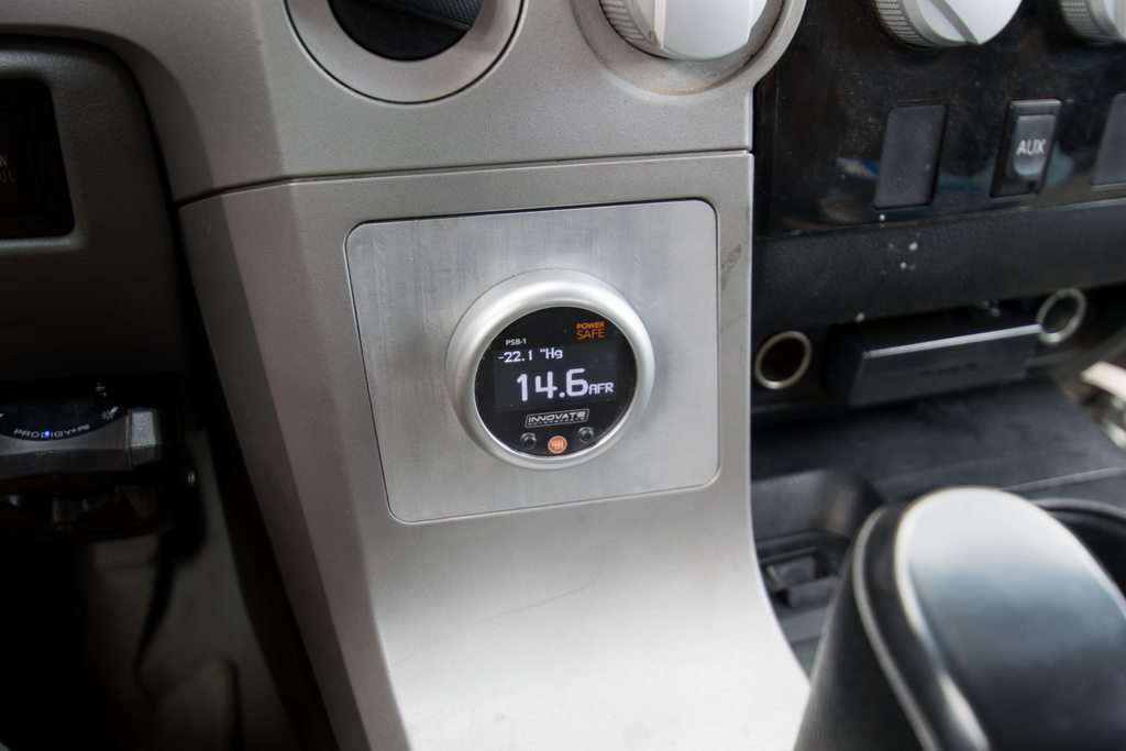

    Yes sir. I got the boost/AFR when I installed the blower a few years ago, never had a single issue and I suggest it to everyone. As far as I know it's the only gauge that does dual duty of showing AFR and boost pressure, which is why I got it. You can see peak boost, and a combination or single display of boost and AFR and it has little buttons to quickly switch between the displays. Its backlit and plenty bright during the day and you can tie it into your running lights so it dims. It's not cheap, but it seems to be really good quality and doesn't look like some janky aftermarket gauge. The only thing that could be "better" is since it's digital it's measuring everything at intervals, so reading boost for instance it could be jumping from 4.5-5.5psi in decimal increments hopping around depending on what the instantaneous reading is (same with afr), where as an analog boost gauge would be locked in at 5psi since it's more of averaging the data and has inertia so can't be instantly hopping around. Nothing wrong with it, just how the data is being read, but worth noting (I bought an analog gauge just to verify the Innov8 since the boost numbers jumping around slightly concerned me the first time).

    He convinced me to get the same gauge. I've had zero issues with and am very happy with it.

    How easy/hard was the install?

    I struggled just a bit with getting the wideband sensor wire through the firewall grommet due to all the other things I have stuffed through there. :(:D

    Does spring pressure apply with superchargers?

    No none of that applies to us, plus you'd need the gauge hooked into some auxillary system to have anything happen. I'm not sure what the end of dudes post was referring to.

    I didn’t know what that meant. I was just quoting what it said in the manual. So it really has no affect then? It’s basically just indicating it’s past 8PSI essentially?

    Correct, it's just a warning

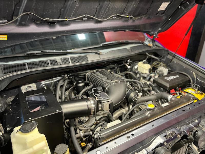

    Almost ready to join this post. Although not entirely sure what stage 1 specifies...

    Stage 1 is Harrop with no tune and the larger pulley and stock injectors.
    Post what you got. It doesn't matter as most of the people on this thread upgraded their S/C to the Stage 2. People are posting their Maggies here too.

    Got the Harrop, obviously, 80mm pulley. Full ProSpeed fuel system including billet fuel rails, ProSpeed Intake and will be fully tuned with HP Tuners
